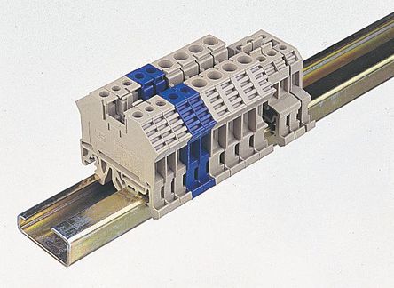

Or variations on crimp (crimp, crimped, crimps, crimping, ratchet), as the debate usually ends up with some people saying you mustn't use JBs, and that proper ratcheted crimps are the only answer, and then other people wonder if crimps are really suitable for solid core cables, and then I propose Plan C which is to use DIN rail mounted through-terminals enclosed in an adaptable box:
