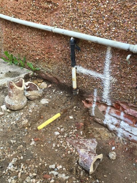

Hey guys.
Liking at the below photo, does anyone know if I would be able to get it moved.
I would like it to not come up the wall, and as I'm breaking in under ground for the drainage, I wonder if it would be possible to take the gas in through there too and bring it up inside?
I've already exposed quite a bit of it, it's a metallic pipe, so I'm curious... How would they cut it to divert?
I understand it's a gas networks job, but just looking at ideas at the mo.
Any idea would be great!
Cheers
you wont be able to have the gas service supply taken under your building and come up inside , your only option is an external meter box, this can be ground or wall mounted but you cant have below ground service supply pipes under your building any more
That's a bugger then!
My aim was to clean the hole wall up with nothing on it.
Looks like I'll just have to tidy it up somehow, as currently has tape peeling off.
Cheers.
