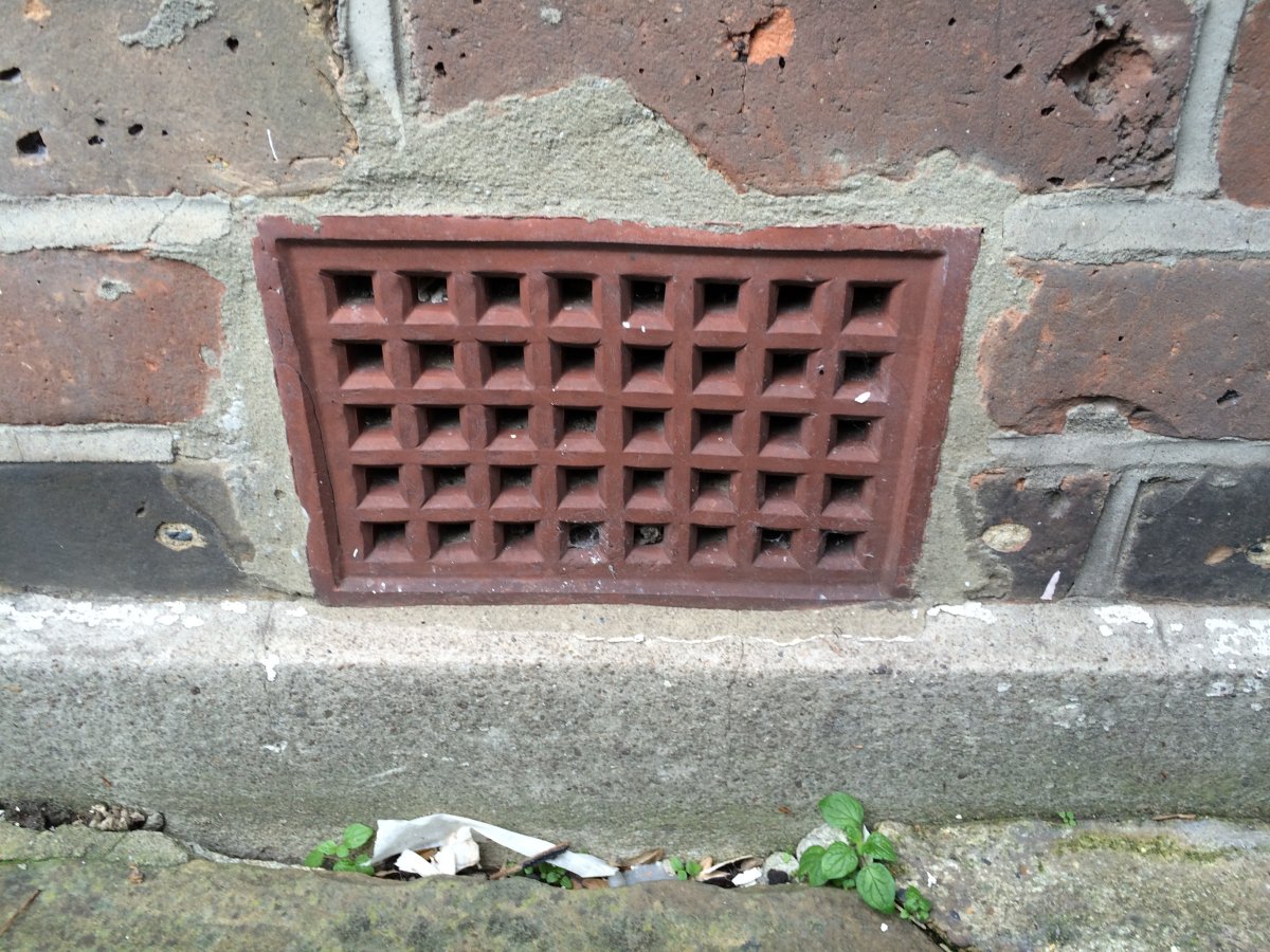

Hi
I have two 'real coal' effect gas fires and I'd like the taps and pipes moved so they're not on show. Are you allowed to have the tap under the floor with a small access panel above it? I'm not going to do the job myself but I'd like to think about it before I call someone out.
Also, one of the fires doesn't have a pilot light which I think isn't allowed now. Will the gas fitter refuse to work on it? Thanks.

I don't actually want anything doing to the fire itself, I was just hoping he could put an elbow joint in the supply pipe and conceal the tap (although I can see why the might still stop him) . There's an air brick in the room. Thanks for the reply.

Thanks. I had a Gas Safe Installer out who thinks the taps have to be above the floor. He mostly works on boilers so he's gone to read up on the regs.
He also mentioned the ventilation. I don't have the manufacturers instructions but I called them and they told me that if it was 6.9 kW or above it would need a vent. The plate says 6.2 kW.
I can't get to the plate on the other but in the room I have an air brick which is 22cm X 15cm. I've read that 100cm2 of free air is required so do you think that type of brick is enough? (Photo below).
If not, there is an archway into the kitchen (no doorway) so does that count as the same internal space? It would be easier to add another vent there than make the existing one bigger. There's also an open plan staircase over 3 floors. Could I vent the loft door if there's a vented roof tile?
I've also read about adventitious air reducing the requirement. The room is 32m2, straight off the street, and without any doorways heat is escaping all over the house - hence why I got the fire in the first place.

no that airbrick you have is probably around 40% of what you require it needs a proper gas vent which fits same size opening
So would my kitchen be a suitable place for it given that there's no doorway between the rooms, just an arch? Thanks.
Why put in another hole when you can use the existing one ?
Because I'd rather not knock out what's there but I could either convert a cat flap or cut a hole in a UPVC panel in the kitchen. Both would be easier and if I have to have a plastic vent I'd rather it was at the back of the house.

If it is an inset tray type fire (DGF), and no MI's, the default position will be that it needs 100 cm.
The valve obviously has to be accessible, so under the floor would be unlikely to comply. But on most jobs the valve could go under the fire.
