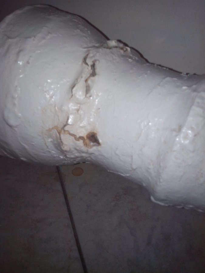

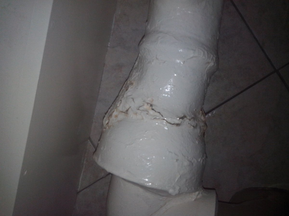

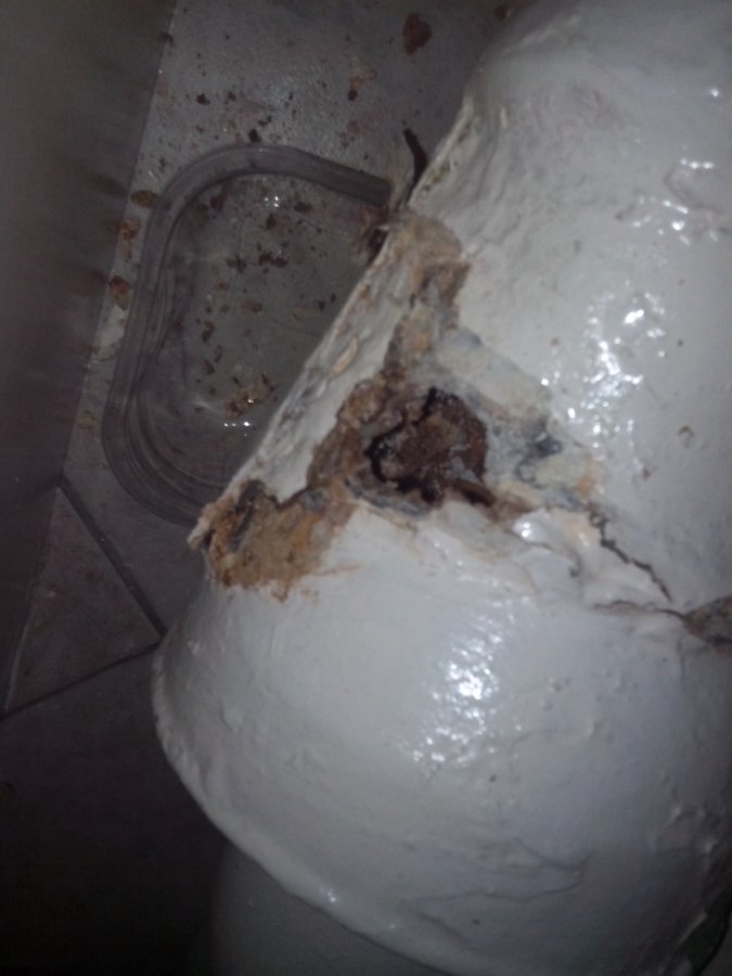

Hi guys.
I am having a look at sorting this toilet waste.

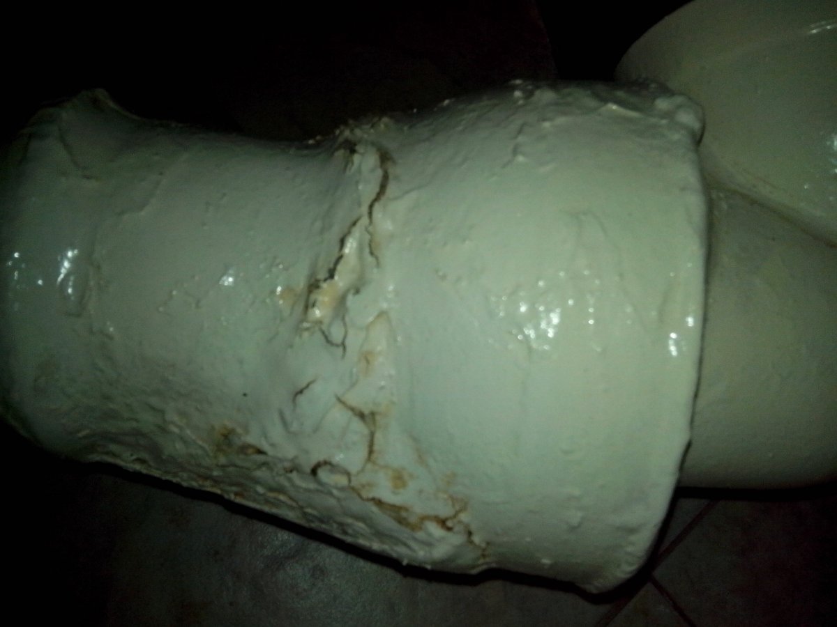

The angle coming from the toilet is plastic, the pipe connecting to it is iron.
Various patching jobs have been carried out over the years, I think covering the areas with putty or filler of some kind (not a good job) - whatever is there is now crumbling away.
What should I do first ?

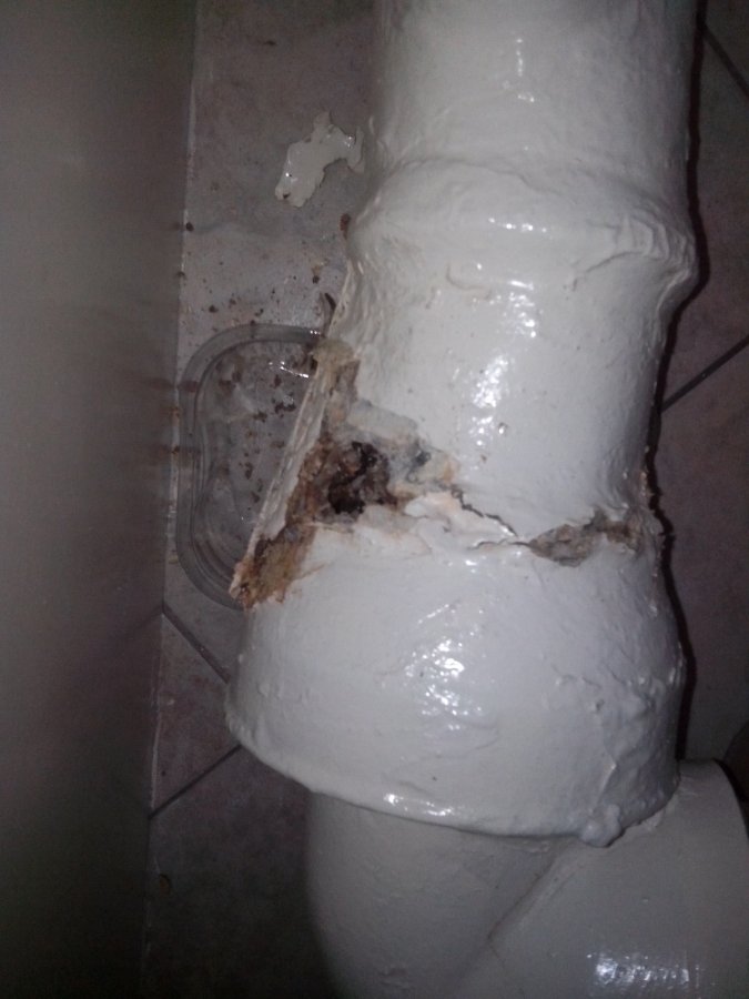

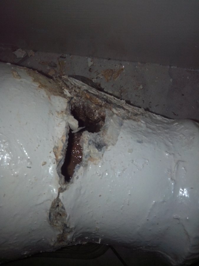

Scraped off a little bit and basically there's a hole being covered with what looks like silicone.
The pipe looks to be completely eroded -- is this iron ???

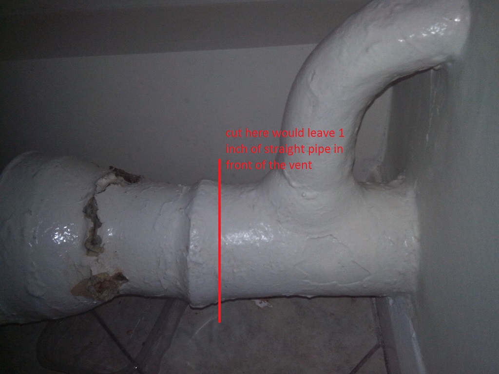

Just to give an idea what's going on.. if I cut through the pipe further back and fitted a plastic waste it doesn't look like I'll have enough space to fit a collar or anything much of that nature.. any ideas ?
That's a lead soil pipe with a vent coming off it - any chance of a pic outside to see what it goes into

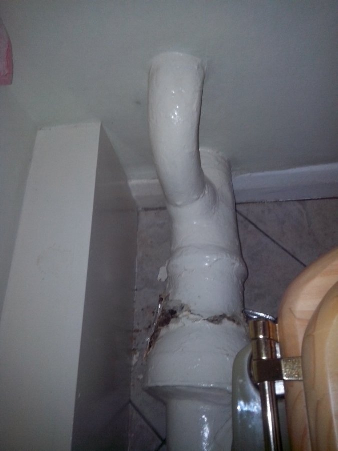

The vent pipe goes up the outside of the wall. The soil pipe goes straight into the stack. Ground floor flat. What you thinking ?
I was thinking worst case scenario if more of the lead is perished - take it all out through the wall and join into the (presumably iron ) stack. Ground floor is good in that scenario. So first idea is to clean off paint from soilpipe in front of the vent - measure the OD of pipe - see if you can get a Multikwik connector to fit into the ID of the pipe allowing for a 2 to 3mm wall thickness. 2nd idea see if a Fernco type banded connector will fit over the pipe and convert to 110mm plastic. The lead can be cut with a throw away carpenter's woodsaw (quicker and more accurate than a hacksaw) Just behind the belled out bit leaving a stub in front of the vent.

I think you need to get a plumber in to investigate exactly what that pipe is, or get some of that paint off to understand what materials you have. By it's shape the primary pipe looks like it might be a saltglazed clay pipe with a secondary vent and connection in lead as @Nige F mentions.
Once materials are known then it may be possible to use an angle grinder and carefully cut out the clay at the damaged section and remake with new pipe.

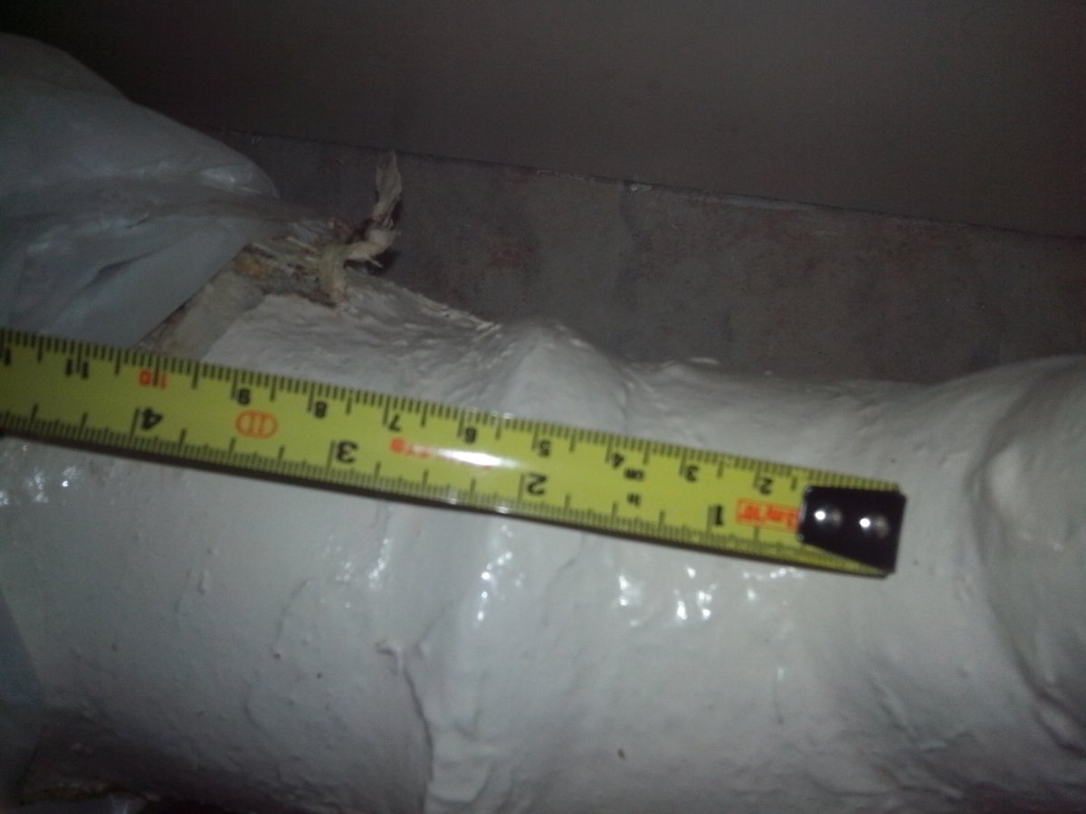

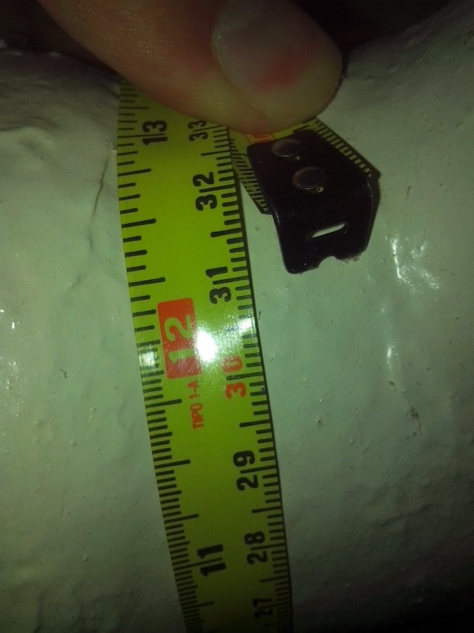

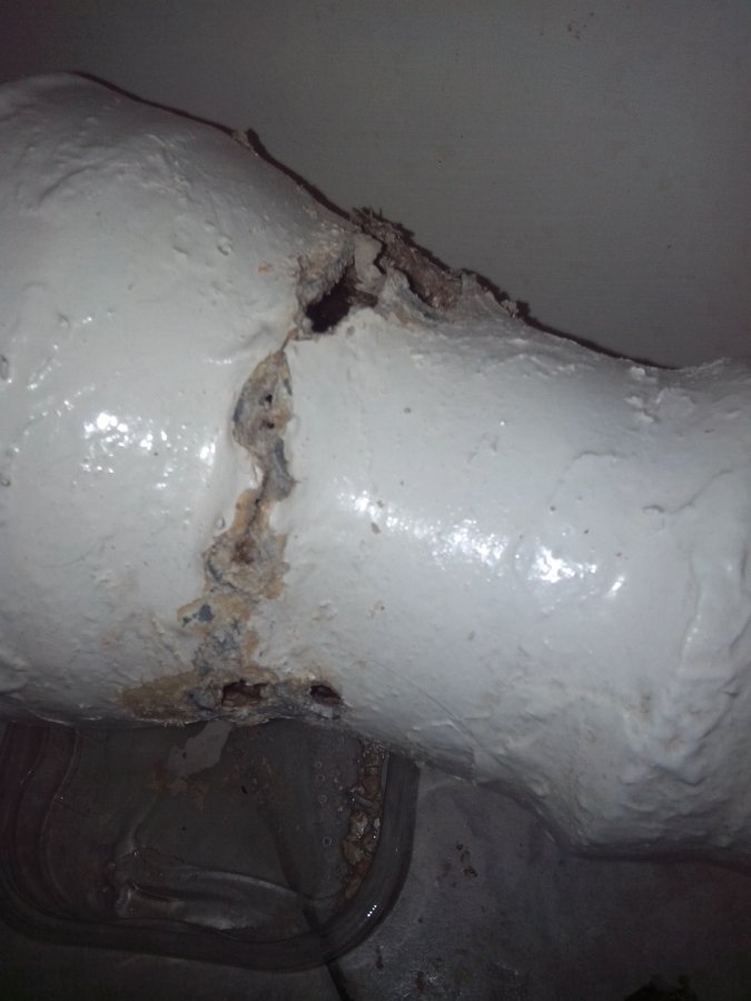

So I took this just in front of the vent where the paint is thinnest.. 310mm
I've got 1 inch of pipe at best if the cut is made there, is this enough to fit a fernco type banded connector ?
Of what's available : https://www.fernco.com/plumbing/flexible-couplings
I was looking at these, the 1056 series :
https://www.fernco.com/plumbing/flexible-couplings/stock-couplings#tid-186
So 310/3.14 = 98mm let's say 100mm OD I need
This one ? https://www.fernco.com/dimensional-drawings/plumbing/flexible-couplings/stock-couplings-1056/1056-44
Trouble is that it's 4 inches deep so I need at least 2inches of pipe either end to slot into it ?????????????

I'm going to start scraping away the paint today
Yep, I'm always surprised sometimes by some of the materials they used to use, clay/lead/iron. Depending on what materials they are, determines the best course of action.
You want the diameters too, that'll determine what modern alternatives you can use. Fernco are real handy when it comes to doing a repair if that's what you wish to do but you need to make sure the butt points of the repair are as tight together as possible to avoid dips or shelves for material to be caught on/ build up on.
The ideal would be to see if the run to the stack could be replaced but that's quite a bit of work.

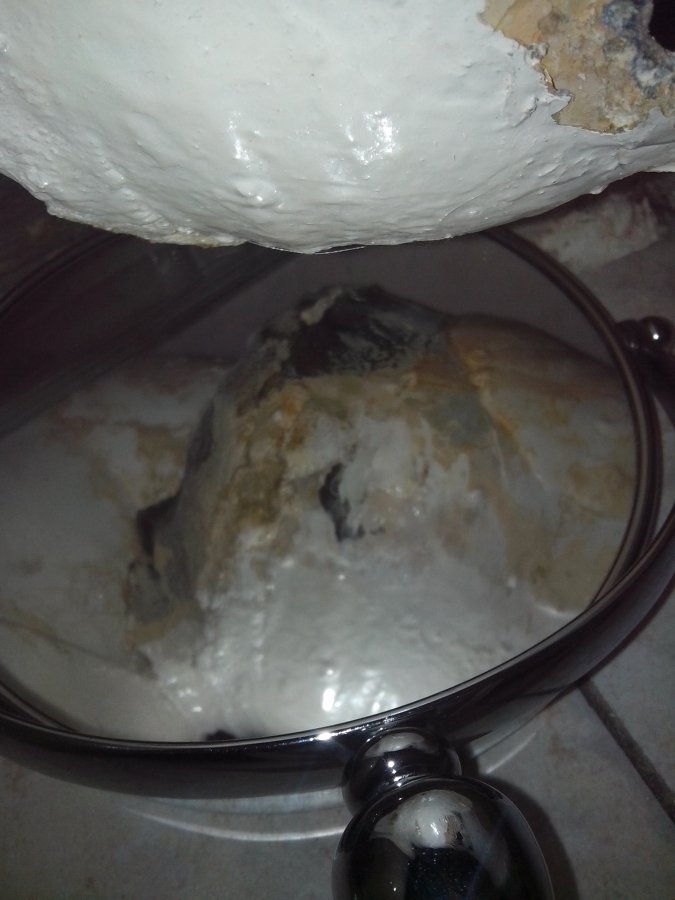

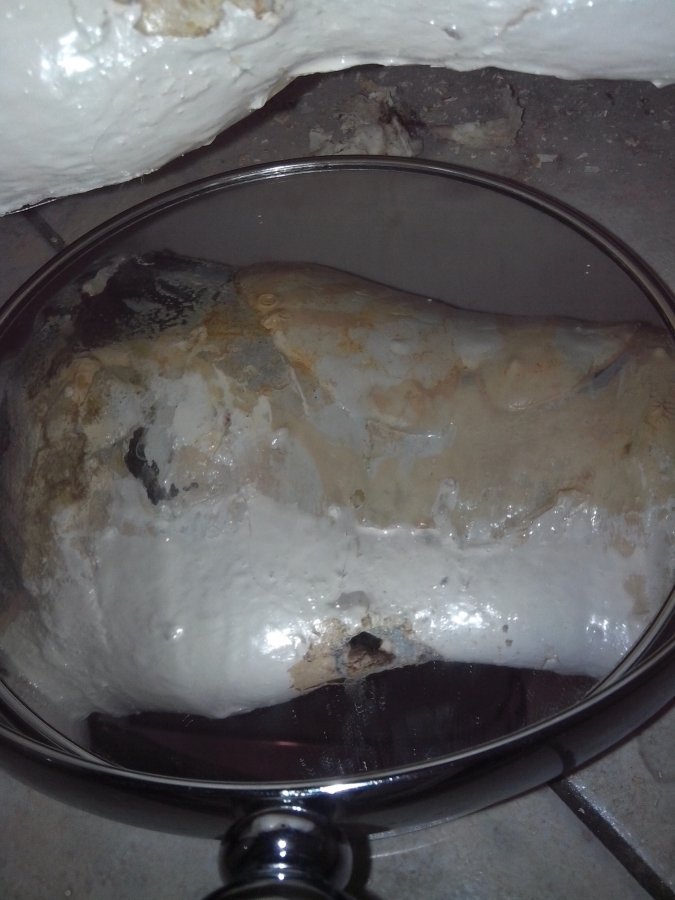

It gets worse. Put a mirror to see the underside of the pipe and it looks like it's been patched up so the lead could be missing entirely ???? Toilet fitted by fred flintstone ?
