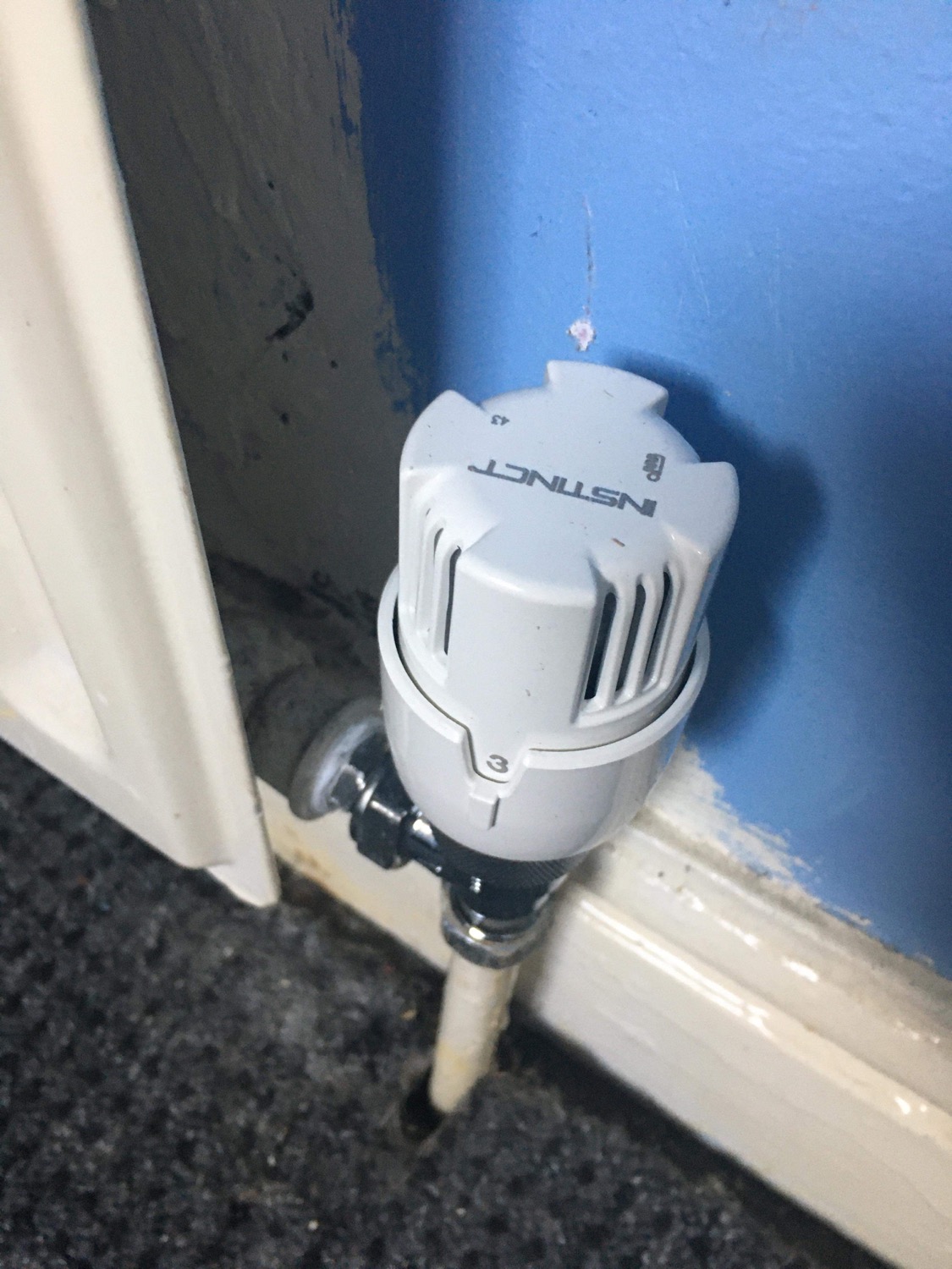

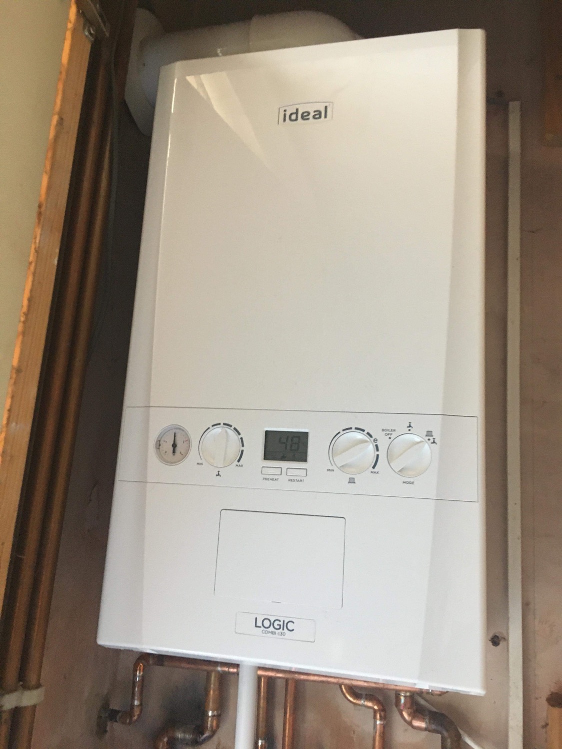

Hi I have just had a Ideal logic c 30 Combi boiler fitted and I’m having an issue with the radiators going cold after a few hours?
Yesterday after the boiler was fitted everything was fine but then the radiators went cold after 2-3 hours. today I have had the same issue and they have gone cold after 2 hours.
The hot water is working at all times even when the radiators to cold. The pressure is just below 2 and is fine.
im running the boiler in eco mode however even when I take it out of eco mode the radiators still remain cold.
Any suggestions as to what this could be?
many thanks

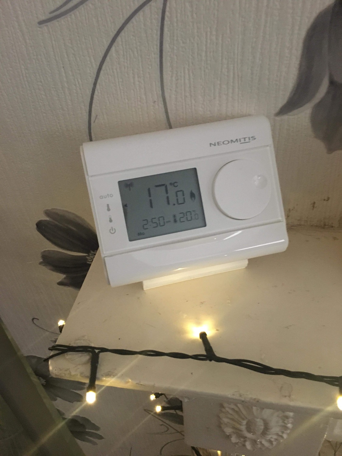

How do I find the ‘selected temperature’? And how would I judge if the ambience has reached this selected temperature?

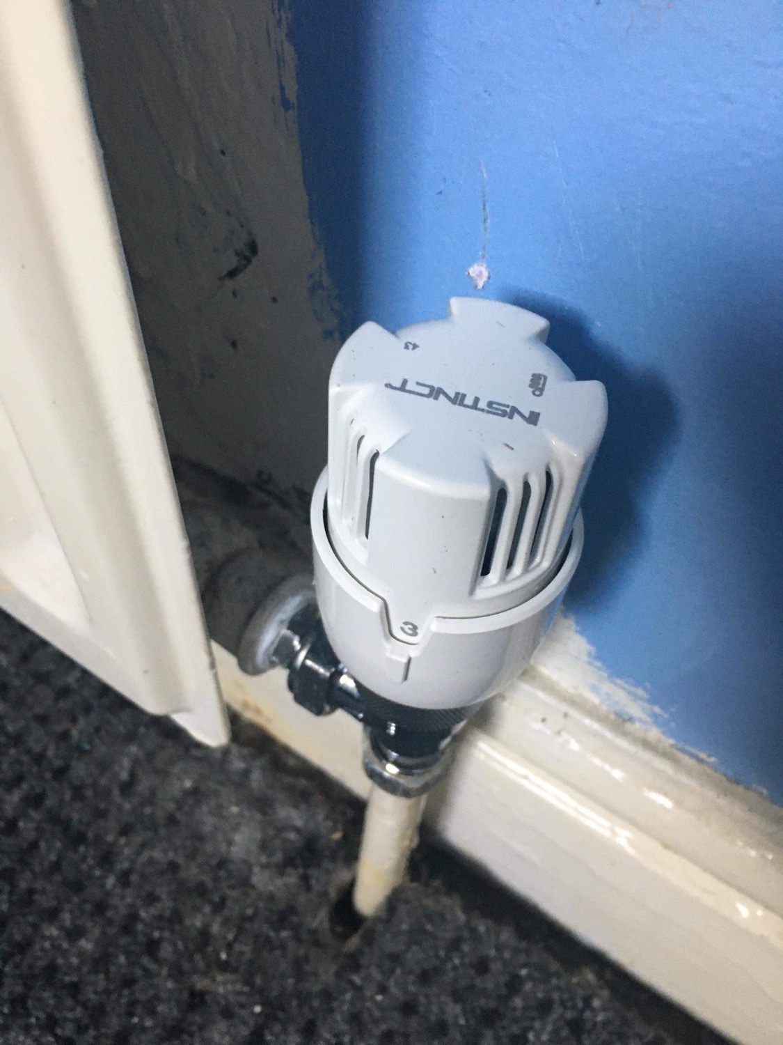

17°! I'd freeze at that temperature! Is there a TRV in the same room as the thermostat?
Sorry Im not too clued up. The boiler is in the kitchen and the little temperature box which says 17* is in the living room which is next to the kitchen
Turn all TRVs to max and set the room stat to 22 deg if everything now works it is simply getting used to your controls
Are TRVS are the valves on the radiators? So set them to max in every room?
How do I change room stat to 22?
thanks again
You can't have a valve like that in the same room as the thermostat. Turn it up to max or take the head off.
