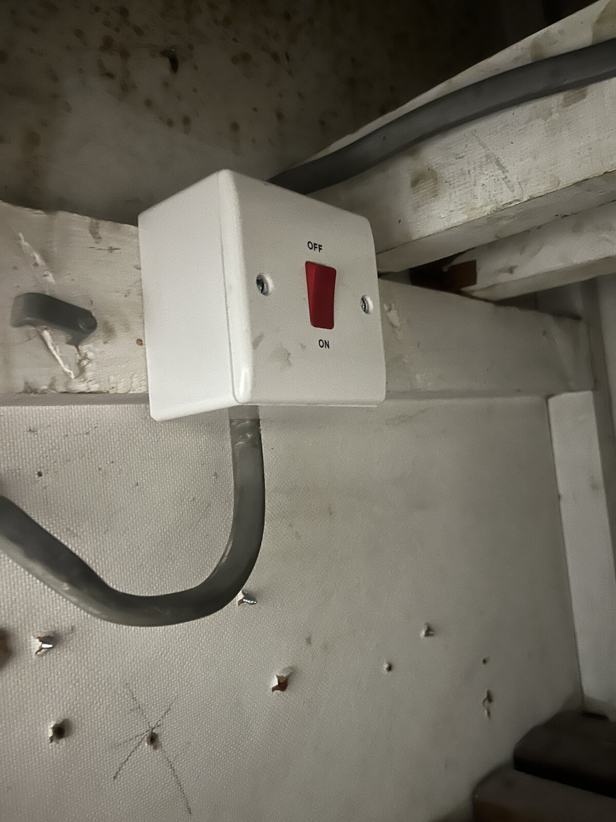

I don’t have a plug chord switch, it’s an on/off button. Forgot to say, an electrician came over the other day when the old shower was installed and he couldn’t find any electrical faults
Do you have any isolating switch, you havn't a pull cord switch but there may be a switch just outside the door that looks like a light switch, these sometimes have a LED.
Normally a pull cord or rocker switch for the electric to the shower, then the on/off button. How was it tested (eg, what equipment) and what were the results? You could carefully try without the cover and diverting the shower head into the bath/tray and see if it works - then you know if it’s a dodgy button.
Yes, that’s the switch I had to turn on and off several times to get the power light go come on on the old shower. It’s located behind the unit in the airing cupboard.

This is the switch I’m taking about

I’m not good with electrics but he used a stick tho g which beeped at several points of the shower unit including where the on/off button is
Thought that might have been the case - volt sticks are no good for proving voltage presence, or indeed if correct amount of voltage (circa 230/240vac). Needs to be multimeter or better/safer still a 2 pole voltage indicator.
