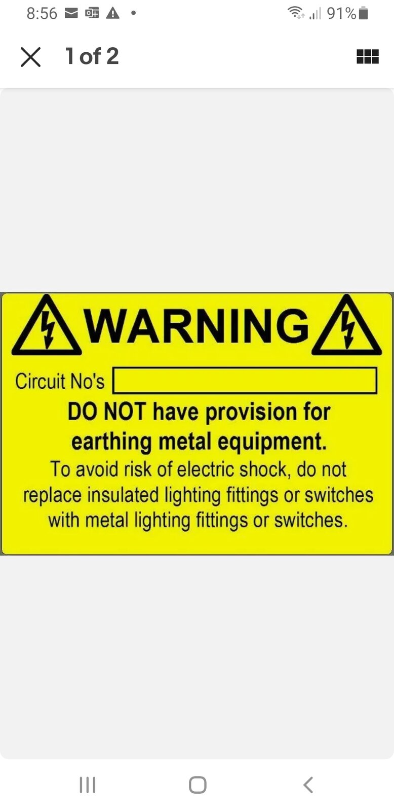

I phoned NICEIC for an advice and I was told there are 2 options number one re wire the lighting circuit again and option two to replace all switches and lights holder to non metal to prevent an electric shock and place a sticker .
That was what the old best practice said, clearly still valid. To my mind lack of earth means pre 1966 so need to be very careful.
As said had it with perants house and could not get the RCD to hold in. Lucky before 2004 so was permitted to simply remove.
Not sure today, we make a judgement as to what is safe, and we do what we consider as acceptable, but as to what a court would say if it all went wrong we don't know.
When I read court cases I think there by grace of God go I.
