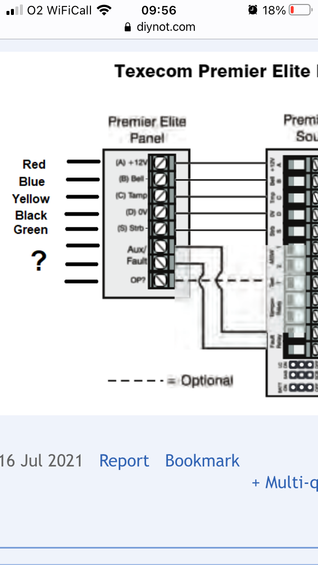

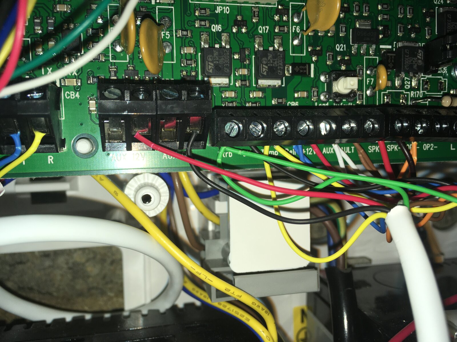

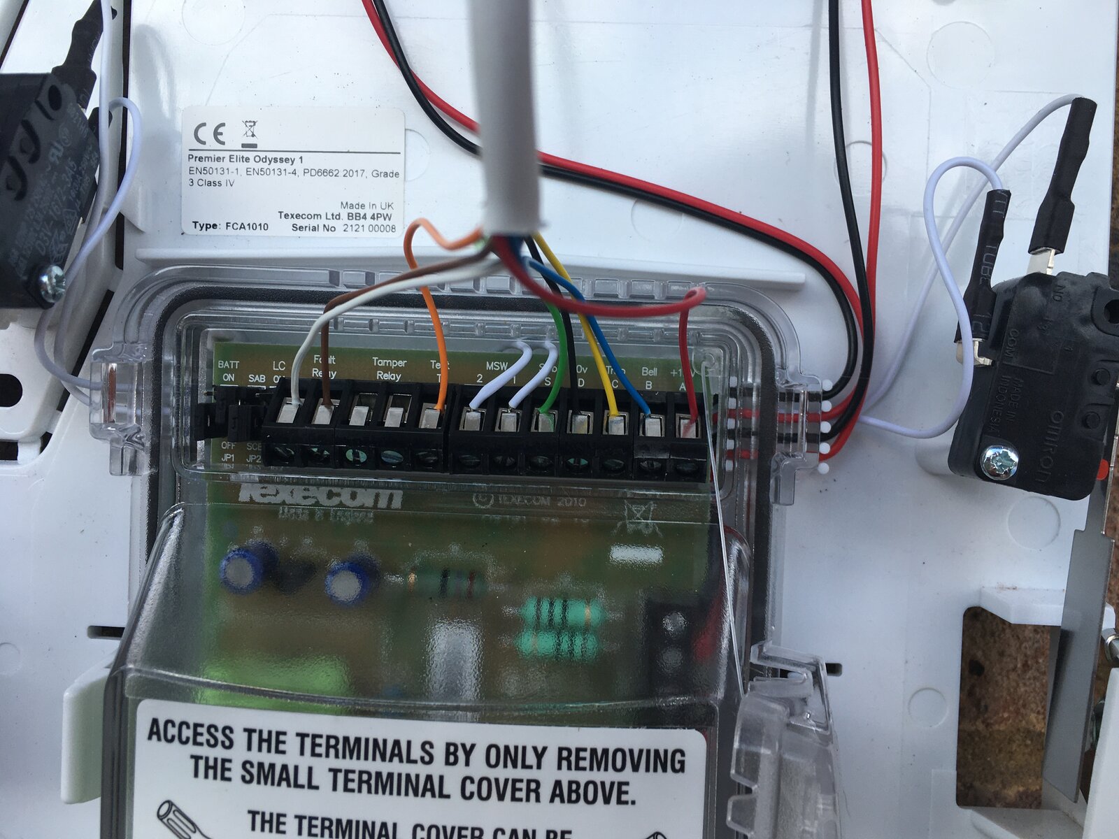

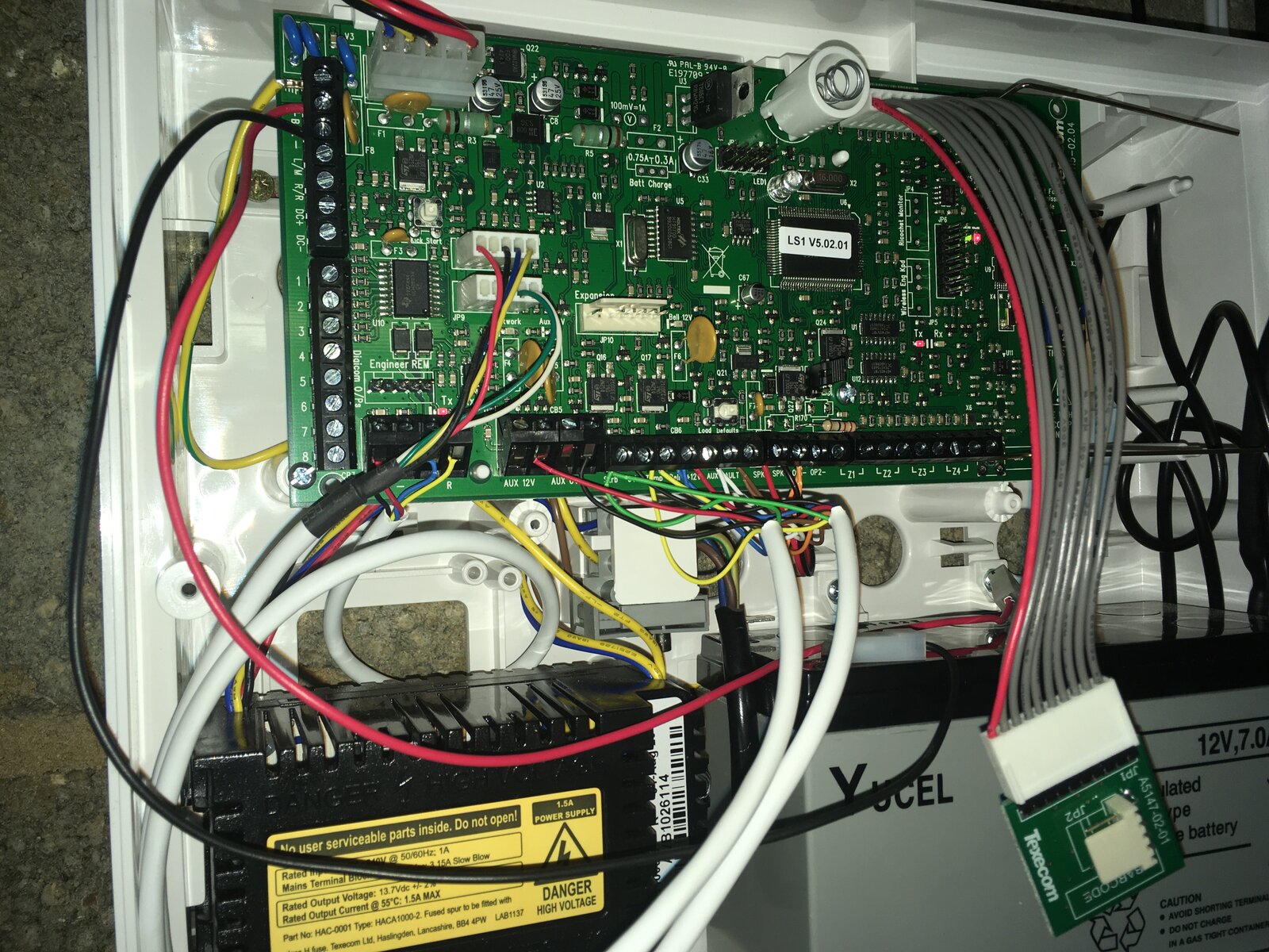

Finally got round to trying to wire up a new Texecom Premier Elite 64-W with dual elite sounders for the front and back of the house.
wired it all up, switched it on and only got the alarm out of one of the two alarms.
I’d wired up everything into the same ports with the same colours, with the exception of one of the sounders 12v and 0v cables (red/black) going into the aux.
Am I doing something wrong?
Everything….you don’t wire 2 sounders like that …as both lids would have to off to create a tamper !
Quick and easy test ….remove the yellows and the blues on both bell boxes at the panel … on bell one touch the blue to the yellow if it sounds then the tamper switch is closed , repeat for bell 2 ….if it does not ring check connections or tamper switch , then let’s move on to the next issue …
Also what have got wired into the aux on the brown and white and o/p on orange ?
From this…
