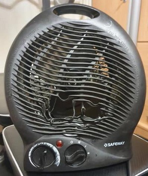

AFAIK it is impossible to start a fire with an oil-filled radiator, even if you drop a newspaper on it.
The reverse is true of fan heaters. Not just paper, or a curtain blown on it, or a carelessly discarded sock or teddy, or bedding but furniture or something nearby in the line of fire.
Surely the thermostatic cutout would stop the heat rising iff the airflow is cut ??
A sock or curtain need not totally block airflow.
i 100% agree on safety grounds if you have pets or children, even thought the danger level is small, it's far more than oil filled, and you also have the attraction of noise and prodding with something, possibly metal
Cheap fan heaters are also generally made of plastic, I can't imagine how anyone ever thought that was a good idea.
Oil filled radiators of course are metal, so would be my choice every time.
