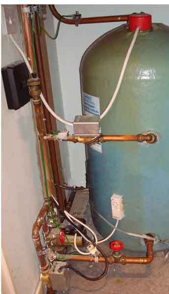

Looking at you pic I see no cold feed and vent, is the boiler a sealed system or do you have a small header tank in the loft.
What is the make and model of the boiler.
Has any work been done prior to the problem starting
List all the appliances that have mains cold.
The boiler is a MYSON Apollo Fanfare and has a small header tank in the loft , which sits at the same height next to the main cold water storage tank.
The problem started out of the blue without any prior work being carried out.

MOve them pipes in the airing cupboard sometime:
Spot the difference between your pic and the manipulated one :LOL:
Clue the one with the Motorizes valve on.
Afore you go ripping the bath panel off, check that it does have mains cold going to it, not cold from the loft tank!
You can check by trying to stop them each in turn. You should find you can stop the hot easily, but not mains cold.
And a thought - it's going to be easier to get to the pipes in the airing cupboard to add a NRV to the hot downpipe. Never seen it done so I may be having a dippy moment...?
Definately mains to the bath mixer.
As for the NRV in the airing cupboard , I thought about this as well as fitting one to the pipe feed to the bath mixer in the loft.
