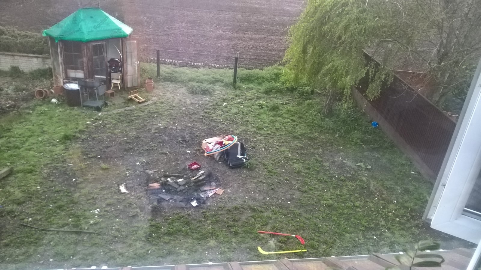

Hi All,
I am preparing for turf and am envious of how beautiful my neighbours lawn looks. Most impressive is its level. It's perfectly level throughout and I would like to put in the extra yards now to make sure it looks great.
I've had a labourer flatten out the majority of it but it's still not spirit-level level. He tells me that the perfect level comes from top soil...
Can someone please provide some advice. My life will not be worth living if my wife detects a difference between this and the neighbours lawn!

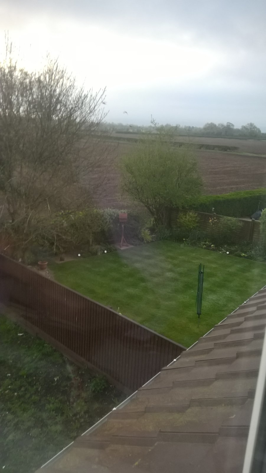

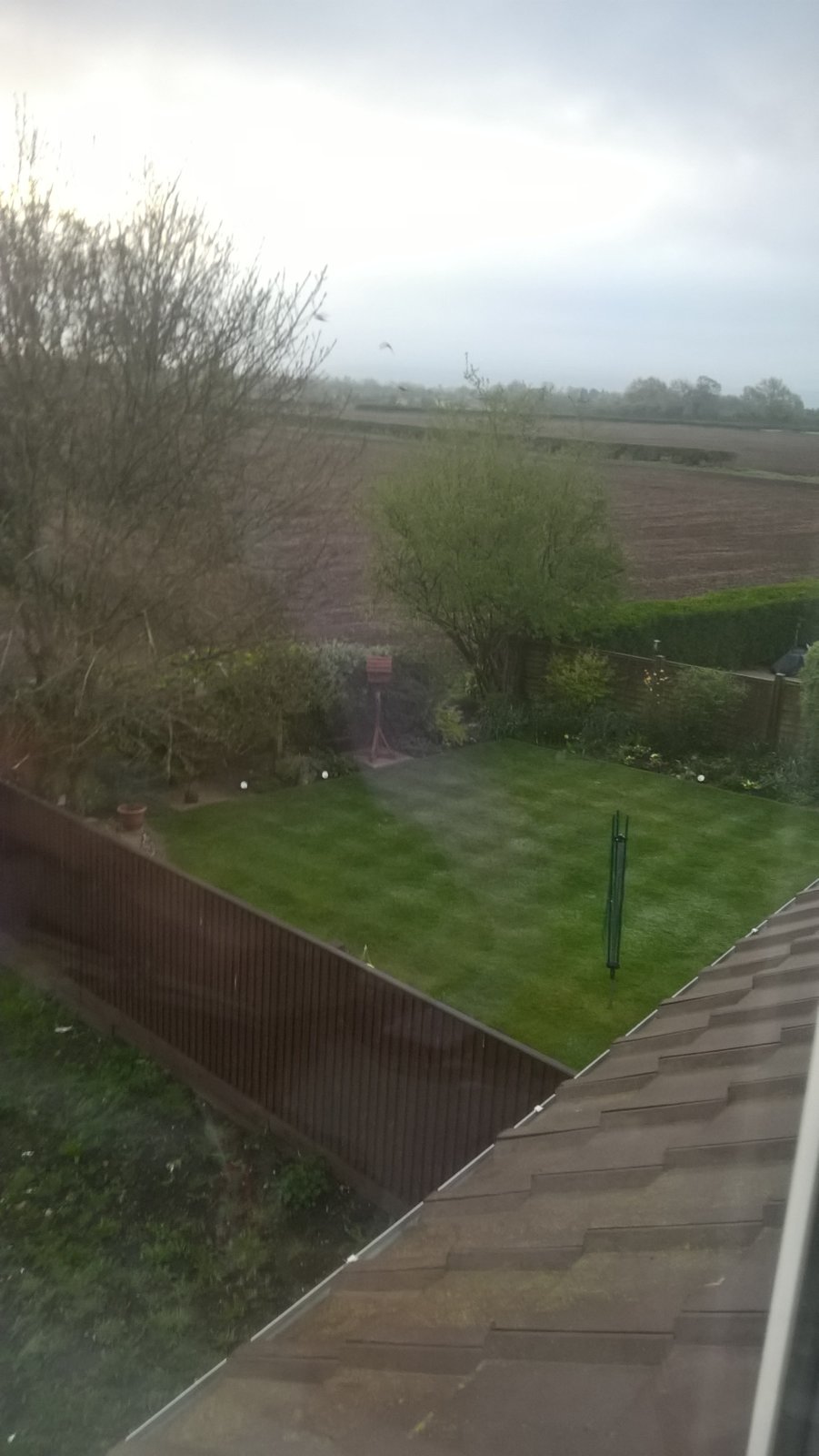

Let’s see a picture of the neighbour’s so we know what you’re hoping for....
here you go:
It's the best shot I could get

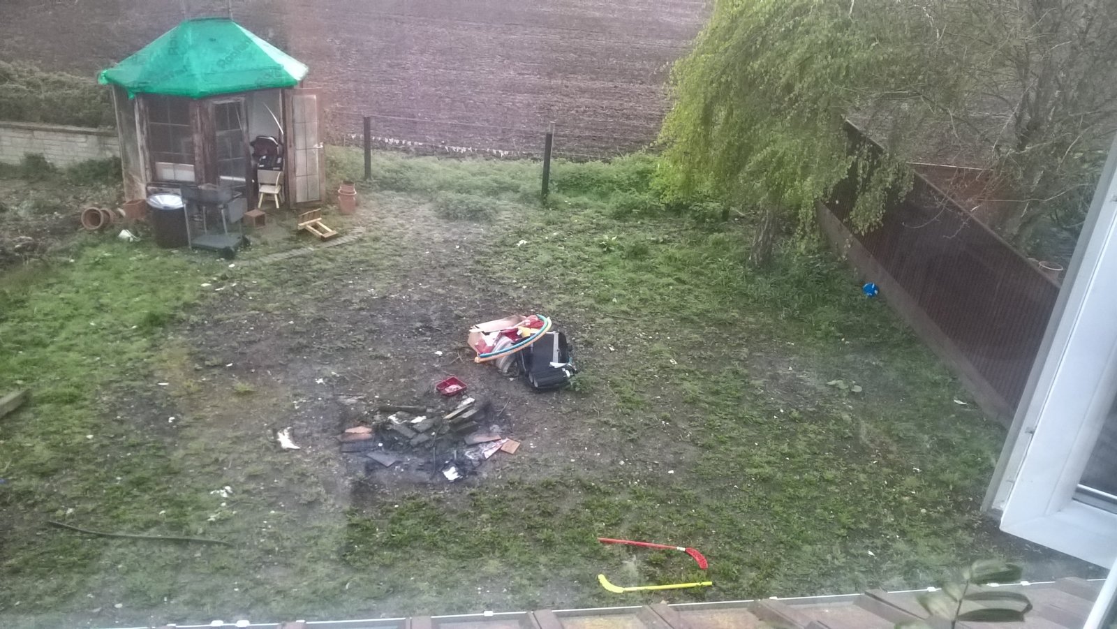

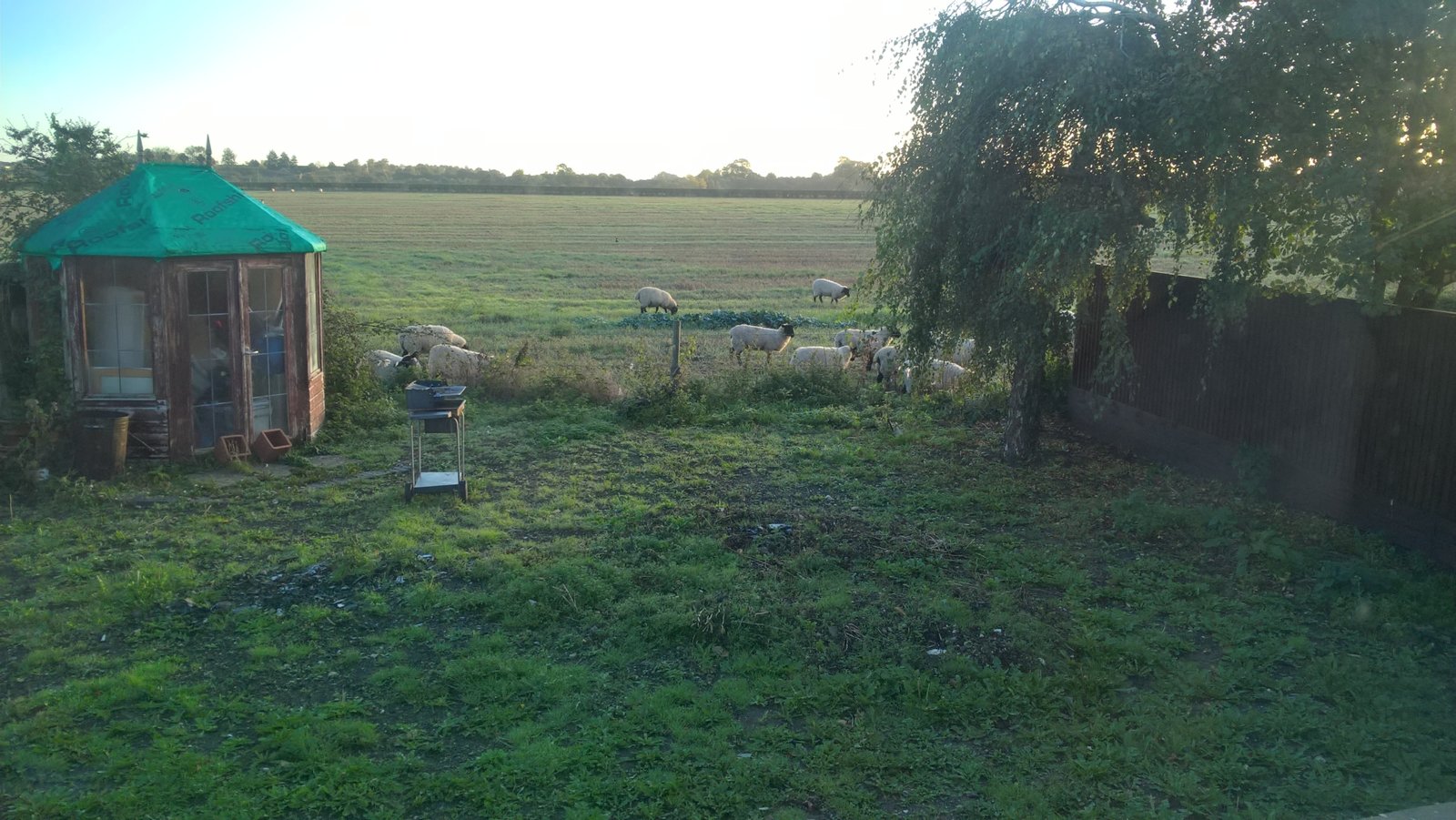

Also, here's a picture of my garden:
I look forward to hearing from you.

I’m not an expert, but I think that will need quite a lot of prep. Lots of new quality topsoil spread around and firmed before the turf goes down.
