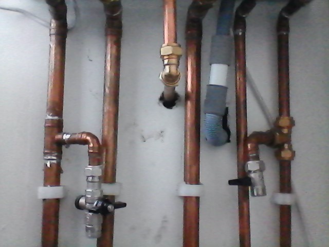

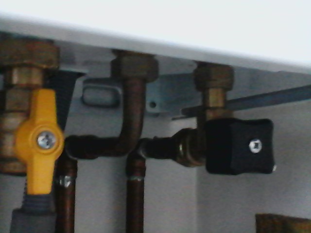

  • How does this look where the filling loop connection is:
    The pipes under the boiler:
    To the far right the cold water inlet valve (stopcock) which turns off the water when turned fully clockwise and full on pressure of hot water when turned fully anti clockwise: Is the cold water inlet valve stopcock (PRV) meant to be turned fully anti-clockwise as maybe the combi boiler cant handle the pressure of the the hot water flow?

You really need not worry about your PRV (Presure Release Valve) and it has nothing to do with cold water filling or filling loop, because I was trying to answer someone else as well about why PRV didn't blow out, ( blow out does not means as in real blowing things out) but in other words why did it not open to release excessive pressure in your system since I said your DHW heat exchanger may have developed a tiny perfortaion, in which case mains cold water would start filling up the CH radiators through this breach (perforation) to 3 bars and excess pressure would then be seen to escape via PRV., this would discharge any access water pressure to outside of the wall your boiler is fixed to. This can only happen if the incoming mains has enough pressure to open the PRV valve seat if perforation keeps allowing cold water filling the system through this perforation) (Indeed you need not worry, but there are number of other reasons too when this valve will open and start discharging access pressure)
Your filling loop connections are there, you can see one on left with a black knob, and one on the right again with a black knob, so the filling loop a flexible braided pipe that would be connected between these two and then you would open one of the black taps first and then the other one, whilst watching the pressure gauge, and fill your system (pressurise) to the right minimum required level.
In many installations now this loop is left is left disconnected. If you had any issues with your boiler pressure, give your landlord a call, don't do anything you don't understand. I do not think you have any issues with your boiler. It has to be your cold water from that loft tank.
Get someone to plumb it directly to mains water incoming.
Toilet pan being greyish is a scaling issue from hard water. Using Harpic regularly will dissolve it. Flushing alone does not get rid of water scale.
If you are renting, it is the duty of your landlord to have a Gas safe engineer each year to have it serviced and safety checked and issue you a copy of it. By law.
  • Looks OK.
  • To the far right the cold water inlet valve (stopcock) which turns off the water when turned fully clockwise and full on pressure of hot water when turned fully anti clockwise:
  • That square knob top right seems your hot outlet water stop valve, should be left fully opem (anticlockwise)
  • Is the cold water inlet valve stopcock (PRV) meant to be turned fully anti-clockwise as maybe the combi boiler cant handle the pressure of the the hot water flow?
  • No this is not PRV. and it is a cold water inlet to the boiler and should also be left fully open and closing this would also stop your hot water flow. This is Not a PRV which stands for Pressure Relief valve, which i said you need not worry about this at the moement.
  • Get your bath re-piped from mains cold feed, and see if your rash improves. good luck
