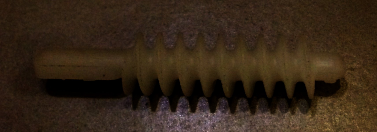

It's not really necessary for taps, but in the case of float valves, they don't really need to ask, since (in my experience) they usually come with a pressure reducing thingy to insert if one is using them with high pressure.

indeed, almost all float valves i have come across don't have any pressure reduction device in them, just the usual float valve and the rubber washer.

As I impliede, that's very different from my experience in recent times. Do the one's you've come across not have something like this 'in the packet'? ...

I can but presume that what Mike is getting at is that if one is (incorrectly) using one of those pressure-reducing inserts (designed for use with high {'mains'} pressure water) with a low pressure supply (i.e. from a storage tank) then, even when the float is down and the valve is therefore fully open, the flow can be very low/slow.

Thanks John, yes I have seen these come fitted in the pack, I have never had to remove any if they come fitted, I presume it is for reducing flow rather than pressure. (to stop water gushing out with force rather than with a reasonable amount of flow rate, and in doing so one may say it reduces pressure, once the valve closes, the pressure acting on the rubber disc would be no different to true incoming pressure, it just cannot reduce pressure as such in true terms, as a pressure regulator can do, as ones they use in gas supply, where they use a proper active regulator, using diaphragm and valves, but hey i am not here to argue with anyone, who knows i may be completely wrong.

in a cistern, all it will do is if assuming you did not have that spiral flow or pressure reduction device, it will fill tank up very rapidly, with a lot of water gushing noise, one can reduce this by turning the ball valve setting to reduce flow rate to a reasonable amount to avoid filling too rapidly, as there is a danger that the amount of water coming in may exceed that which can escape via the overflow in the event of a fault with the float valve. I usually recommend it turned just so that tank fills in about 3 minutes. ( I never leave it open fully even when spiral is fitted)

Oh, I see. The answer is that there is no such thing as a domestic float valve "designed to stop (only) low pressure", but the valves available are well able to stop high pressure (as well as low).
The system is 'self adjusting'. If the water pressure is high, more water will get past the valve as it gets near to the point of closing, so the water level in the cistern will rise and the force on the valve's washer due to the buoyancy of the float will increase. Just a relatively small increase in cistern water level will result in a considerable increase in the force being applied to the washer.
