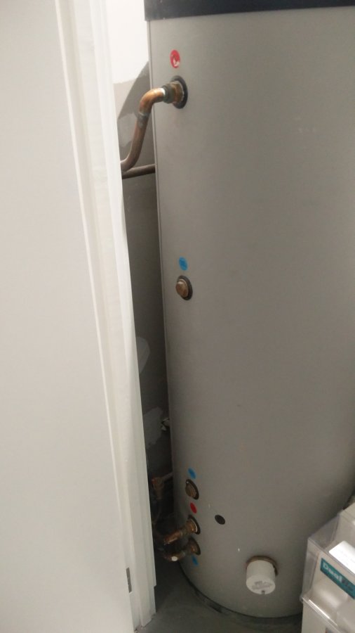

One image showing the pipes to the front of the tank, top one as far as I can follow (it passes behind the tank so can't be 100% sure but am 99% is from the zone valve.
Bottom two disappear behind the tank as two pipes on the front, but there are 5 at the back, which should be flow/return for upstairs, flow for hot water to kitchen, flow for hot water in bathroom and return from hot water tank... But that does t explain two pipes at the back of tank, and two at the bottom!

Unclebob, look at the link posted
http://www.hertsboilers.co.uk/tech/Back Flow.pdf
This is reverse circulation
I asked if the direction of water through the rads reverses when CH is on then off while HW is being heated
You said the direction of flow in the rads is the same when CH is off and when CH is on during water heating
In the diagram note the flow through the rads is reversed when only HW is on
If CH valve opens while HW is on, flow through the rads will be reversed
Clearly I cannot see what Tony is thinking of with TRVs- no relevance to reverse circulation
It would appear your CH motorised valve is passing if flow direction remains the same with CH valve on or off, otherwise a plumbing issue
