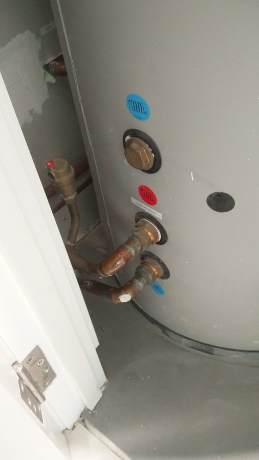

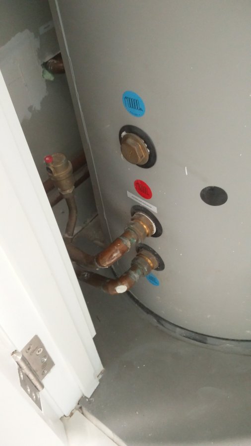

My tank has a total of 8 connections.
At the top, i have cold in, hot out, and a white expansion tank.
At the back i have 2 22mm connections (They go towards a section of the tank i can not see).
At the front i have 3 22mm connections (again they go towards a section of the tank i can not see).

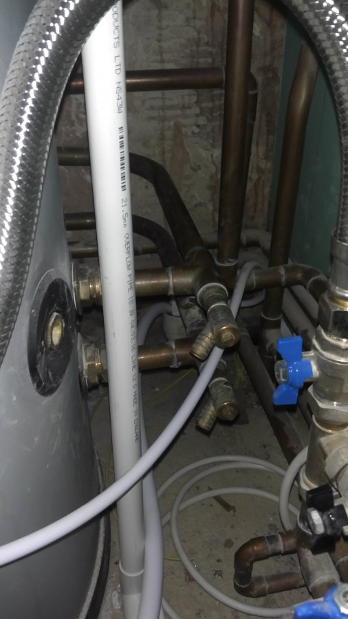

Then the pipe goes behind the HWT and i haven't been able to accurately follow it
Behind the tank is where the 22mm feed and return are for upstairs rads, as well as HW and CW for upstairs... but all in a location which is difficult to get to by sight or hand so hard to follow!

thanks dp - need to get decent view of what pipes are going where to try and see whats happening. I suspect that the flow or return for rads is passing though the HWT for some reason, but once ive got a camera on a stick or wife's compact mirror on a stick i can see which pipes at the back correspond to what i see on the front, and what goes into the wall... then i'll get my labeler out and mark up everything!
So I turned on Ch only for upstairs noted what pipes got hot and in what order.
So zone valve opened and pipe got hot, followed it and it led to the hot water tank bottom connection(middle of three)
The back of the tank has two outputs, of which the top of the pipe got hot, which then went into the wall.
There is another 22mm in the wall just behind which appears to be return but didn't get hot. Meanwhile return to boiler is hot, as is the bottom output from he
So I'm getting the feeling that the feed for Ch upstairs is through the HW tank... Though not traced return yet but suspect it is the bottom pipe at the back, and flowing to the front return (ie mixing with the boiler side of hot water tank)... Suspect I'm gonna have to get someone in to take the tank out and replumb behind it... Not sure I want the original installer back!

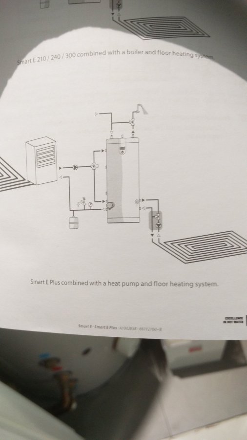

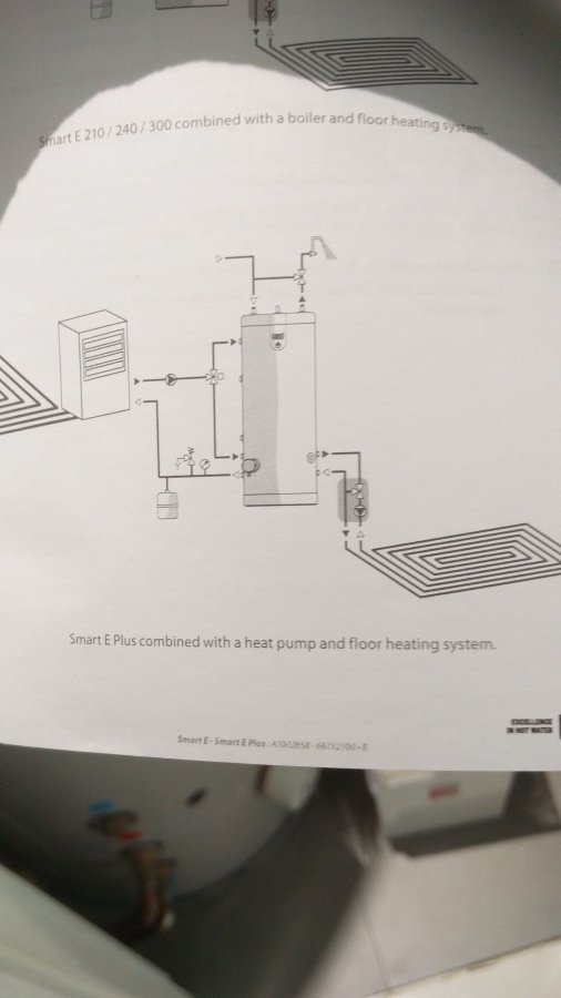

Images of the front, back and pic of manual...
I'm guessing he's done as image shows, but instead of ufh manifold he's done rads.
Manifold would not heat if zone doesn't need water, but rads will if no thermostatic valves!

Last picture would suggest only two zones i.e. radiator zone and cylinder zone
Underfloor would be taking heat from the cylinder. I would imagine if cylinder temperature drops, cylinder would then run the boiler. Could be wrong as I am just imagining how it might work.
