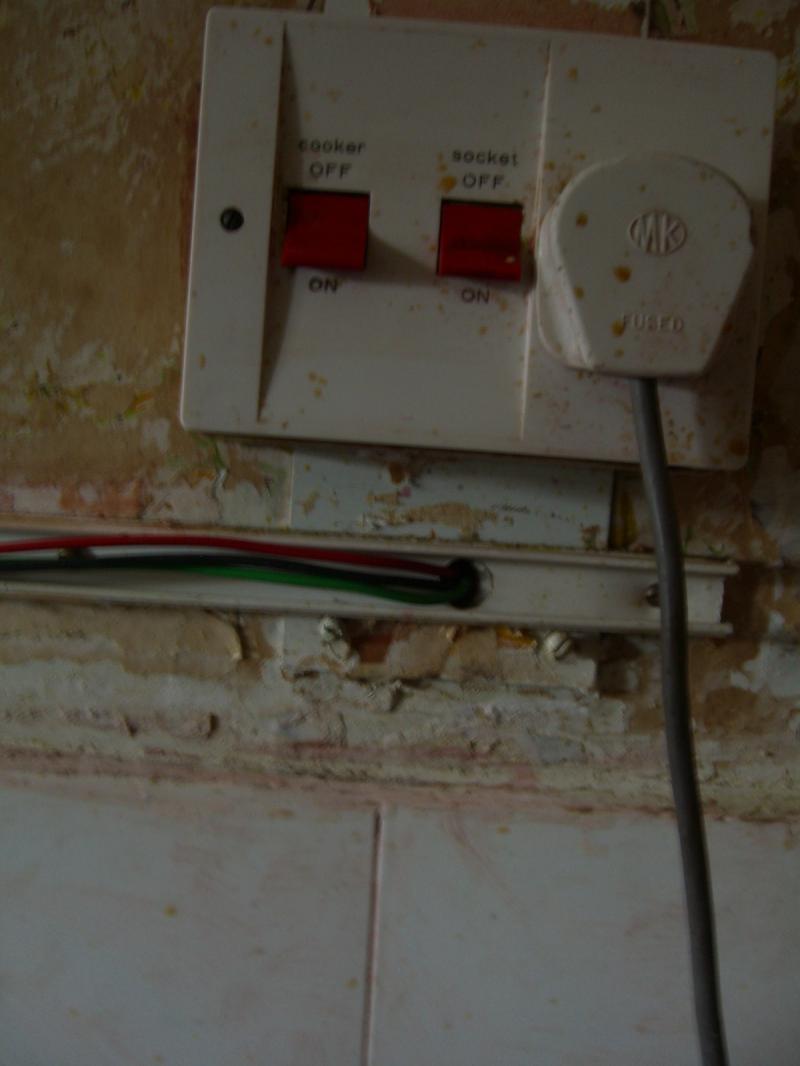

hello.
i need to wire in a new built in type cooker which the instructions say would be ok on just a 13amp plug, which surprised me. and on top an electric hob which apparently needs to go into a cooker point protected by ??? it doesen't say. its a bosch ordinary electric hob. not halogen or anything flash.
anyway what i'm thinking of doing is wiring the hob into my cooker point which is protected by a 30amp fuse at the fuse box (old style bakelite) at the moment.
But also i want to create a radial circuit to plug the cooker and the extractor fan into. and also fianally the fridge freezer.
i was hoping i could put the radial circuit AND the hob in the same cooker point outlet.
so wired into the outlet would be the hob plus a lenth of 2.5mm cable along which would be one double socket into which the cooker and fan would be plugged. the out again and terminating at another double socket into which the fridge freezer would be plugged.
i would like some advice on whether this is a safe option. thanks.

you can't have a 2.5 radial protected by a 30A fuse, 4mm would be ok though.
not recommended to have a radial off a cooker circuit if the hob/cooker is attatched to it.
best to install a new seperate 20A radial for the oven / extract and a 16A for the fridge.. or a 32A (4mm) to cover both.
thanks ever so much for those replies. i'm thinking in light of what you've said that i should use the cooker connection for the hob alone and create a separate circuit for the other three appliances; namely the oven, extractor fan and finally the fridge freezer.

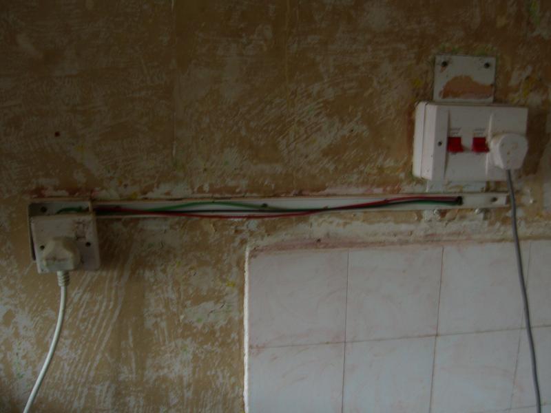

there is a connection box above the cooker point which contains 1 switched socket plus the cooker switch.

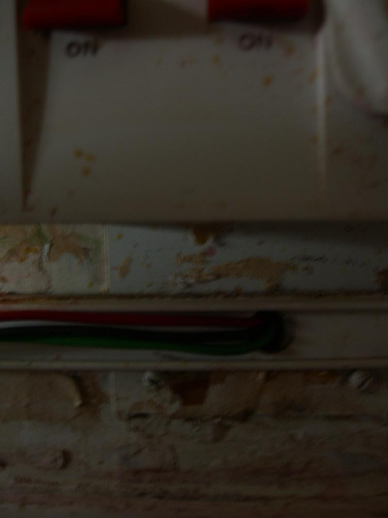

directly beneath this is a hole out of which comes a cable that connects one plug socket about 1m away to the left as you look at it.
maybe the easiest thing to do is nip these three wires. live neutral and earth and connect them to a junction box and run the cable for the circuit from that.
the wires that protrude from the hole are connected to the ring main at the fuse box which is on a 30 amp fuse.
all i have to hand is a connection box which is rated 20amps.
from what you say it looks like i'll be needing 4mm cable and presumably an upraded connection box maybe also 30 amp. does this sound like the best solution and can you give me any more tips about what sort of connection box would be best. i would also like to take the connection that goes out the the socket that already there a bot further along and put a double socket there.

i've got one of these; http://www.diy.com/diy/jsp/bq/nav.j...&action=search&isSearch=true&ts=1288796161188
can i insert the wire from the hole that you can see in my picture into the supply holes on the above mk item and run a 4mm cable out of the load holes and attach a few sockets along that cable. those wires are part of what is described as the ring main at my old style fusebox.

The link is supposed to be to a 3-terminal 30A junction box, although it seems that the forum referral code breaks the link. In any case, it still sounds like hanging bits off an already heavily loaded circuit to me. If you want a temporary solution, run your fridge from an extension lead. Chances are that any semi-permanent solution will end up staying there for years, and is better avoided.
Electrical work in the kitchen (like you describe) falls under Part P of building regulations. For instance, 'simply adding a socket' in a kitchen can snowball into upgrading the consumer unit to add RCD protection to comply with current regulations. You can do all the work yourself, but you MUST notify local building control and pay their fee.
