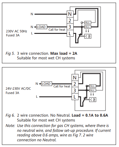

We have an old combi stat in the hall way which we would like to replace. Doesn't seem too accurate plus would like a digital stat until we replace the system.
Is this possible? Is it a DIY job for a relatively competent DIY'er? We have an old ideal classic boiler with a heat store cylinder in the airing cupboard, no water tank
Thanks,
If you can wire a plug, i don't see why not.
that's what I was hoping to hear. also to check if analog thermostats can be swapped out with digital, i.e compatibility
Much will depend upon the wires that presently go to the existing room thermostat and the wires that are required by the new one.
Some mechanical dial thermostats sometimes only have two wires connected, that operate simply as a switch to turn the heating 'on' and 'off', but some of the newer thermostats as well as the switch, also require 230V to provide them with operating power too. which may, or may not be present.
This is where it gets tricky, because the Drayton Combi-Stat ideally should have 3 wires, but sometimes doesn't as the following diagrams show:
In the first example you will see that there is a wire connected to the top N terminal, but in the second there isn't. So, If there are only two wires currently being used with yours (i.e. there isn't a neutral) a battery operated thermostat might be a better option as it doesn't need the 230V supply.

The terms analogue & digital refers to the way the thermostats function internally, but at the end of the day both contain a simple on/off switch that actually controls the heating. So, from an electrical point of view, both are identical. There are exceptions that only work with certain boilers and that carry data signals, but for standard room thermostats it won't be an issue.
