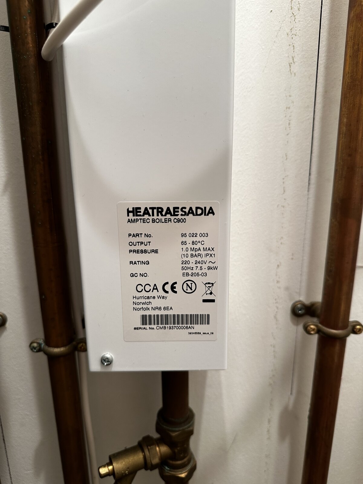

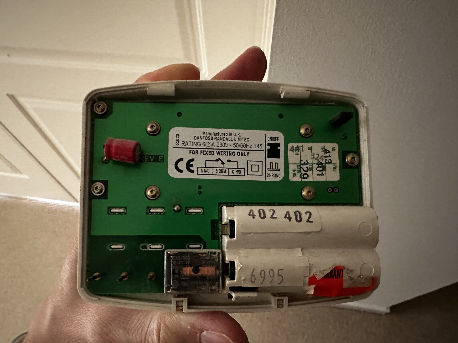

Our electric central wet system consists of an electric boiler (Heatrae Sadia Amptec C900), a hot water tank (Cyclone CY200), a wired Danfoss TP5000 thermostat and multiple radiators in each of our rooms in our apartment.
I am not able to see any receiver attached to the electric boiler so I assume heating is solely controlled by the TP5000.

I am wondering now if I could simply replace the existing Danfoss TP5000 thermostat with a wired Tado one and be able to keep the hot water preparation as it is and adjust the heating with Tado? Next step would then be to replace the TRVs with smart ones.

The 2 wires for your danfoss will go either direct to the boiler or via a wiring center. The Tado will likely need a permanent live and a permanent neutral and those 2 switch wires. If this seems too complicated to do, you could always go for a Nest E which uses batteries and just those 2 wires.

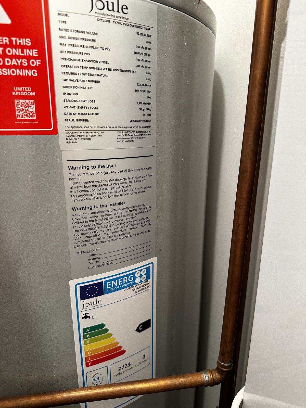

your HW is heated by the two immersion heaters in the HW cylinder and not by the Amptec, the danfoss only controls the heating side and is totally seperate to the HW side

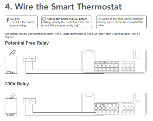

I assume then it is just a matter of wiring the brown cable to COM (common) and black one to NO (normally open) on the Tado thermostat?

- Hot water is dealt with by the two immersion heaters in the HW cylinder and is automatically activated during off-peak hours (cheaper electricity).
- Heating is triggered by the wired Danfoss thermostat which then activates the Amptec Boiler when a certain room temperature is reached. The Amptec heats fresh water to the required temperature and then distributes it to the room radiators. It doesn't take hot water from the water tank.
No the water inside the radiators is not "fresh" water it is a sealed system, the water in the HW cylinder and the water in your Amptec and rads are totally seperate and never meet.
No the thermostat has no wires it is battery operated and sends a signal to the Tado hub, the two existing wires from the Danfoss go to NO & COM you will ason need a mains voltage supply to the hub, here is a shrt video explaining
If you have the battery operated Wired Tado, then yes you are correct...
If you have the wireless version, then the video from @ianmcd applies.
