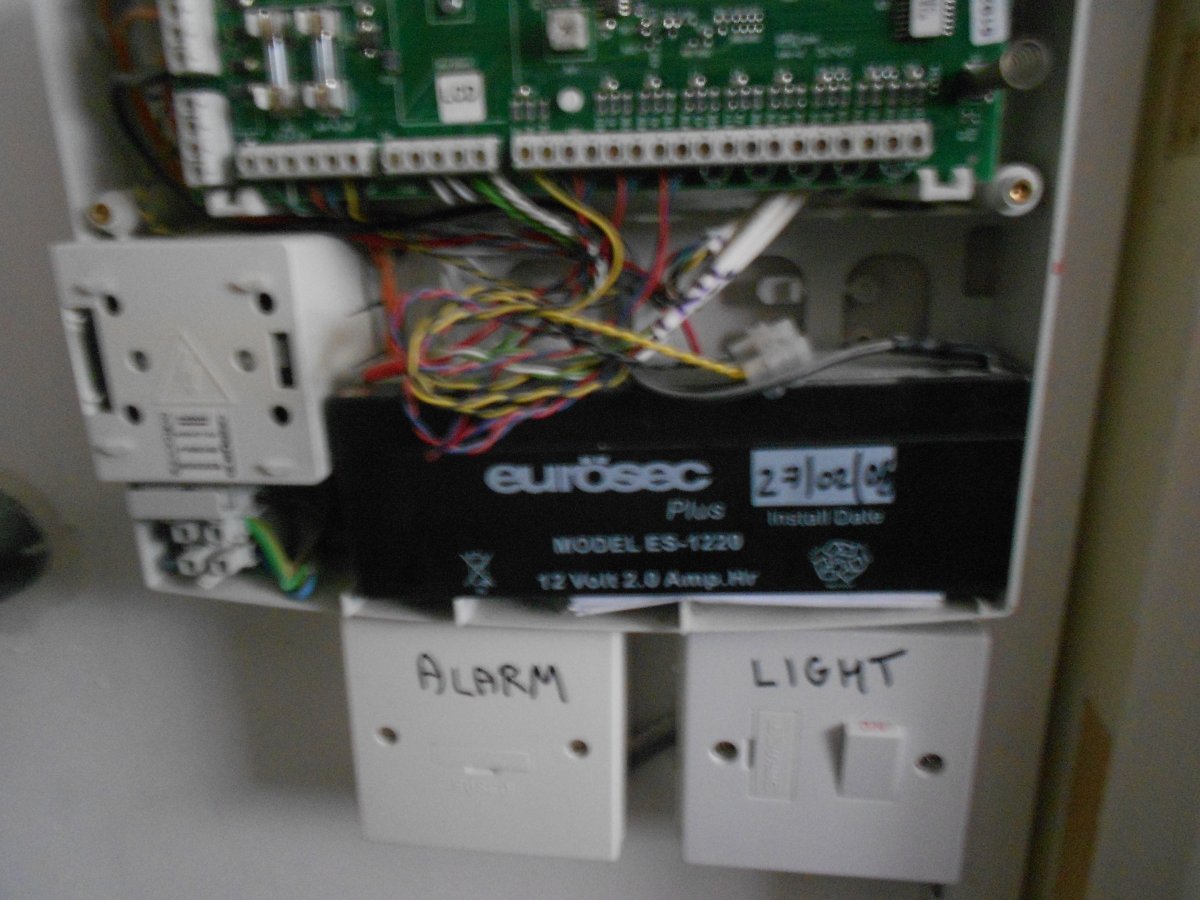

I have ordered a replacement back-up battery for my domestic alarm system. Same voltage, amperage, physical dimensions and same terminal locations. It looks a simple enough drop out/ drop in job.
Please see attached photo. Positive terminal (red) top left of the battery and negative top right.
Question: Do I need to disconnect the mains before I take out the existing battery and install the new battery?
I would pop the Alarm fuse out as there is a risk that you could touch a live cable.. there is no reason to do this other than a safety point of view though.
Thanks Biking my owd. Obviously there is always the risk of frying oneself with electrics. I was intending to use insulated pliers and rubber gloves just to be on the safe side.
My main concern is that if I shut off the mains and then removed the back up power supply (the existing battery), would the alarm unit reset itself to factory default settings whereby I lost my personal four digit code (that the alarm installer asked me what I wanted it to be when he installed it) and it reverted to some, unknown to me, factory default code.
I think its unlikely, I assume your CU has RCD and not the old cook-em-slowly wire fuses?
complete power downs don't usually default the panel, usually certain criteria are met on power up that default the panels.
anything with an lcd keypad would probably need the time and date resetting as a complete power down means thers no power to keep the clock time and adate.

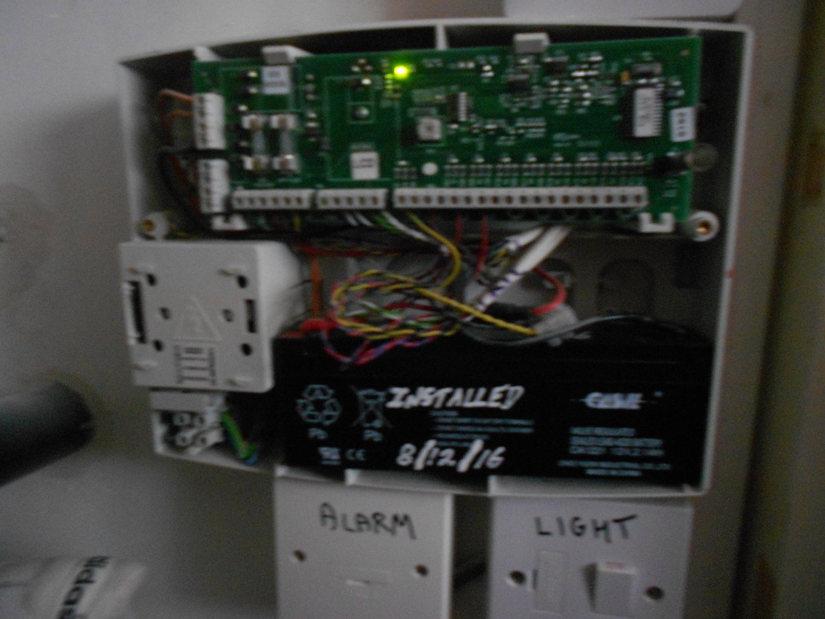

Thank you to all who have assisted with this. New back up battery arrived in the post today. Very easy fit. I didn't have to disconnect the mains, simply disconnected the old battery and hooked the new one in. Not bad for u
nder nine quid off Ebay.
