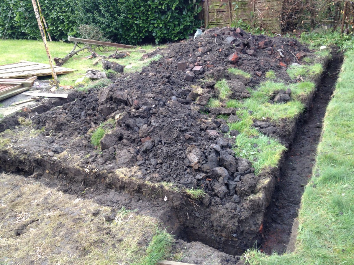

We are building a 10ftx18ft single garage. Single leaf blockwork.2.5m high with sloping metal roof. The windows/door will be from eBay. The garage will be rendered and front will be brickfaced at ends.
Dpc and concrete slab at 6inches
Foundation wall built 45-50cm
Excluding all doors windows the cost is £2500 for labour and materials. I have paid £1000 already .
Can upload pics as it develops . Concrete pour starts tmrw.

Half of those costs we don't include
The trench was dug
without machine hire.
He has cement mixer hired.
Doors and windows not included

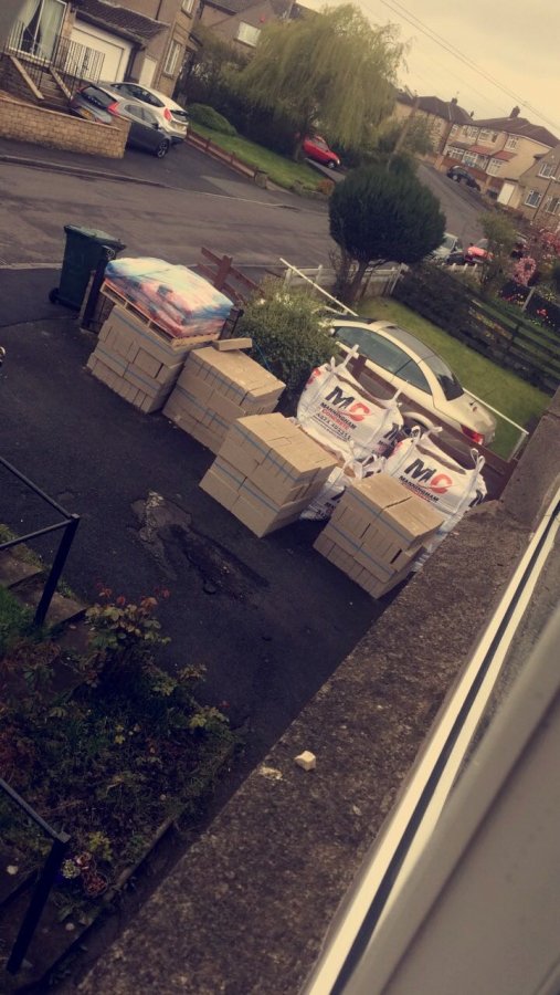

Received 4 ton ballast
25 bags concrete and 4 packs of blocks.
No eletrics and just metal roof
Lintels will be needed for door and window.
No soakway.
Gutters only
Render will be £200 he said at his cost.
No scaffold that's his decision.
No mesh
Pic of materials
