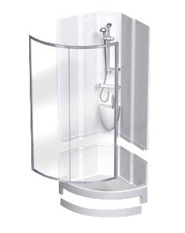

I am not sure what you mean, Gigz. Connected to the pod? The main problem is, being able to fit any plumbing to the shower valve as well as still being able to manoeuvre the shower wall back onto the wall, and screw it in place, see here, for what I mean:
I cannot see, that unless the pipe at the back of the shower valve is flexible, how to connect it to the back of the valve, then screw the shower pod to the wall.
The fitting instructions are here:
http://www.byretech.com/acatalog/Install_Quadrant_Shower_Pod_Coram.pdf
I just cannot get my head around the piping, and being able to screw the top panel (containing the valve) back onto the wall, without using a flexible plumbing tube.

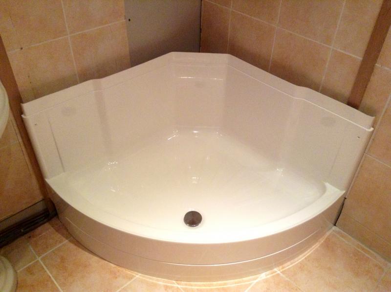

For example, here is the base of the shower pod in my en suite (and you can also see where the builder fitted the battens in the wrong place):
So the pipes, hot and cold are in the corner behind, let's say copper, or plastic. I cannot see how I would be able to connect the water supply to the shower valve from behind without using a flexible pipe, as afterwards I need to lift the top half in place to screw onto battens.
I must be missing something obvious?

Here is the back of the top section:
Here is the front view:
So, when the base is in place, and I am lifting the top piece into position, I somehow have to fit the pipes at the same time.
Look like they intend you to do it in push fit. The manual is a little vague.
Is it possible that you could measure and fit speedfit pipes to the elbows to the top part, these will have some flex in them. Then tilt the top part and slide the pipes behind the base whilst tilting the top part back to the wall. Then make pushfit connections underneath, putting iso valves in an accessible place.
This is just a possible solution for you to consider. I think having looked at the manual I think I will stick to traditional shower base, tiling and enclosure!
Personally I don't think your pod looks easy to fit at all...
Looking more closely at the manual, they clearly expect you to make the connections at the bottom after the whole thing is slid into place.
Manufacturer's instructions cover pipe connection in sections 4 & 5
Also state that they supply 2 no. speedfit barrier pipes for the purpose

The instructions say to move the base out from the wall, lower the top section into place and then connect the flexis.
For what it's worth I'd avoid having concealed flexis/pushfit but, short of cutting access panels into the unit or into the adjacent room stud walls there's very little alternative for the chosen unit.
