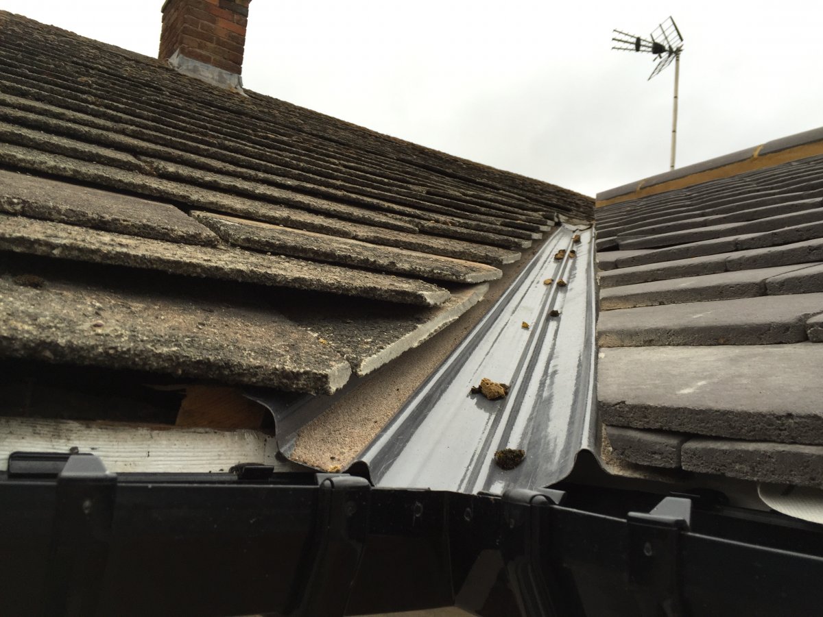

Hello All
Posted on the builders forum I just want to see what roofers think.
I've had a front extension
New roof to left of photo old roof to the right I can see day light.

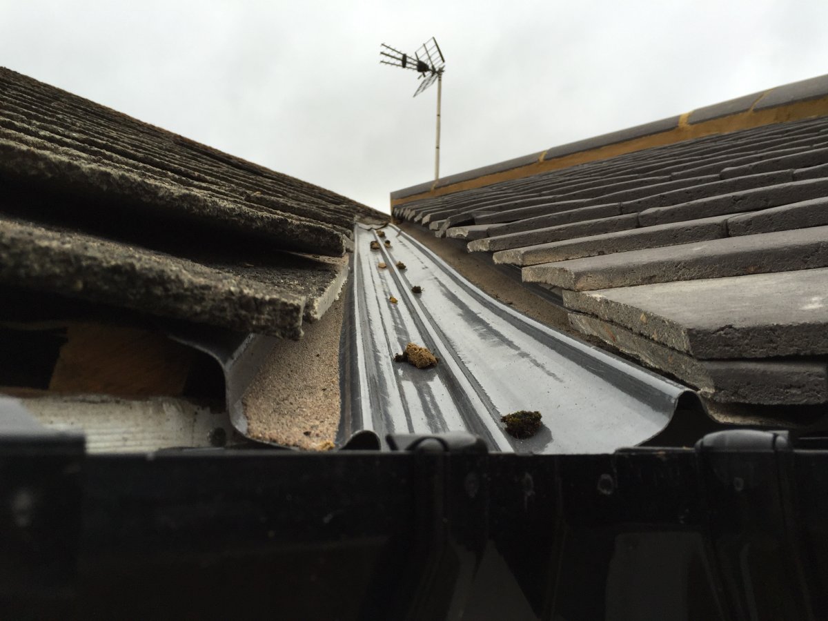

I'll add couple more pics if you would tell me what you think please
Bod
From the inside
It really is a pants job. That is not a dry valley yet has been treated as such by the idiot builders. I've already commented on this...try here...for those who may want to add more.
What can I say poor workmanship I would hope it was not a roofer that left it like that Why have you paid in full before you are satisfied with the work.
Because he's a neighbour I had a few issues before I even noticed this I trusted he would come and sort out. He may still do.
If he don't what can I do ?
Bod
Bod
Is he Satanic Stan the roofing man ? aka neighbour from hell.
I spoke with building control today he was very helpful. Said the job has not been signed off yet and will meet me to discuss.
