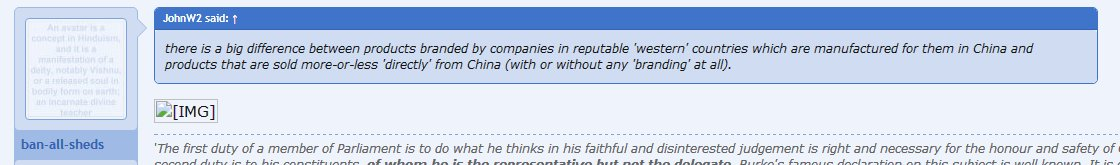

It would be nice to be able to see these embedded images without having to hit the "quote" button. It seems to be happening predominantly with posts from yourself, so I wonder if you are dealing with images in a different way from many/most other people?
Kind Regards, John
Are you still having that problem? I have not since the last time it was raised.

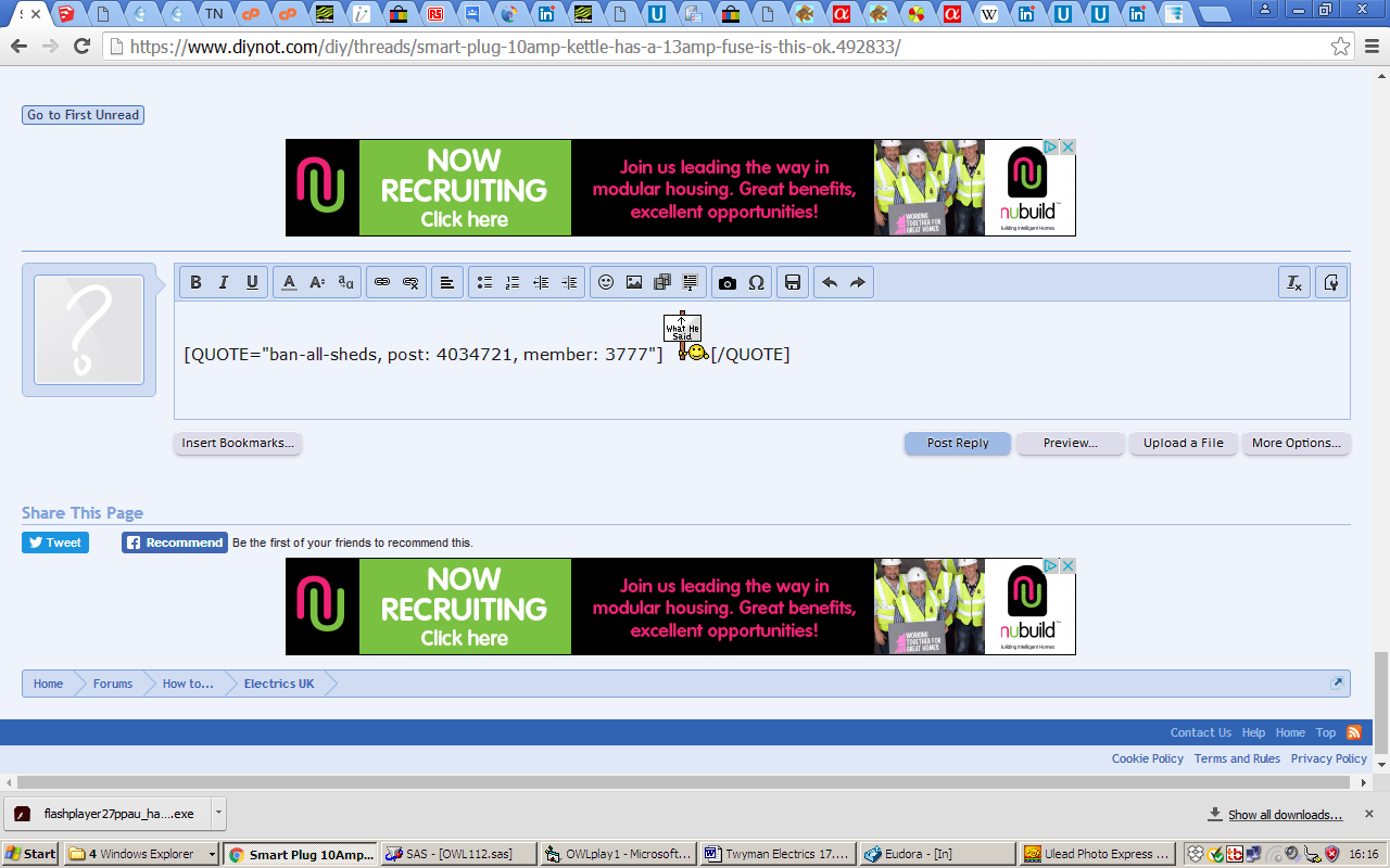

Yep. This is what I saw ...
... but when I click on "Quote", I see in the reply window...
... but then if I post that reply, I again only see the placeholder in what gets posted.
Kind Regards, John
