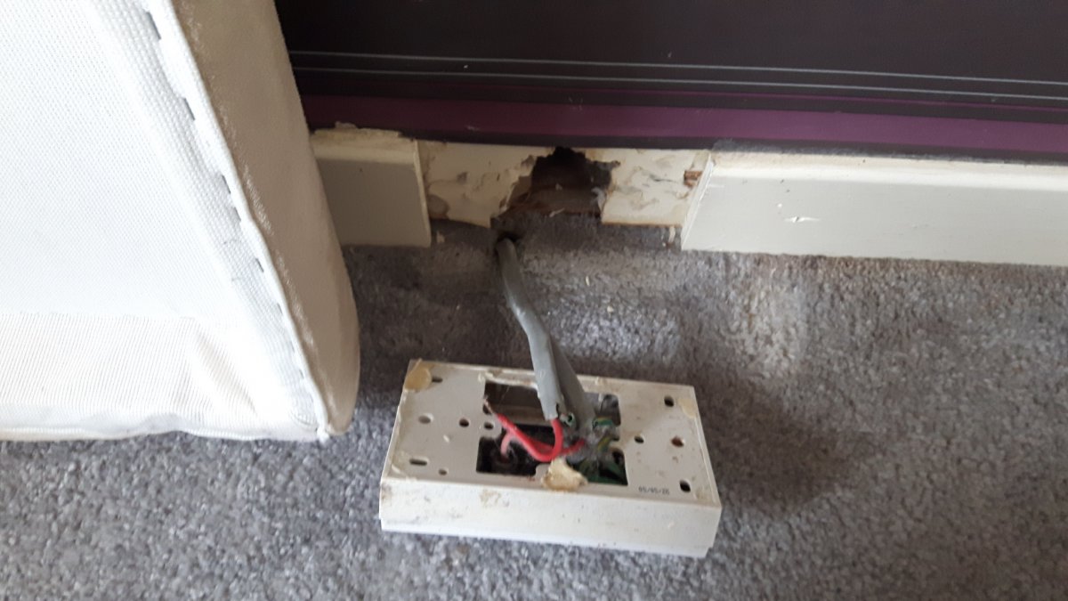

So in my Mum's house she has a double socket which is too low and wants it moved higher.
But the cable won't stretch.
The original socket was one that had a cover at the bottom which fitted alongside the skirting.
Can I extend the cable and fit a new socket unit higher up the wall?

, and extend both the cables up separately to a new socket, so keeping the new socket on the ring.
That's not really necessary. One cable from connectors to socket will suffice, i.e. three conductors in each L and N connector.
All earths must be connected, i.e. three wires in existing box then the new socket and box(if metal).
You could replace the existing socket with that and a blanking plate, and extend both the cables up separately to a new socket, so keeping the new socket on the ring.
A blanking plate is unnecessary - the socket above will create a cable zone, so a maintenance free JB could be put into that cavity and the skirting board made good.
The best way to do it though is to avoid even MF joints, get access to the cables under the floor, and replace the cables to/from the adjacent sockets.
I got the socket fixed and moved up.
I used the 30a block and extended the wire. I fitted a dry wall back box so I could flush fit the socket.
I would have been great to replace the whole wire from the nearest socket but that a job for another day.
Thanks for the advice everyone.
