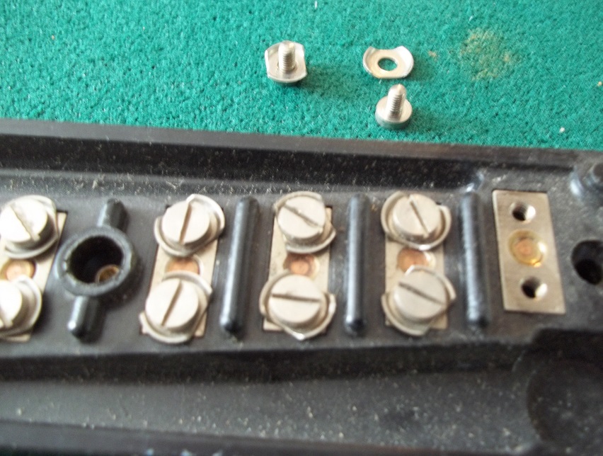

In the good old days solid wire was put clamped under cupped washers in GPO terminal blocks and some alarm systems used the same blocks or variations of the
cupped washer. Breakage of the solid conductors was rare
