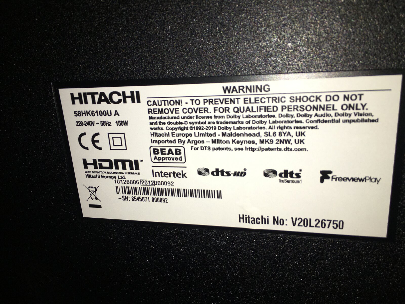

There does seem to be a backlight, just a blue/grey screen though.
Again though, any on screen display, menus etc? Or just the blue/grey screen?
And as Winston asks, is this limited to the HDMI inputs, or to the tuner as well?
Backlight failure on an LED TV.
A single dead LED can stop the rest from working. (Think 'dead bulb on Christmas tree lights'.)
The fix is to strip down the TV and replace all the LED strips. 58" is still a big TV by current standards, so if you were happy with the TV then it would be worth doing. The only question mark is over the availability of the light kit and whether you're up to fitting it.
