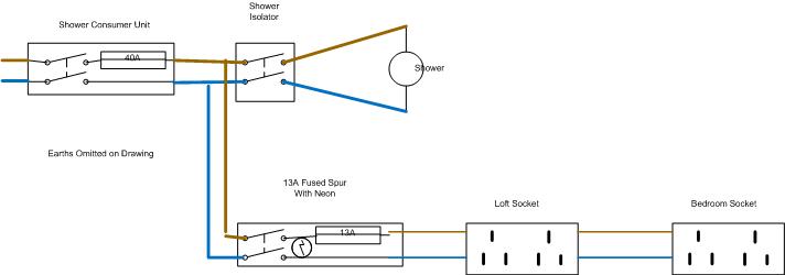

I need to get power into my loft so that i can power a tv distribution amp, and to install ceiling sockets in a bedroom to supply a wall mounted tv
Unfortunatly i am unable to see any way of taking a spur from the ring main on the first floor, however i can get access to the shower supply.
The shower is fed by its own 40A fused CU, and the feed runs into a DP pullcord isolator before the shower.
My question is, is is permissable to take a spur before the DP isolator and run this through a 13A fused spur before connecting to a 2g socket in the loft? I can find nothing in the 16th ed regs that forbids this, but what do you guys think?
furthermore is it permissible to install 2 2g sockets in parallel (spur from a spur naughtyness) in this situation as in the following diagram.
if not, can i run each socket back to the 13A FCU in a (sort of ) radial configuration?
thanks for your time
nick
Why not? Where do the cables run?
I think you'll struggle to get 2 x 6/10mm² cables into the switch terminals.
Of course it is, if the spur originates from an FCU.
Your diagram already shows a radial - what do you think it is?
hmm hadn't thought of that. Given that a spur must be run using the same cable as the feeding circuit, this means 6mm². Presumably after the FCU i can use 2.5mm²?
sorry attached the wrong diagram, but you answered my question! :D

Red/Brown books are in the van, and I'm not one to quote from regs but IIRC, all water or space heaters above a certain wattage (quite low IIRC) are supposed to be fed from their own dedicated circuit.
Anyone with a book to had prove/disprove this?
Yes, isn’t in the OSG?
http://www.tlc-direct.co.uk/Book/6.3.2.htm
Fixed equipment such as space heaters, water heaters of capacity greater than 15 litres, and immersion heaters, should not be fed by a ring, but provided with their own circuits.
Although not explicitly stated, I suppose the above must cover electric showers as "fixed equipment", because it would be a bad idea to put them on a ring :eek: .
I cannot however see a problem with my shower lights, or Ban's extractor fan, and it is not tenable of RF to compare a properly designed multi-outlet radial circuit to repairing the broken exhaust of a motor vehicle with bailing twine.
I have no problem with spurring off a shower radial for low powered equipment which is integral to a shower enclosure, such as lights and extractor fans. However I would not spur off to power a completely unconnected circuit, which is what the OP wants to do. That I would regard as bad practice. Whether there is anything in BS7671 to prevent him from doing so is another matter…
