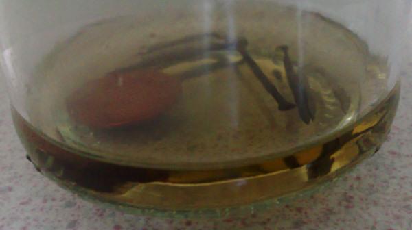

I've drained a little water out of the system and it is yellow / light brown in colour:
I've added some nails an a 1p coin to see if any corrosion occurs (none so far after 10 hours).
The instructions for the Fernox F2 say multiple treatments might be required. Is adding some more likely to help long term, or do the symptoms suggest an alternative course of action?
