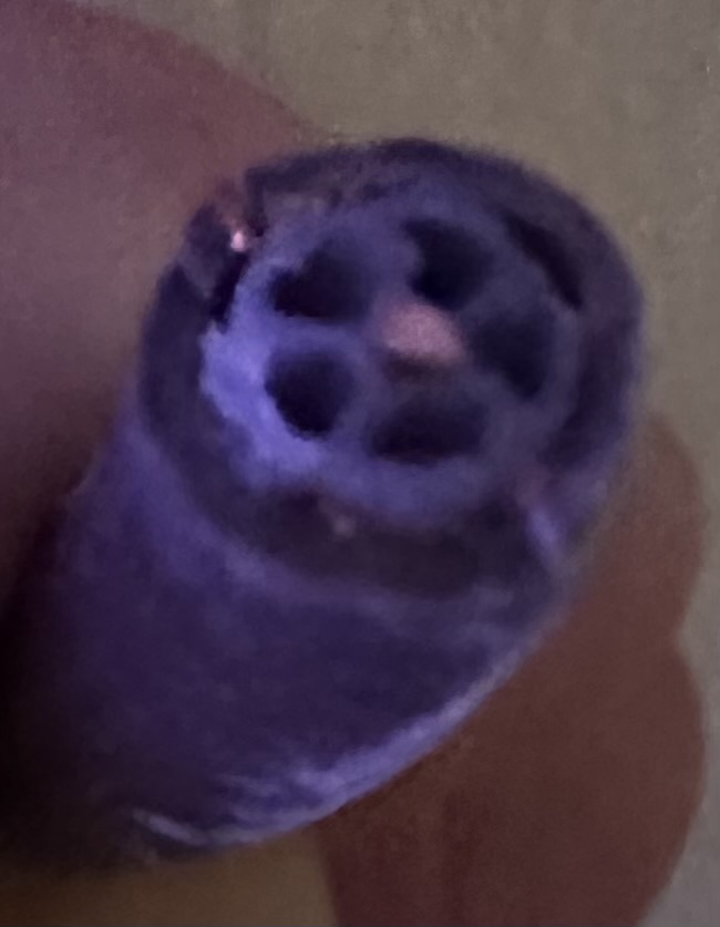

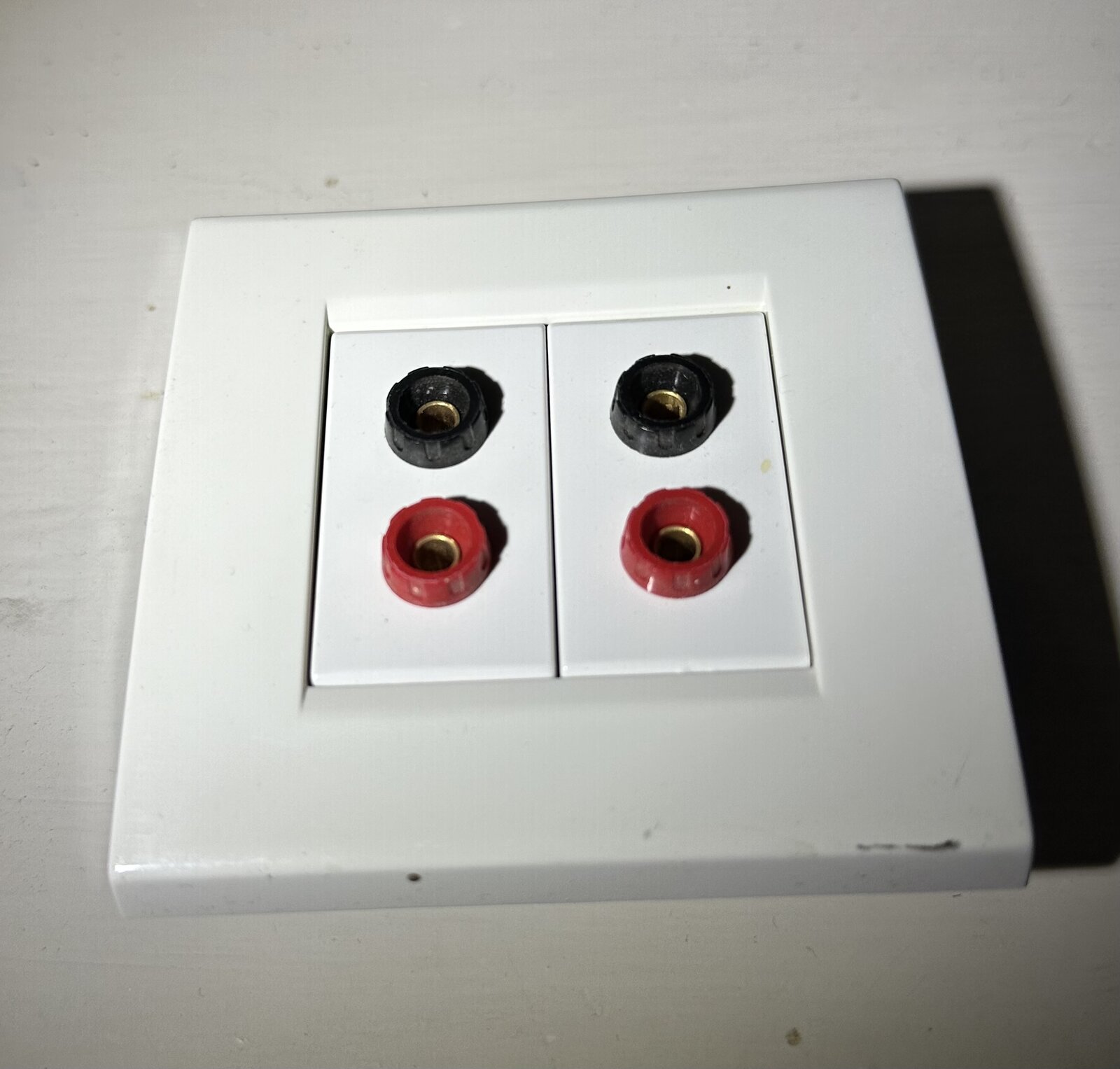

Moved into a new flat where there are two expensive ceiling speakers fitted. Exciting! However, plugged my amp into the speaker socket and couldn’t get any output.

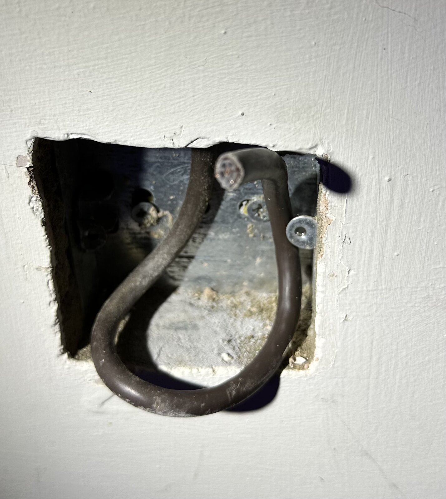

Having opened the socket, there is a cable in there not connected to anything. Nothing is connected to the face plate. It doesn’t look like speaker cable to me… is it coax?
There is no obvious other cabling point in the house. I am fearing the speakers either cabled in, or have been plastered over. Any ideas how I can track them?

I've never cut open a coax cable so don't know what they look like inside, but the single conductor makes me the suspicious it might be. Is there any writing on the sleeving of it? Is it just the single middle conductor, and no conductors in the five triangles surrounding it?
Based on where the box is, could this have been an aerial feed that someone has repurposed for speaker terminals, and just snipped off the existing coax?
May be worth taking the speakers down and seeing if there is speaker wire attached to the terminals and (if they are present) the rough direction they head to. Might be someone has installed the speakers but never got round to running the speaker wire. If there are speaker wires you could look with a cable tracer.
If no slack has been left, the speaker wire might have just slipped up out of the box if someone took speakers down to put different ones in (e.g. swapping their own speakers when moving out).
I think it is air spaced co-ax. There is a copper conductor in the centre, then the plastic fins to keep it centred, then there should be a copper braid of hair-thin wires round the outside, (then sometimes a metal foil wrapping) and then the outer plastic sheath. If looks to me like it has been chopped off. If there had previously been a connector, there would be indentation marks round the outer sheath.
The five triangles are intentionally full of air, not wires. They are just spacers.

Apologies in advance to any electricians here present, but this looks like an electrician's bodge in a new build. Rather than admit they haven't a clue when it comes to AV and TV aerial cabling, they just blunder through trying to wing it with what they know from mains wiring without realising (or caring) that things work differently in other industries.
As long as it looks okay to the QS then that'll do, even if it doesn't work.
The wire behind the speaker socket is indeed aerial coax. We haven't used airspace coax in decades. Foam filled stuff is the order of the day now. I know that some no-brand Chinese factories have started knocking it out a fraction cheaper than the cheap crap 'RG6' normally sold by electrical trade wholesalers. Some sparks will stoop to any level to make an extra penny on the job.
The way it's looped through is common to how sparks run mains twin & earth for wall sockets. I see this a lot behind aerial faceplates in new builds. They just loop a single cable daisychain fashion from TV socket to TV socket.
You might be lucky though. This could be the end of the double cable run to those speakers you think might be somewhere. It's not the right cable type, especially for expensive in-ceiling speakers, but maybe its at least a connection, so you can do a bit of searching.

I would like a peep at the rear of the euro modules first - if there were remains of cable on some solder tags, or if there was no evidence of any connections at all; these could simply be put in place to cover a conspicuous gap! :)
A pic of the 'expensive' speakers would be useful, as would an investigate of any visible wiring at the speakers. As others, that is very cheap coax, not suitable for low impedance speakers.

It'll work in a fashion. You only need two wires for mono, (four for stereo, thus two coax wires). A coax has a central wire, and is surrounded by a metallic threaded sheath, which could act as a second poor quality wire. You just need to take care when connecting the metallic sheath.
