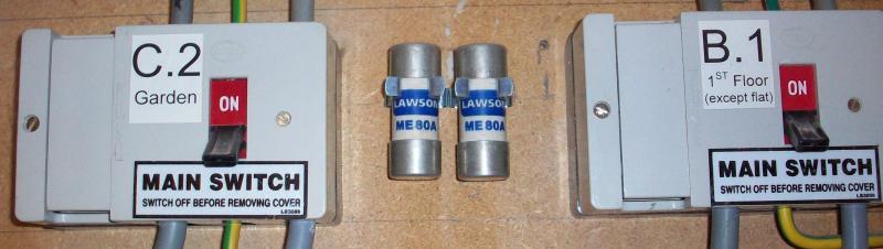

Yes it does have 3 holes and the middle one is the CPC of course, I think (someone add a regulation number please)...
And yes there's a hacksaw slot between each hole. Interestingly we had a project some years ago which didn't have slots on 100A incomer tails but demonstrated that it was still OK according to the engineer who handled the project.

. I have no idea where they would be used.
Cant tell the physical size but they look similar to the ones we use in din rail mounted fuseholders in comercial control panels for fridges and aircon, some of the control fuses can be as low as 6amp maybe lower
They're pretty big - about 57mm long and 22mm in diameter.
Kind Regards, John
Oh for some reason i thought they were them Gg fuses about 8mm and 13mm :oops:
I think your right they do, but ive only seen them as low as 40 amp, i do more comercial stuff so generally see the even fatter ones that we call "Barrel fuses" or the big "J" fuses
Yes the fatter ones are 30mm (Lawson MF) and I think the one in my cutout may be even larger.
