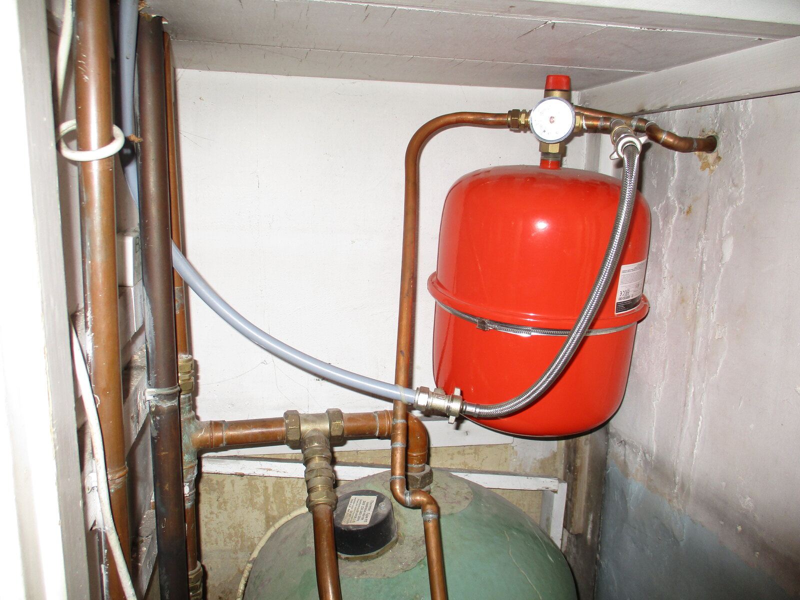

Could you post pics of your airing cupboard showing your cylinder, filling loop and expansion vessel?

Gentlemen, I have attached a photo of the expansion vessel in the airing cupboard. It appears to have been fitted upside down, with the Schrader valve facing the cupboard floor. Apparently (from my Google searches on this matter), it doesn't matter which way up the vessel is, but do correct me if I'm wrong. I do know that it worked fine for the last 4 years). The overflow pipe extends outwards through the wall on the right of the photo. The photo is worth a thousand of my words, as the saying goes. I have three questions:
1) Airlock. Would draining the system
(involving bunging the outlets of the loft water tank and shutting off its ball valve, then attaching a garden hose to the outlet valve of the ground floor hall radiator, then opening the outlet valve, then opening the bleed valves of all the radiators, then waiting until no more water flows out of the other end of the hose),
followed by refilling the system
(involving, shutting all the rad bleed valves, then unbunging the loft tank outlets and freeing its ball valve, then going outside to the free end of the hose and allowing water to flow for ten minutes, then shutting the ground floor hall rad's outlet valve & decoupling the hose, then bleeding all the rads, ground floor first then 1st floor),
cure any airlock problem which could be impeding the repressurisation? If you have a better method then please give details.
2) Does the photo lead you to conclude that there is another more likely possible cause than an airlock?
3) With the expansion vessel upside down, what air-pressure should I aim for, after connecting a bicycle pump to the Schrader valve?

1 What a fugly way to install a filling loop! Not necessarily wrong but little effort by installer.
2 I was hoping to see a bit more detail on the valves at each end but these are facing away in the the photo
(and from the user).
3 To answer the original question: the weight of the hanging loop may have flattened the the internal rubber of the braided loop near the top connection.
@polesapart
Thank you. I quite agree that the installation isn't a pretty sight - the installing plumber was a Checkatrade man, and came highly recommended. This same man, banged into the rusted steel loft tank, and managed to make a penny sized hole in it, water seeping down, wallpaper & carpets ruined etc. Had to get in another plumber to replace the tank with a plastic coffin. It just goes to show how unreliable Checkatrade recommendations can be!
The main problems with the installation are (1) Impossible to see what is the pressure setting on the red top PRV adjustment knob (on top of the expansion vessel) (2) have the expansion vessel upside down traps the water inside it, when draining the system (3) difficult to extricate the expansion vessel in order to empty it of water and pressurise the air content.
There doesn't appear to be a kink at the top of the braided hose. The grey flexible PVC hose is fixed to inverted 'L' shaped copper tubing with a cable tie. I pushed the cable tie up the copper tube, thereby raising the braided tube, 10 minutes ago. It made no difference to the shut down heating system.

5-10 mins of mains water flow isnt normal to top up a pressurised ch system.
It should take seconds.
You should only be topping up a very limited amount of fluid or pressure loss.
So either, you have a massive leak (you don't because your pressure would drop instantly) or, what you think is happening when you top up, isn't. I can only think that the mains water is ****ing out of the PRV or back filling up this tank in the attic (past overflow?).
Or you have a ruptured expansion tank and water is going into the hw system or whatever.

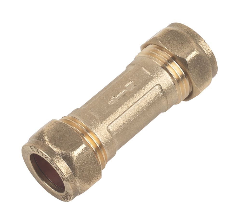

Backfilling is possible. But how to check this and more important how to prevent this?
I tapped the upper and lower parts of the expansion tank. As you would expect, the airfilled lower part sounded hollow while the upper part sounded full of water.
EDIT: After googling I found that backflow can be prevented with a check valve, like this one:
Is this right?
