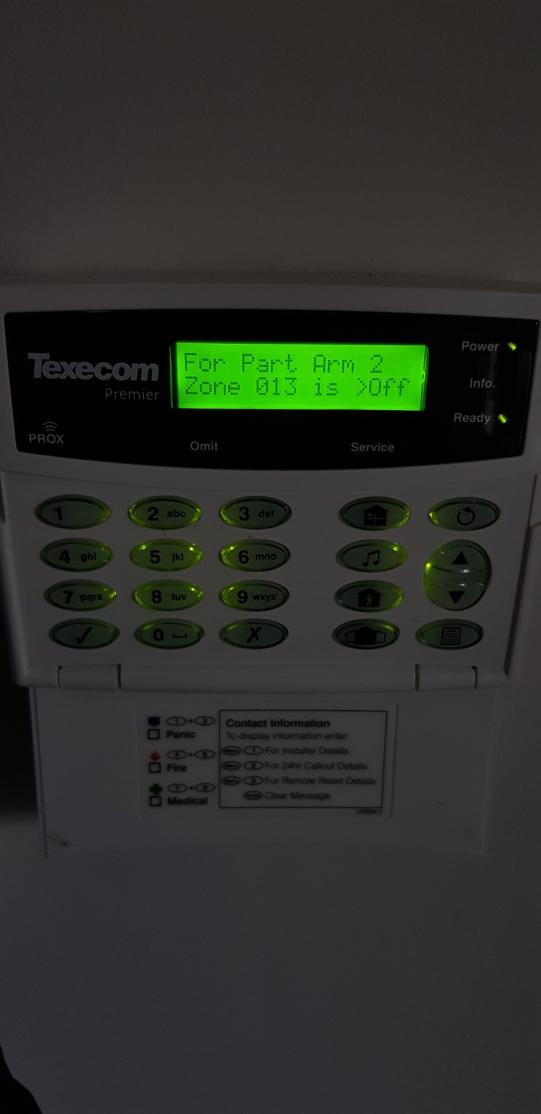

I've set a night time part set which excludes all PIRS minus the front and back door, that works fine.
I've just tried to set a 2nd part set to exclude one PIR where my cats sleep but I still want to leave by the front door so want the guard PIR in hallway and the front door to allow entry exit with normal count down, that's the bit I'm stumped at, how do I allow that?

Part 2 omit ...all the zones you want off in programming ..then press part scroll down to part 2 then yes ( 3 parts available) when setting

I chose which area I want off. But there were no other settings I saw about allowing entry exits to be used.

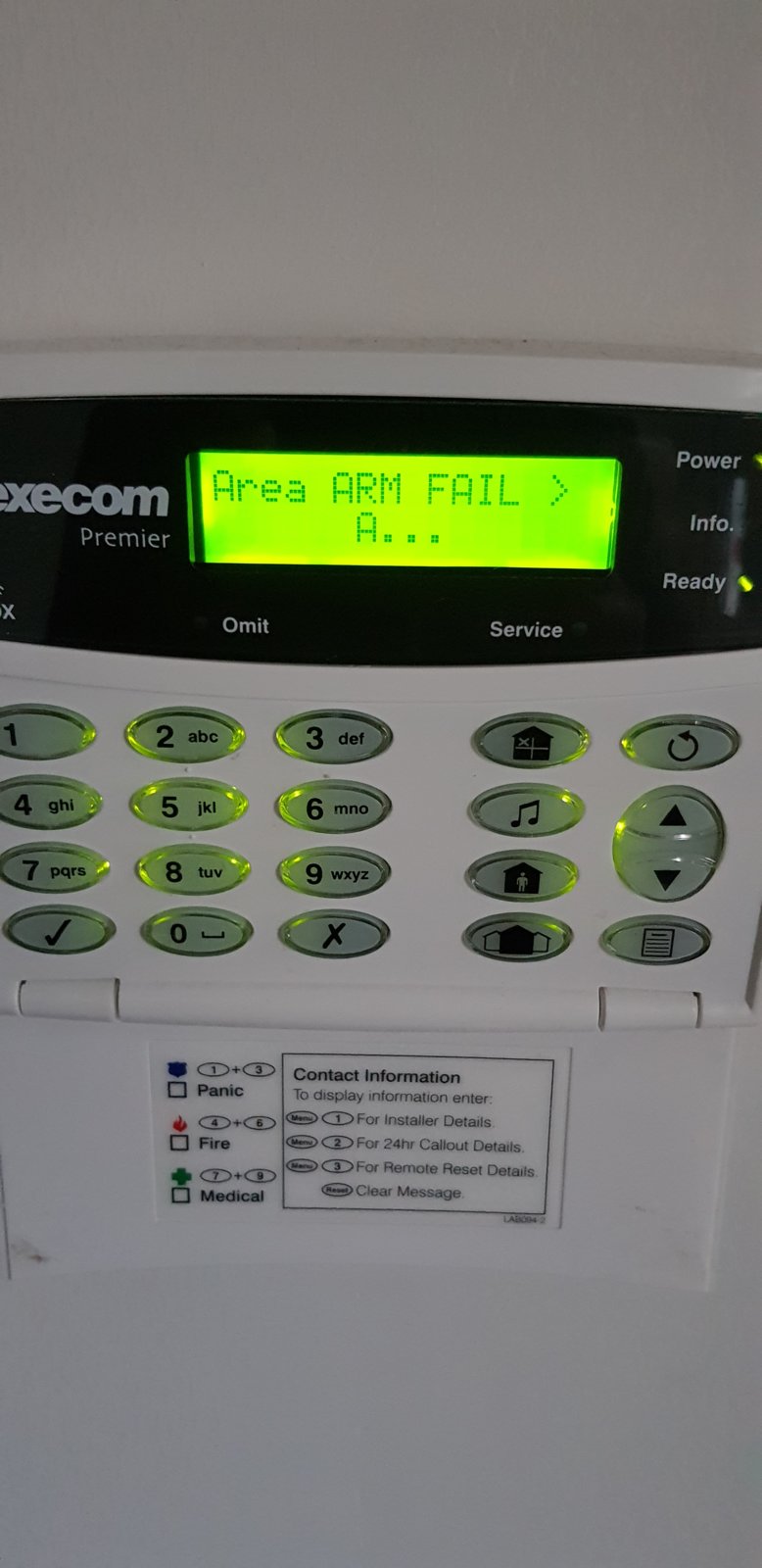

When I set the alarm by pressing part, 2, tick, I then opened the front door and alarm when off and displayed the alarm fail Info?

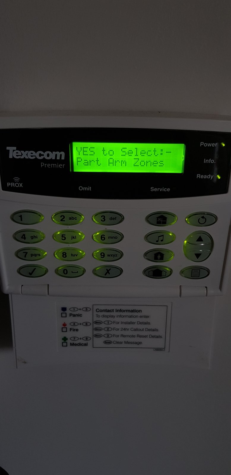

it can be done in master user also (or used to)
I prefer using zone setup, but given some of your responses I would try the alter part arms as less to mess up.
in alter part arms, press chime, omit or part to change between part arms 1, 2 and 3.
zones you want to work during part set on should on and those you don't want to work should be off.
Perfect, thank you for helping, I didn't realise it could be done in user too.
I've done exactly as you say but the entry exit on the door doesn't work, it's like the door is set to go off when triggered.

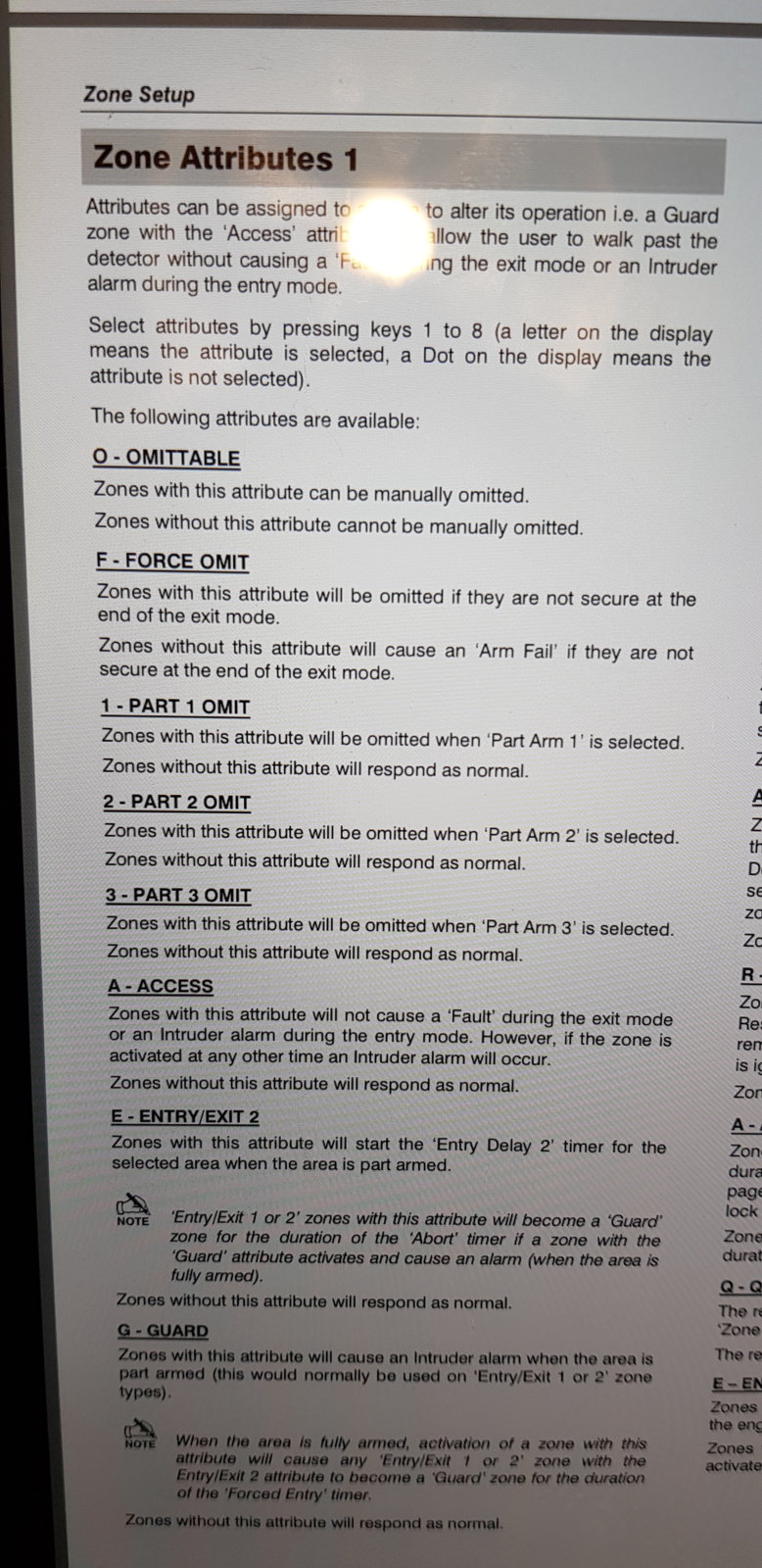

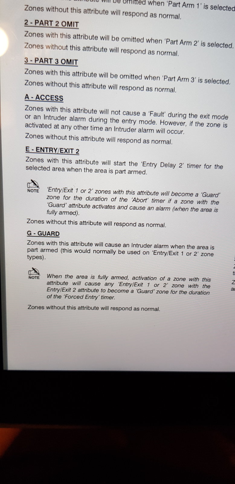

What attributes are selected on the door ?.....is it going off when you re enter or is it going into arm fail ? Also do you have a dectector near the front door and what is it set as ( zone type )

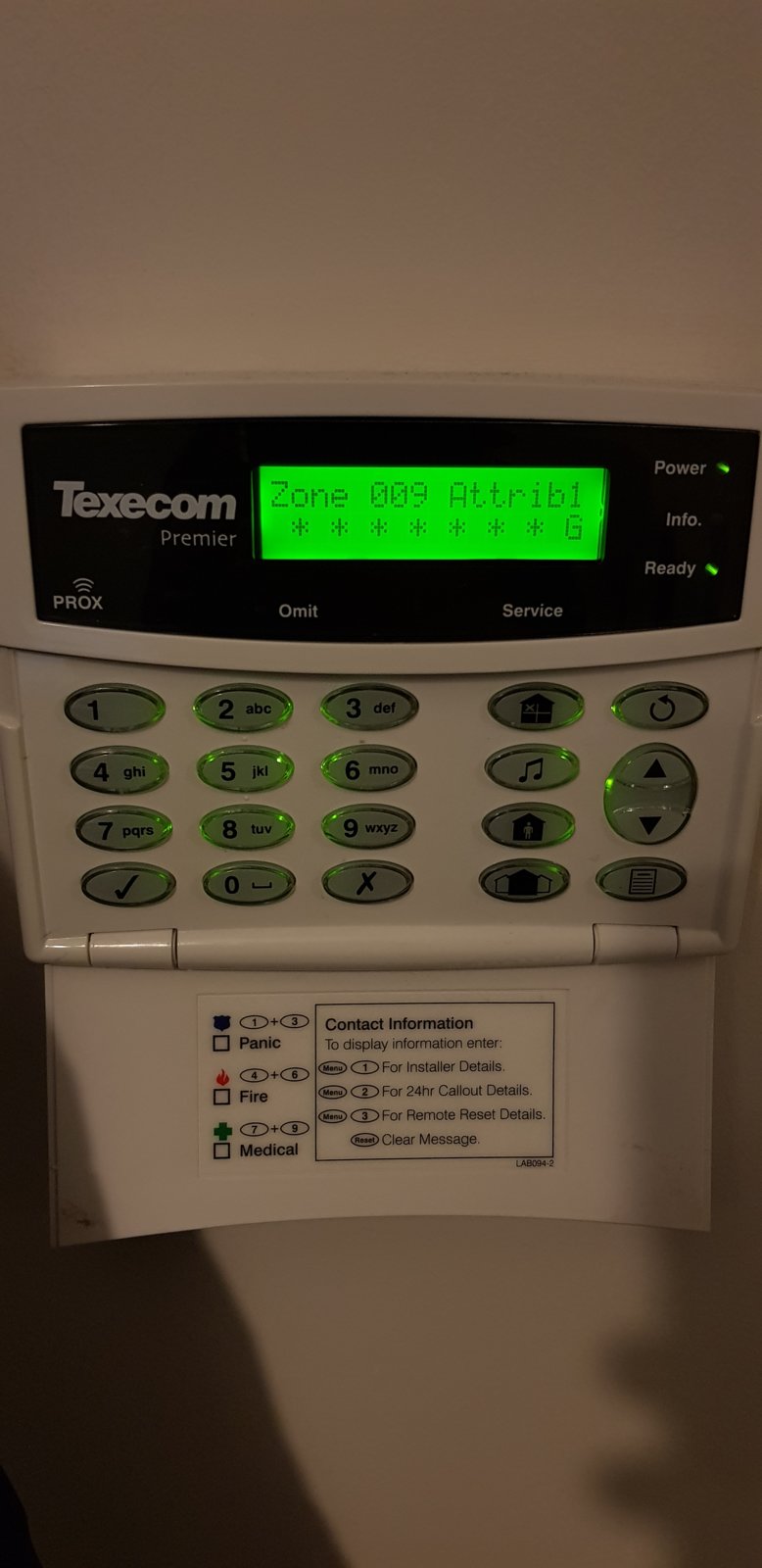

Ok, attributes, forgot about that. So this is the door

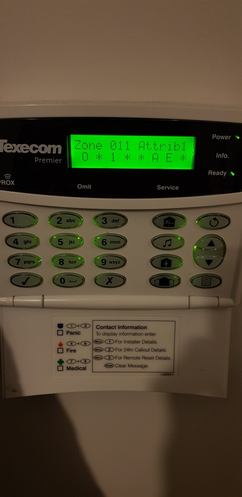

This is the PIR in guard access in hallway
