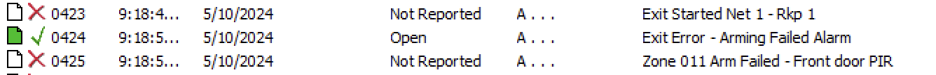

I have self installed the Texecom alarm system and have installed a few but struggling with arming error. 75% of the time it fails to arm and looks like the PIR on exit is causing the issue, I can arm remotely and have no issues. Checking the programming and cross referencing with previous setups all looks correct.
The PIR is set to guard access and alarm is set the Entry/exit on the door contact.

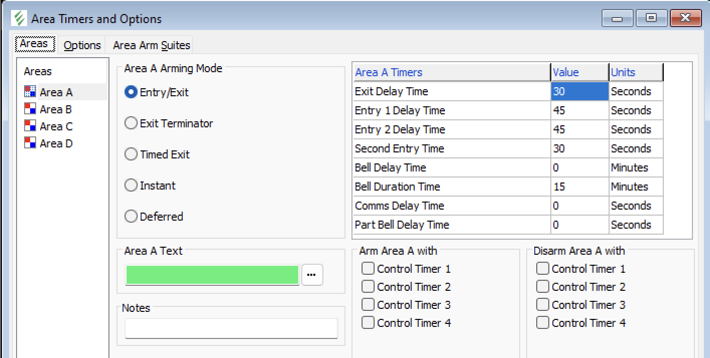

What is the exit settle time set to?

To set the alarm i use keypad 1 this is next to the front door, I open the front door so the front door contact will be open and then set the alarm. Close the door but then you can hear the alarm does not set. PIR 11 which is the one showing the arming fault is above the front door.
The logs just show PIR 11 is causing the error but nothing else shows up that i can see.
Exit Settle time 8 Seconds

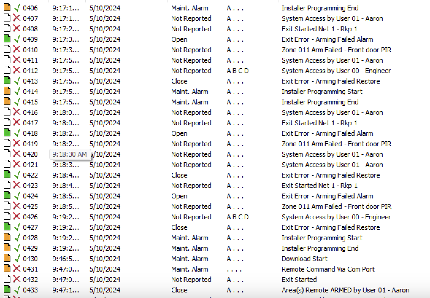

Nothing in the logs to show PIR's active
you can see it’s failed due to pir 11

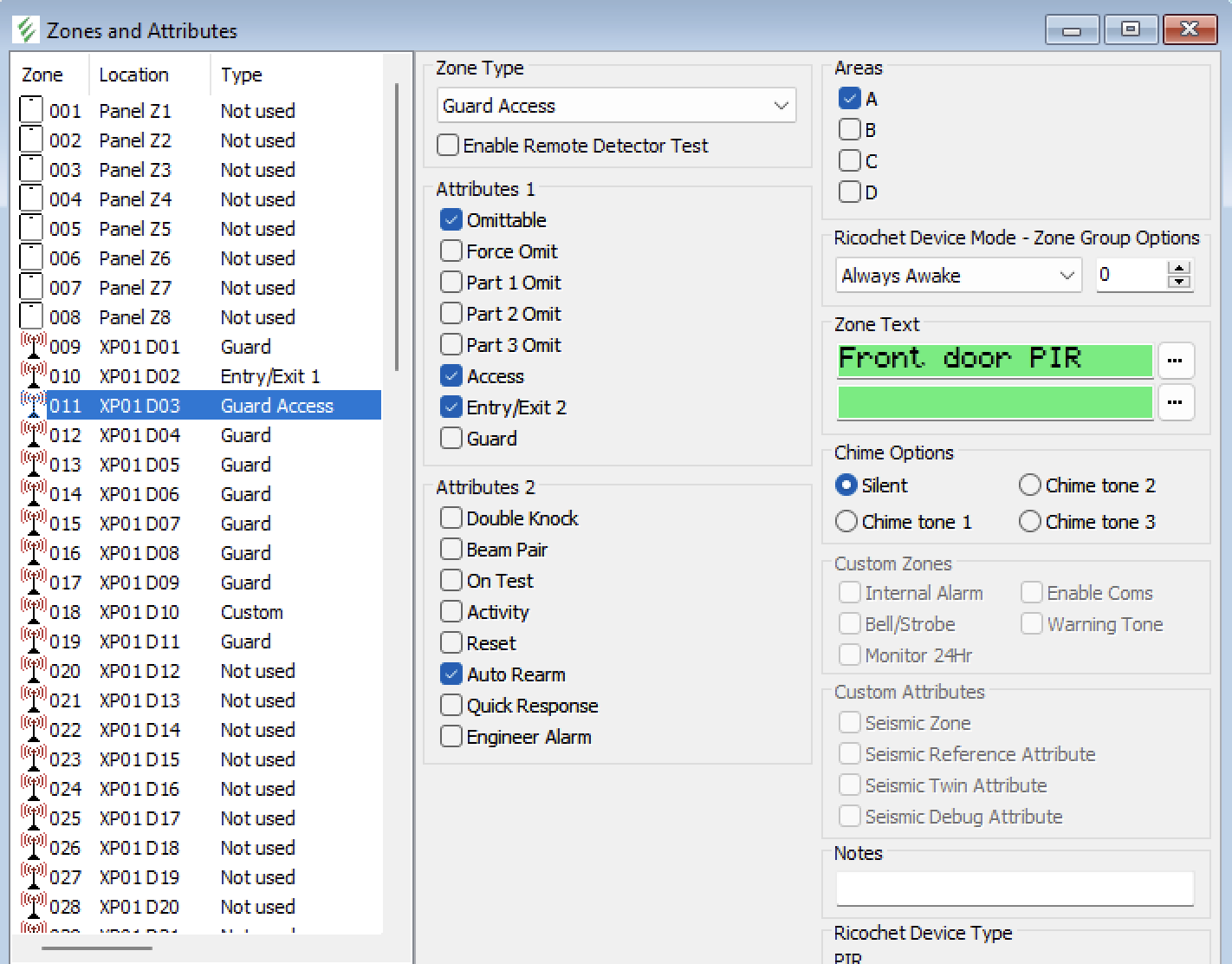

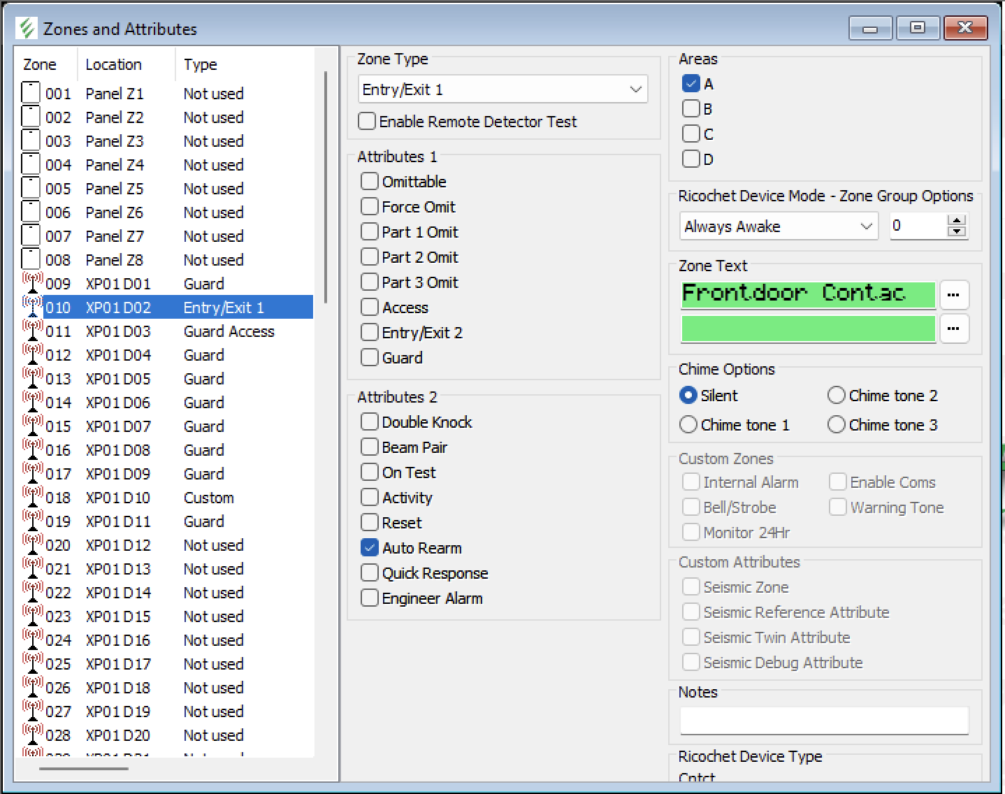

Okay just gone back through the screen shots of PIR set up.
It appears you have changed the mode of the PIR to always awake it needs to be set to auto.
Contact and and shocks always awake, pirs auto DT hybrid.
Didn’t notice that earlier having a pir to always awake will run you device batteries down very quickly.
That said if putting it to auto does not fix the issue speak with Texecom for advice.
To be fair having a q20 on always awake should not be an issues as the zone programming of guard access should take care of how the zone behaves and that also needs flagging to Texecom .
Okay so the order to do things.
1. Change mode to auto
2. If that doesn’t work fry the force omit
3. If that works you can take the force omit off and increase the exit settle time to say 20 instead of 8.
4. If still struggling put the zone to not used and then delete device off and then relearn re program zone from keypad etc
5. Area A doesn’t appear to have area text and it’s recommended that it does when using the app.
Even if it works on auto, I would contact Texecom regarding the issue.
By putting the PIR to always awake it should act like a normal hardwired PIR and the zone programming of guard access it should behave. Correctly and it isn’t this could be a quirk of how the wireless modes work and it could do with tweaking but it won’t be a priority if it works in auto mode.
