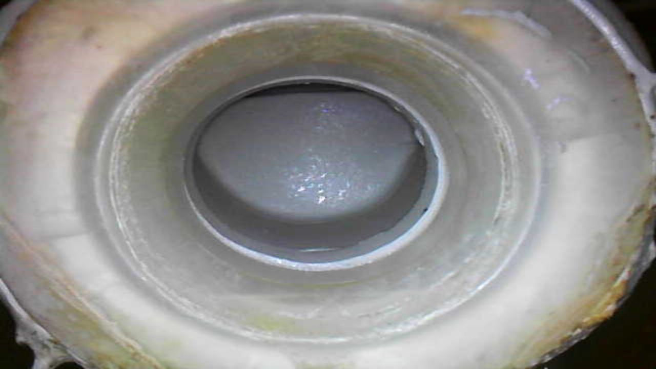

On Tuesday, before I replaced the flush cone, I took a photo with my endoscope. Does this 'wall' of porcelain inside the pan suggest it's designed to hold the water in this way for some reason?

I did have a toilet once where parts from the syphon came off and got stuck in the toilet inlet where the flush pipe goes. You might need an endoscope to look further in.
Andy
You're right - I need to take the pipe and cone out and have another look with my endoscope. The cistern has a bit of light limescale but nothing that would block the flush pipe. I have a funny feeling the pan was just designed this way.
Given that even the new seal is leaking I guess the pan hole needs cleaning up so I'll do that at the same time. Access is awkward and I've never been much of a gynaecologist.
You can't have enough fall on the flush pipe ,if that amount of water is being held. With regard to the leak ,pack in-between the fins of the flush cone with plumbers mait putty ,it won't leak anymore !!
