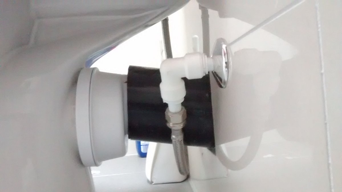

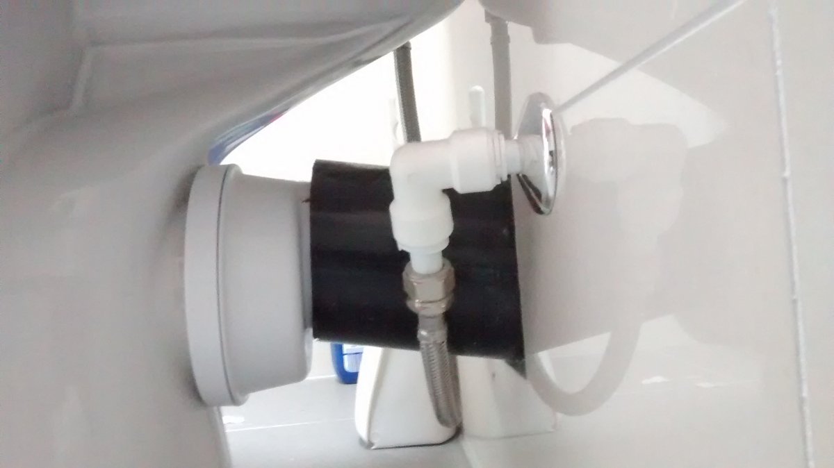

Looking at your photo, it appears the black pipe comes up at an angle out the wall. This may be kicking up the pan connector, causing it to back flow into the pan. Perhaps try shortening it, fit a new long pan connector, and see if that makes a difference?

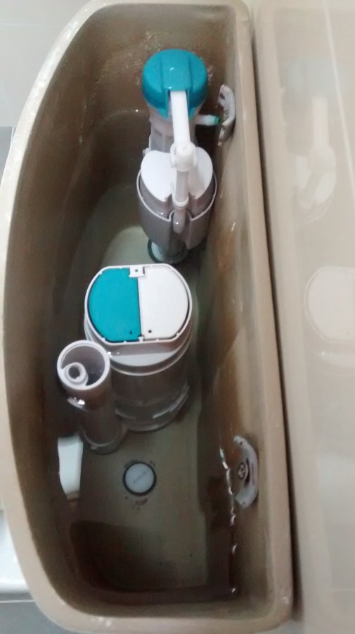

OK, a photo of the inside and back .... and if possible, a short video ....
video of flush not possible ....
I turned the twisty thing at the top to alter the amount of water than can enter, Did not make any difference, but did not try too much.,
+1. That pan connector is restricting the flow and its the soil pipe behind it in the wrong position which is the problem. As its a loft conversion, is there a void behind the wall? Adjusting the position of the soil pipe may be relatively easy and allow a straight pan connector to be used.
So, the white part is the pan connector, black the soil pipe? I never really looked before - assume the white bit was part of the toilet. So, maybe it would work better if it was the other way round, with no rise before the black pipe? That makes sense.

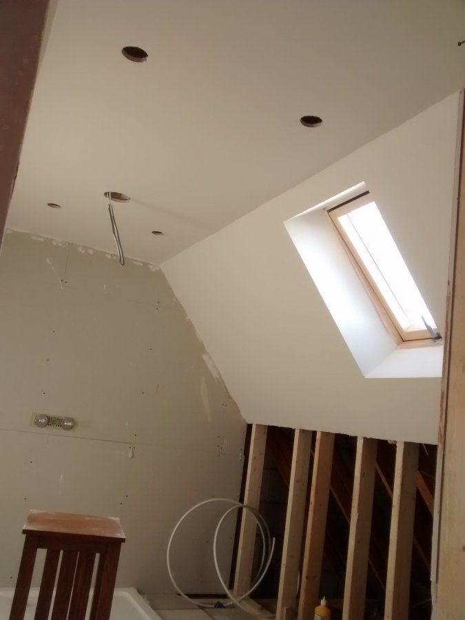

Pic I took when I painted before the tiles were doneIMG_20151101_125230285.jpg
It would be best to remove it, it`s trying to divert the water flow up for a start and the outlet is smaller, no wonder you were having problems.

From your pictures I strongly suspect the soil pipe angle and offset is the problem.
It looks to me that the plumber has used an angled Tee (probably 87.5°), which is why the black soil pipe 'kicks up'. He may also have run the soil pipe over a joist, hence its high position.
I would try to cut the soil pipe off close to the wall using a wood saw (to reduce the kick up), and then fit a straight, but longer pan connector in place of the offset connector that you have now. Pan connectors are readily available from DIY emporia.
If there is easy access to the void behind the walls, (there should be,), you may be able to replace the Tee with a 90° part.
