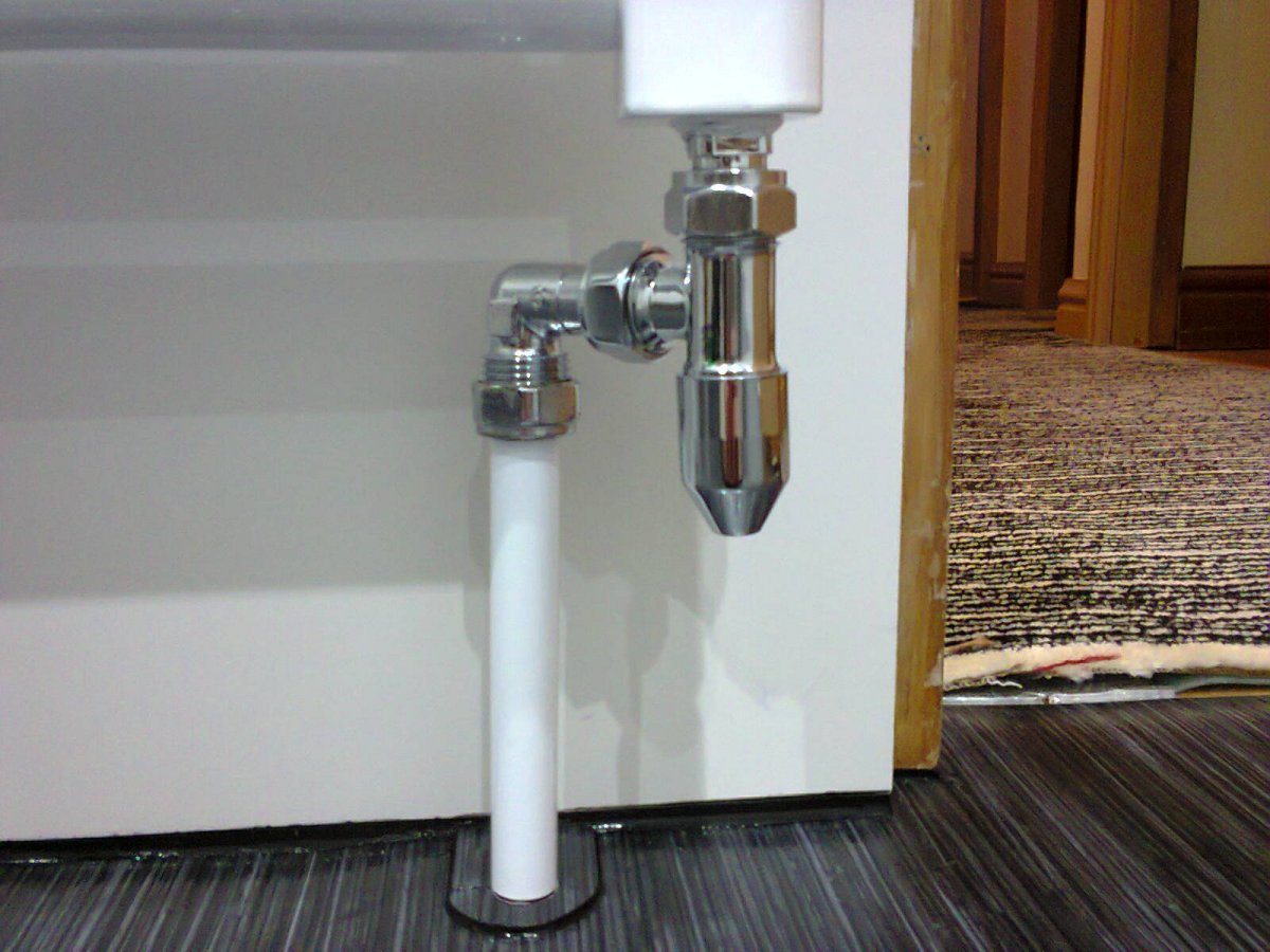

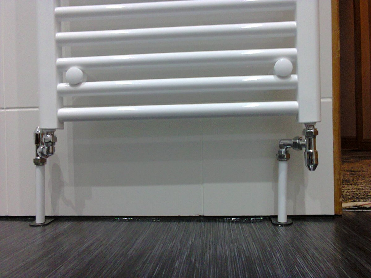

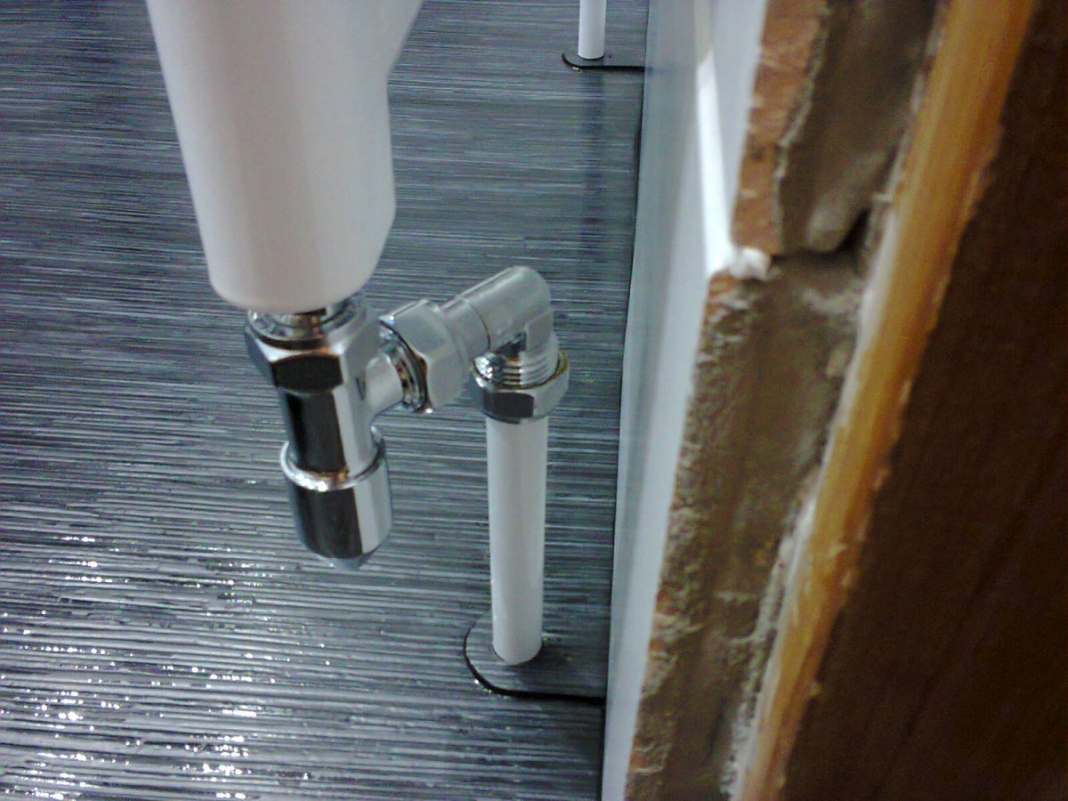

Ok I have now done the job and here are the pictures, I needed to go out but because a elbow and a valve added up to further than I needed to go I had to go to the right to take the extra but because going to the left right would mean getting closeer to a loo i could only go right but as there was a door i needed the valve to be pointing down, hope that all this helps some one else in the future, it was finding the compression street elbow that was the key to a neat job I think
