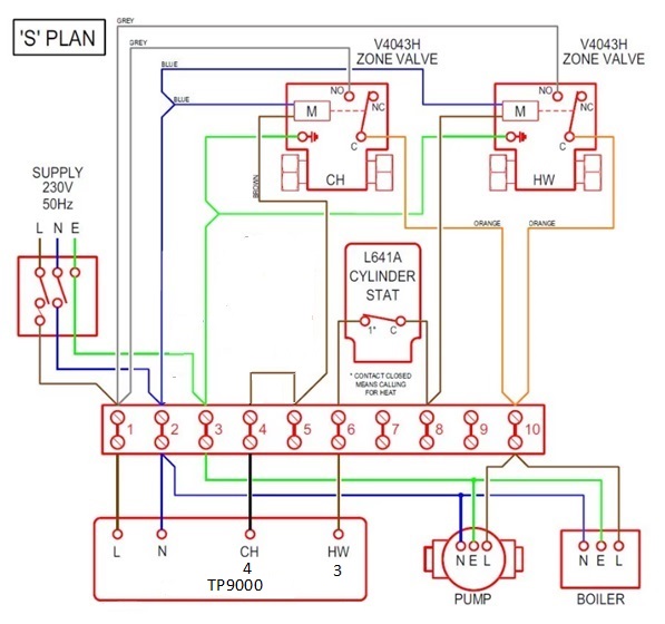

hi, I have a Danfoss tp9000 with a remote sensor for the heating can anybody tell me how this programmer and sensor are wired to an S plan system using a Honeywell 10 terminal junction box?

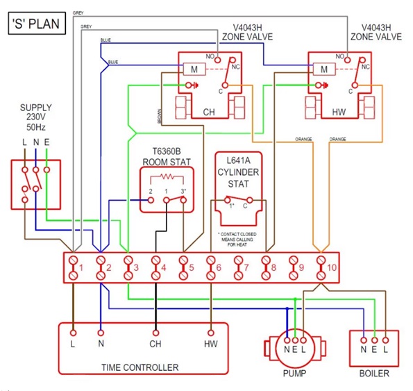

That's a good question and the answer in reality is: According to the preferences of the original installer and the location of the various parts of the heating system in your home. It may also change if the system has been modified, extended or updated at some point.
Having said that, the generic installation is as below. Often now the boiler requires a pump overrun so the pump is wired directly to pump terminals provided at the boiler, instead of as shown below.
The Danfoss TP9000 corresponds to the TIME CONTROLLER shown above and the terminal marked CH corresponds to Danfoss TP9000 terminal 4 (ON HTG) and the terminal marked HW corresponds to Danfoss TP9000 terminal 3 (ON DHW) Terminals 1 and 2 won't be used with an S-Plan.
You won't have the room thermostat as the TP9000 has this built in so wiring centre terminals 4 & 5 would be linked.
DANFOSS TP9000
The question I have is why are you asking? If you are planning on changing the Danfoss TP9000 for another device or smart thermostat, then it's can be done without disturbing the TP9000 connections at the wiring centre.
The sensor would normally be wired straight to the TP900 terminals 5 & 6 as shown above.
Here's a modified drawing showing the TP9000 terminals marked and without a room thermostat. There may be a link between the wiring centre terminals 4 & 5 as I've shown, or more likely, the wire from TP9000 terminal 4 and the brown wire to the CH Zone Valve may simply just be inserted together into the same terminal.
