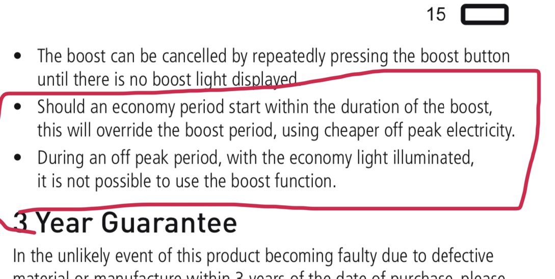

I'm wondering if I can run two immersion heater elements (3kW each, so 12.5A each) on the same circuit? Getting another circuit upstairs will involve drilling through a 300mm high density concrete slab - which I'd like to try and avoid...
I don't think I can have these both powered up on the same circuit at the same time (MCB is rated to 16A, cable is 32A (I think), and the timeclock after the fused spur is only 16A). And that doesn't bother me - happy to only run one at once.
So it possible to have these wired up so that they can both run on the same circuit, but so that only one can run at a time? Any risks in doing so?

So there is no issue running both immersion elements off the same circuit, provided they're controlled not to come on at the same time?
Am I right in my assumption that I definitely could not run both at the same time? (Therefore I want to make sure I find some foolproof way of ensuring that this can't happen).
Re-measuring the cable, I think it might actually be 2.5mm T&E, so only 20A. Therefore imperative the two units do not operate at the same time - however, I'm not sure how to achieve this in a way that is somewhat foolproof (i.e if I forget to turn off the top element it will automatically turn off when the bottom element comes on on the timer).

Okay, that timer (or similar) looks like an option - thanks. It's not explicit in stating that the boost element would automatically turn off when the normal element turns on, though. Although the setting of the boost time should help in that respect.
Yeah, basically cheap rate at night.
Ok.
I am not actually sure whether it does or not, but the boost is only a maximum of two hours so you are unlikely to switch it on at 10pm.
You can't set the boost time; you have to switch it on.
Just to add - when the boost switches off (after max. 2hrs.), the device does automatically switch back to the main timer.

The instructions for the following unit actually seem to suggest that it would not be possible to run the two elements at the same time, My fears of potentially overloading shouldn’t be a problem.
https://www.tlc-direct.co.uk/Products/SMTRTM7N.html
Well done.
Definitely knew it would not run both at the same time; just wasn't sure which would take priority.
