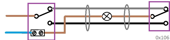

With Live and Neutral looped at one switch this arrangement works but still needs 3 core plus Earth from the ceiling rose to each of the swiches View attachment 266876

It's been a long day, can hardly think, so need to know exactly what you have at each switch.
The cable at the external door, which you cannot identify, could this be an outside light cable? Or an under unit light cable?
You state you have a live (and neutral?) feed at both switches.?
If so, this means you can effectively rule out one of the 'strappers' - as one of the strappers can be a permanent live. So the 2 core cable can consist of a common wire and a (switched) strapper wire.
I'm only going by the rather limited info you have provided, but it looks fairly hopeful.
I don't imagine it was miracously designed like this, I suspect there was a balls up, and 2 core was put in for the 2 way because the bloke was an idiot - but it sounds do-able - ASSUMING both switch feeds are on the SAME circuit.

Out of interest, how would you introduce two way switching without placing a new cable between the two switches and all that would entail?
Well - I assumed you had a cable (albeit only T+E) which you could have used, with a bit of unconventional wiring.
But as you don't appear to have that, it's unlikely to be possible now, unless you access above the ceiling - where are few 'unconventional' junction boxes could be installed to alter the use of the wires.
For example, where you have a bunch of neutral wires in the switch, these could be diverted and reconnected as the two way wiring.
Complicated, time consuming, and likely to be frowned upon by others, but there you go.
