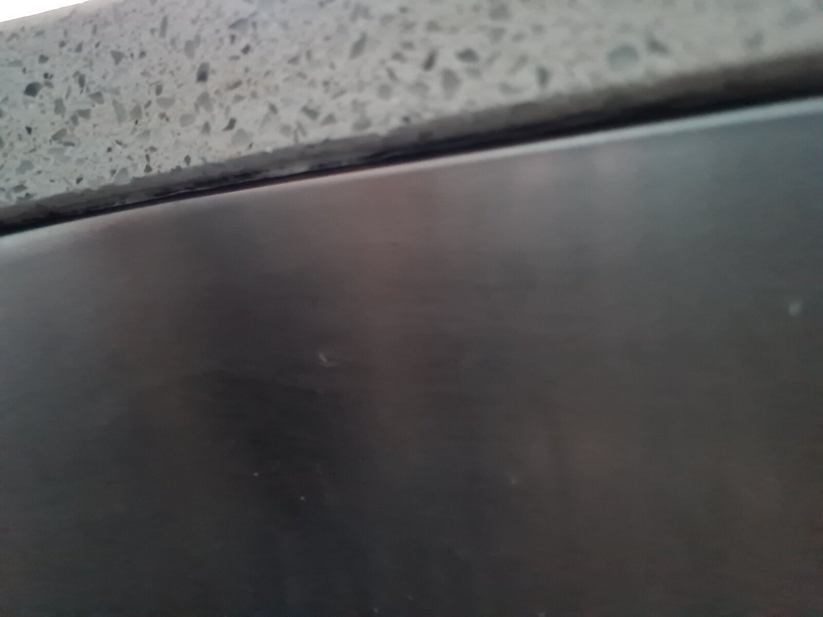

Hi, the silicone on my undermount kitchen sink is 3 years old and is black from mould. No leaks but wondering if it should be replaced. I've tried cleaning it with bleach & with vinegar but nothing seems to shift it.
It's a stainless steel sink & wondering if the whole sink would need to come out, silicone taken off & then resiliconed before refitting (on which case I'd get a plumber in) or whether I can scrape it out & then reseal without taking it out.
It doesn't seem to have any clips on the sink holding it in place so I'm guessing it's adhesive that's holding it in.
Looks an awkward gap for getting a silicone nozzle into so any tips would be gratefully received.
I've attached some photos to show the problem.
Thanks.

When you say 'an awkward gap for getting a silicone nozzle in' do you have the long cartridge guns in mind? If so, you can also get silicone in toothpaste-type tubes which ought to be fine for manoeuvring around the inside of the sink.
If it's not clear how the sink comes out I think I'd be looking to scrape out what I could of the old silicone and reapply, perhaps filling it more to reduce the quantity of water that can hang around at the interface.

Hi John, there's no support underneath at all but there is adhesive bulging out from the underneath of the sink edge where it's glued to the worktop.
The reason why I say that is looking at the pictures (pic 4) it doesn't have the typical look of white/clear silicone that's gone black, it really looks like a black adhesive. That being said pictures can be deceiving sometimes.
I know what you mean - it's just gone very mouldy as it's an awkward area for catching water/food etc

Because it was not filled to the edge with silicone its just trapping water in the gap between sink and worktop, hence mould grows.
I wonder if it was maybe done that way to keep it out of view? So I'm guessing if I redo it I should fill it more to the edge.
Definitely fill all of the gaps with silicone - any water which can run underneath will come back to haunt.
There is a substance called silicone remover which tends to dissolve the stuff and it works to a degree, but usually leaves a gooey mess. It could be worth a try I guess.
