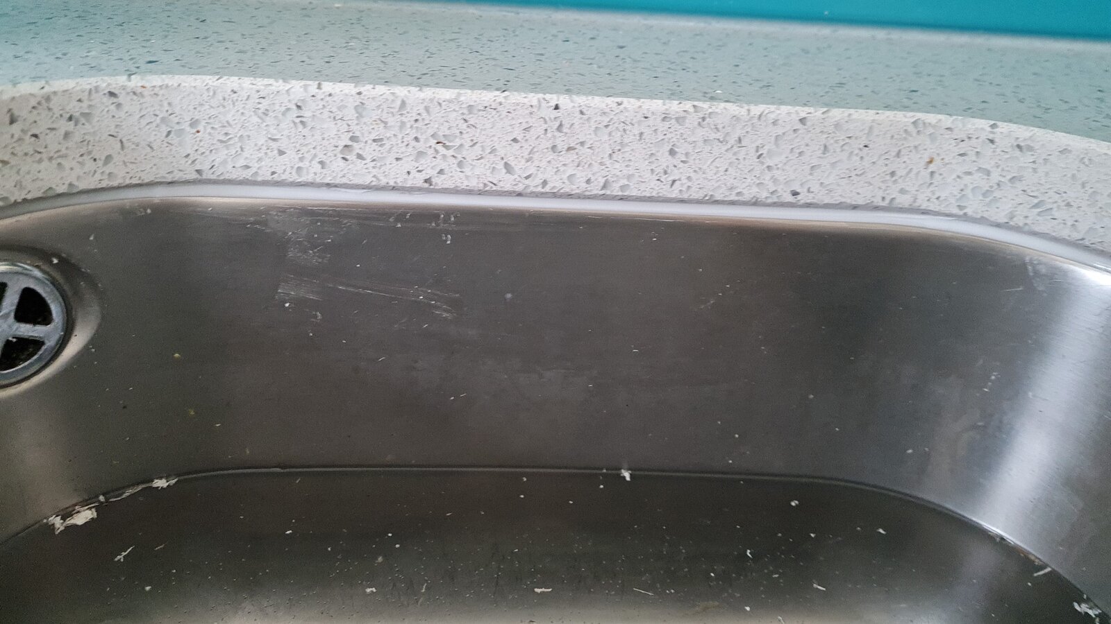

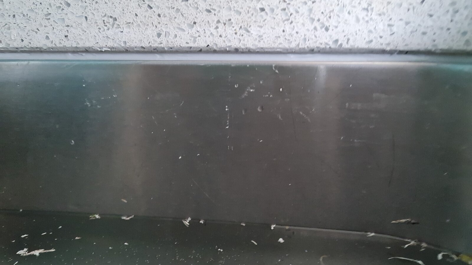

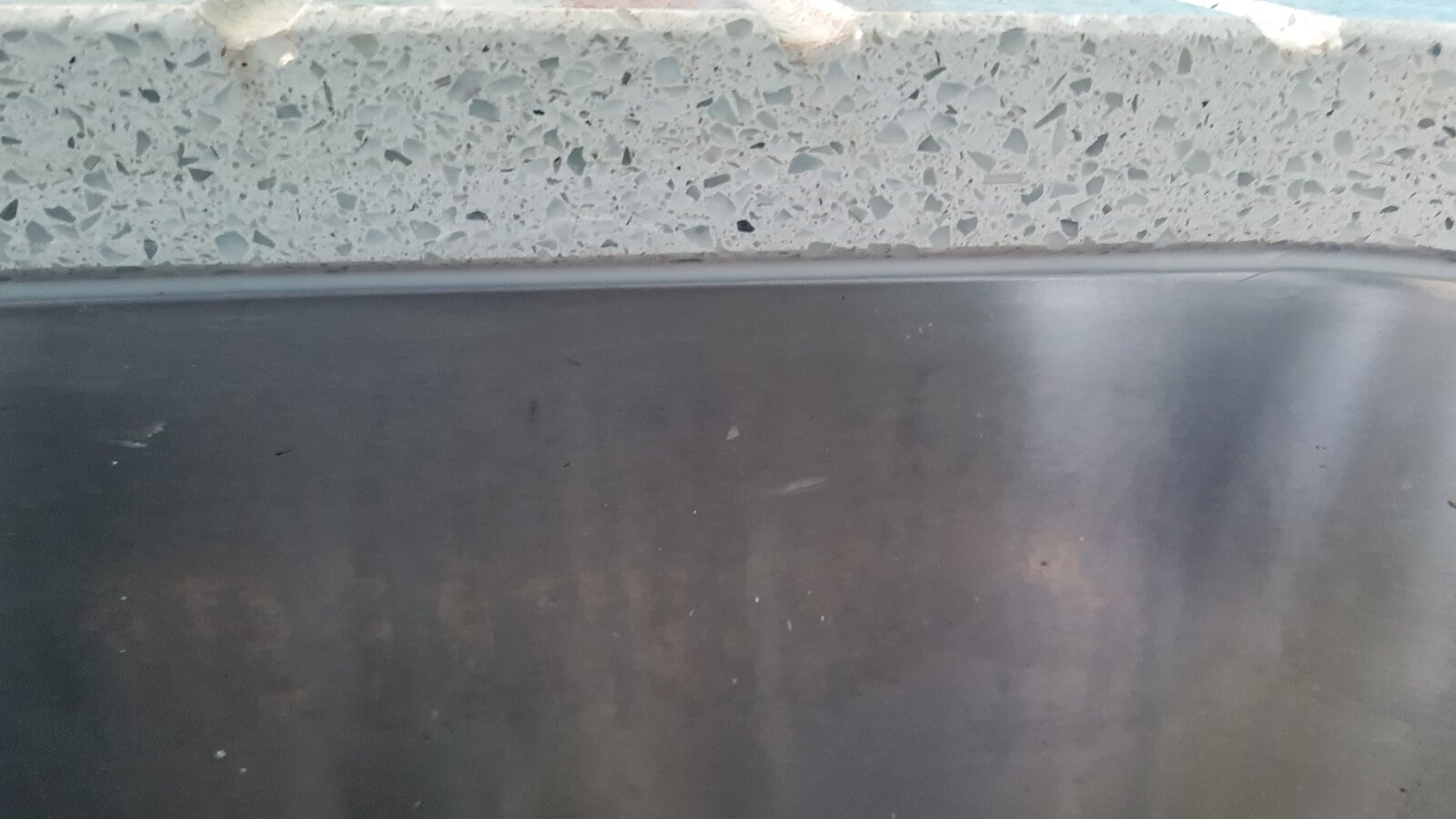

Wee update - bit the bullet & scraped out old silicone & resealed today (took me hours!) Used my best buy of late - a fugee kit which I can't recommend highly enough. What a great finish it gives. Ignore the messy sink - full of old silicone. Thanks for all the advice. Much appreciated.
Thanks - fair chuffed with myself. Now just got to try & keep it white!
