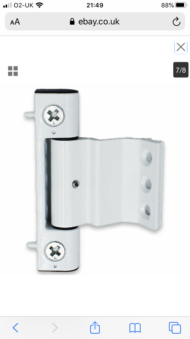

My parents front door has a tendency to pop out of the jeep when pushed close which then involves lifting the handle to engage the latch and keep it in position.
May be different on your door but the hinges that attached to the door have three screws into the side of the door. I found they had worked slightly loose and was able to tighten them up which helped.
May be worth a look
May be worth a look
Yes the hinges on our door have needed adjusting recently but the door is now level in the frame (at least it looks level), but it is still not closing properly :0(
It isn’t then adjustment screws it is the hinge mounting screws. Their door was also level but having tried the usual methods I tried the mounting screws and it must have pulled the door slightly which made the difference. I have attached an image which shows the mounting holes where the screws locate. As I say may not be the same but worth checking
