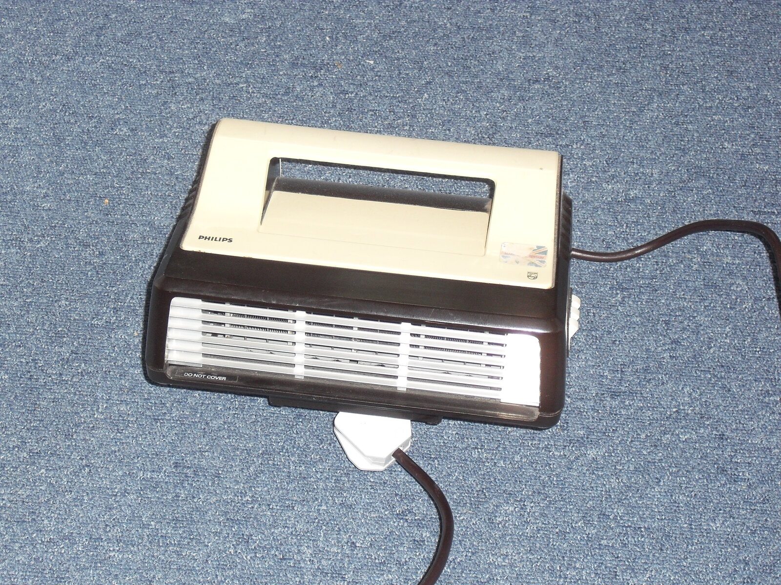

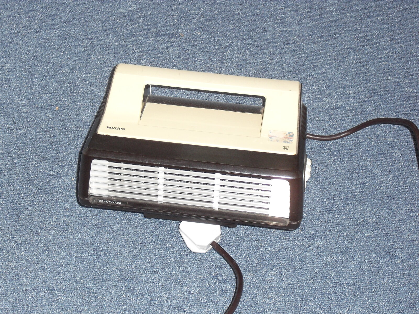

As it happens I have this heater:
Several years ago the fuse in the plug blew and Sunray being Sunray guessed the fuse had aged (let's not get into that arguement) and replaced it along with the plug as the fuse holder had gone very soft. It worked on low power which is how we tend to use it and it seemed the problem had been fixed.
Next time it was used on full power the fuse again blew after 15 minutes or so.
I checked the resistance and the 1KW element was far too low, I can't remember the values but it low was enough to be well over the 13A then adding the 1.5KW was plenty to blow the fuse.
The fault is simple, the element is horizontal open wire, some had sagged and shorted onto the lower part. I'll make the guess the airflow had been obstructed at some time and the element overheated enough before the trip popped. However it is too brittle to repair, so the solution was to remove the wire from the 1KW element leaving just the 1.5KW.
I had something similar with a tower fan heater repair, the open element was in the form of a spring running vertically, there were several mica supports holding the element every 2" or so which had broken (I suspect it had been dropped as the base was broken too) the element had sagged and about half of it was in a tangle at the bottom.
I realise modern ovens seem to use enclosed elements but that's not always been the case, certainly fan heaters and tumble driers still use open elements and I'm not aware of any reason it should not also be the case for ovens.
