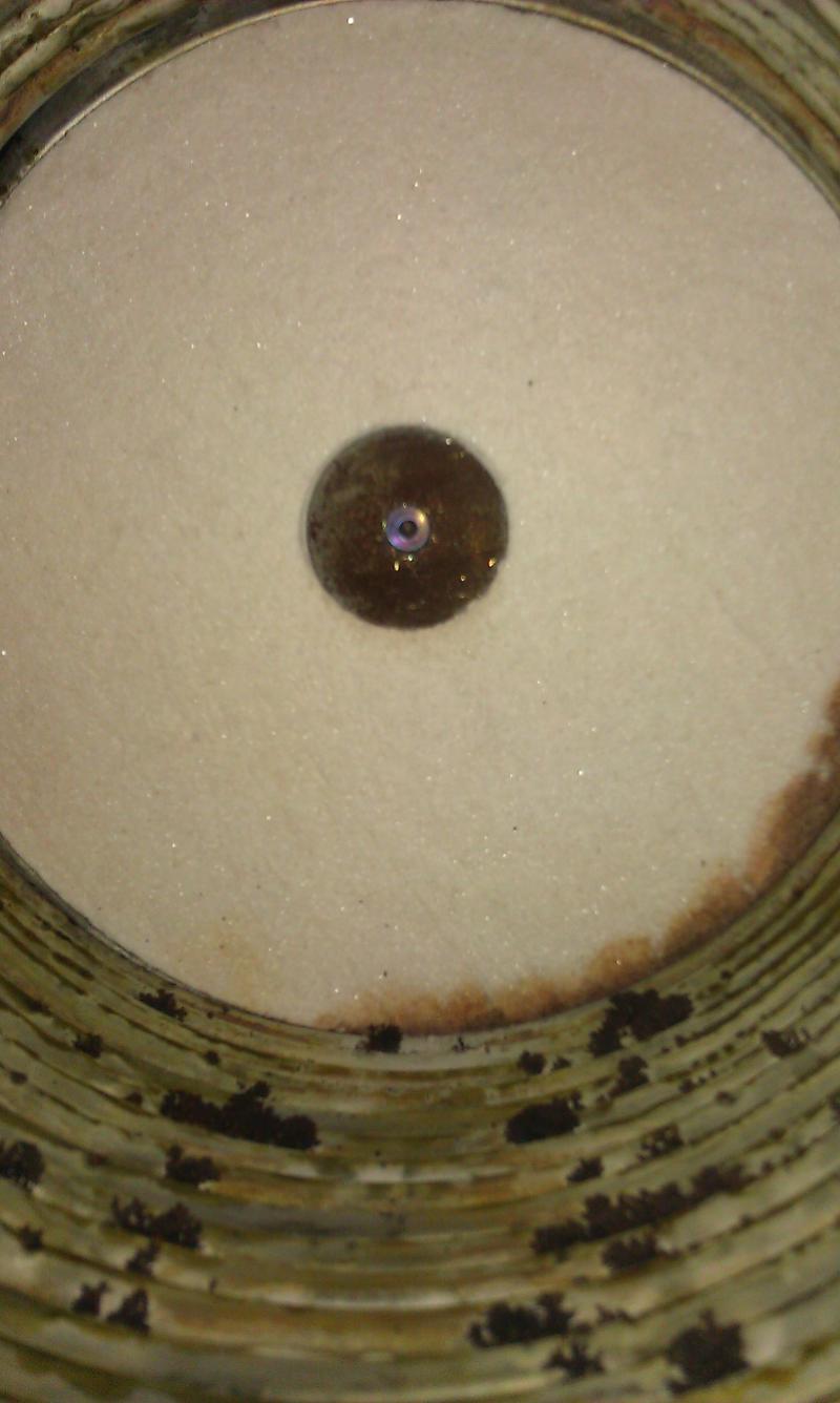

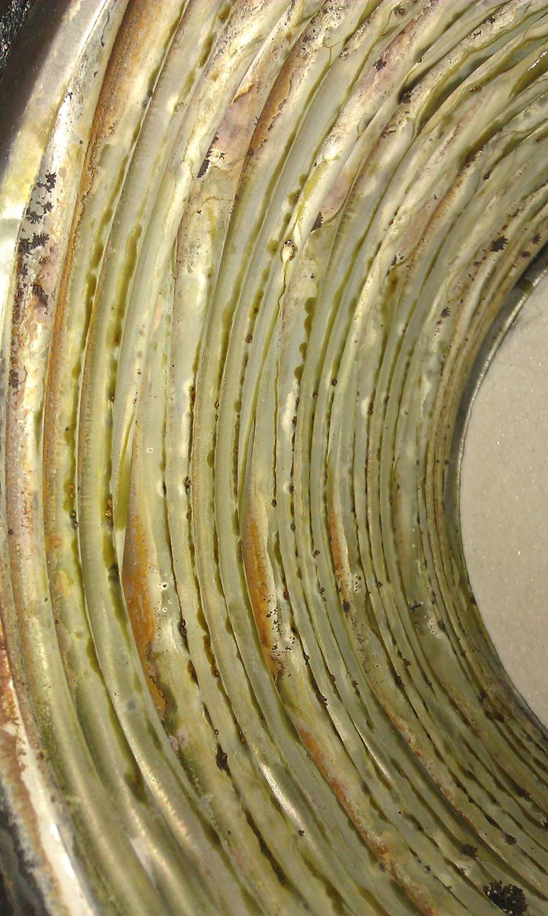

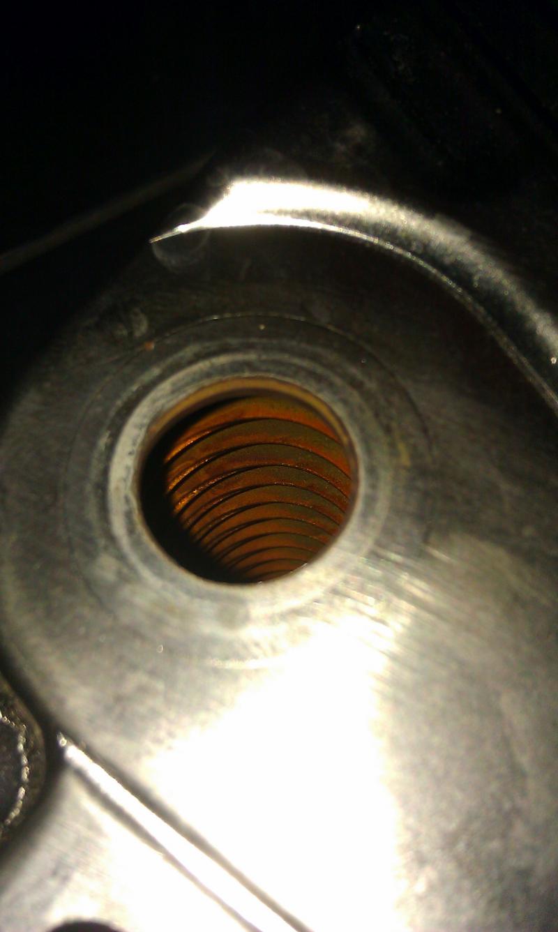

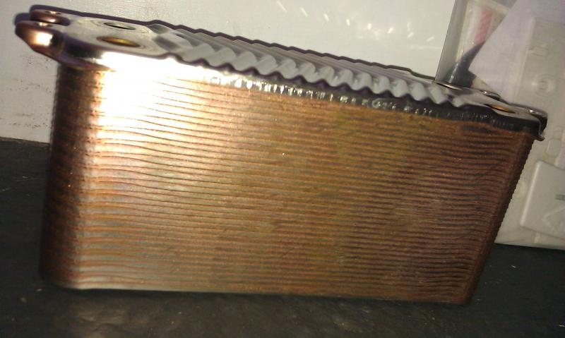

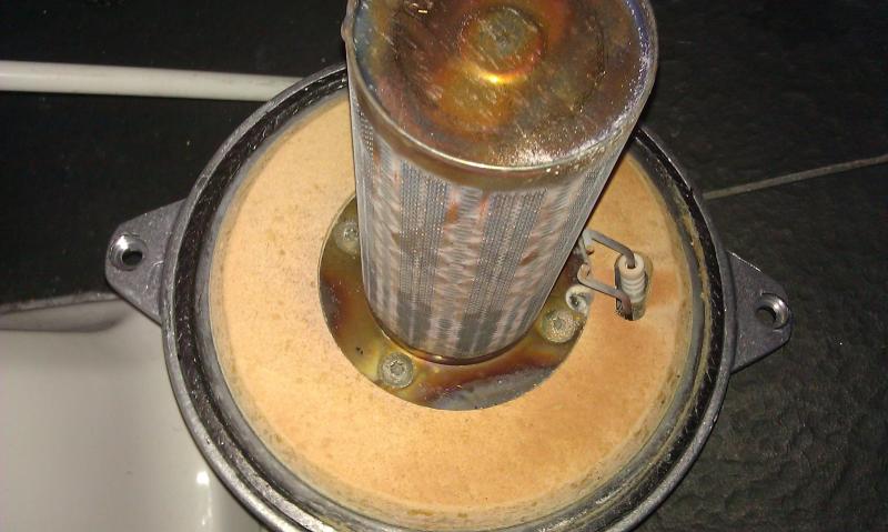

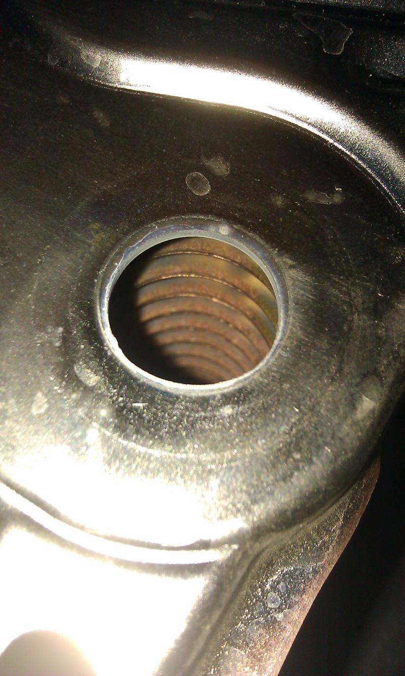

I've posted some photos below, and I'd be grateful for any further feedback on the basis of those and what I've added here. If I've been a mug, well...so be it; I'll try to take some comfort from the fact that at least we've got a brand new boiler with a 7-year warranty, and hot water again. Amazing how you take something like that for granted! (What he said about the house being warmer also seems to have been borne out; the boiler is running at 75 degrees instead of 84, and the radiators are chucking out the heat like never before.)
[/img]
I am glad that the system seems to be working better with a lower flow temperature.
But that would indicate to me that the flow through the heating system is better. Perhaps the old boiler just needed a new pump?
Those photos are of the combustion side of the main heat exchanger and not the water side where leak sealer/corrosion/dirt would occur.
Certainly the exchanger is dirty on the combustion side but that can be cleaned!
Perhaps others will come up with a better assessment of your problems but the above is mine. But there could be other issues that have not been mentioned here.
Tony
Thanks for your reply, Tony. We're out about £2,450 in total, for which he was here pretty much three whole days (and there was one other guy with him on one of the days).
