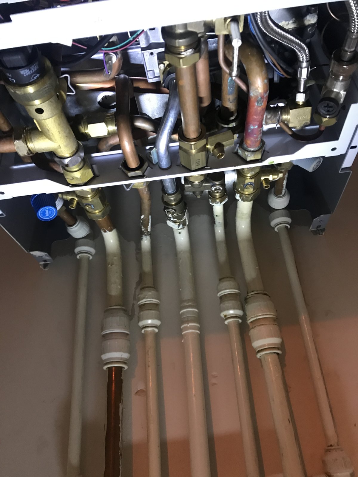

found the faq.
which is my best place to drain off the system as to get the right pressure in the vessel?
Use this drain attach a hose into a bucket and open the drain valve, when water stops attach a pump to the EV and start pumping lots more water will come out, when the water stops coming out keep pumping till about 1 Bar pressure in EV, remove pump close drain and re-pressurise water side of your boiler.
Thanks Ian.
So I’ve drained the expansion vessel, must have been 8litres in there, repressurised to 1bar and filled the cold loop to 1.5bar on the control unit gauge. Boiler back on and ran the hot tap. Pressure looks stable so far holding in the green at 1.5bar.
overflow pipe outside is still letting a little water - what else could now be causing this? The vessel is holding 1 bar, so I assume it’s only the PRV that maybe passing a little?

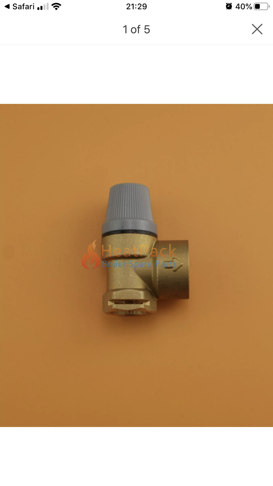

yes with a flat expansion vessel the PRV can be cruded up, it is possible to clean them, I do it all the time but they are not expensive so maybe best if you get a new one
Awesome thanks I’ll sort a new one and replace it if that’ll be the culprit for the leaking overflow
is the procedure similar to drain the boiler like I did for the PV and then just replace the unit? Assume it’s just this I need?
