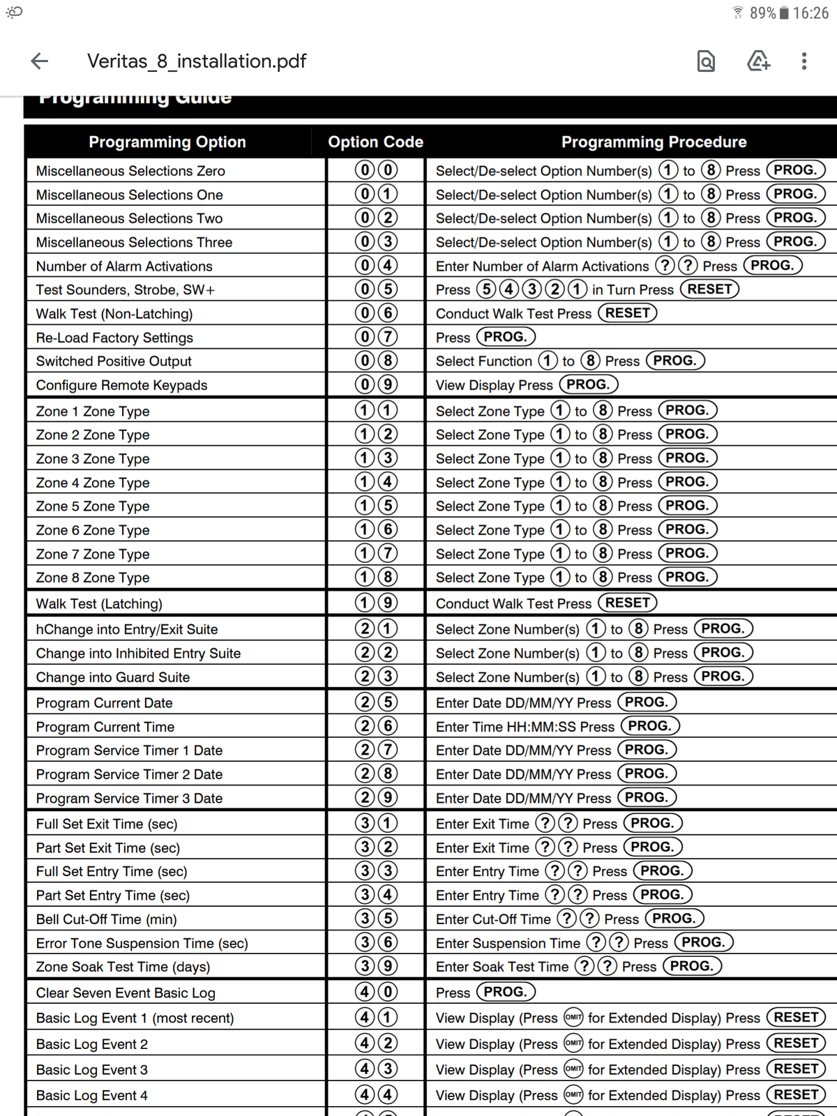

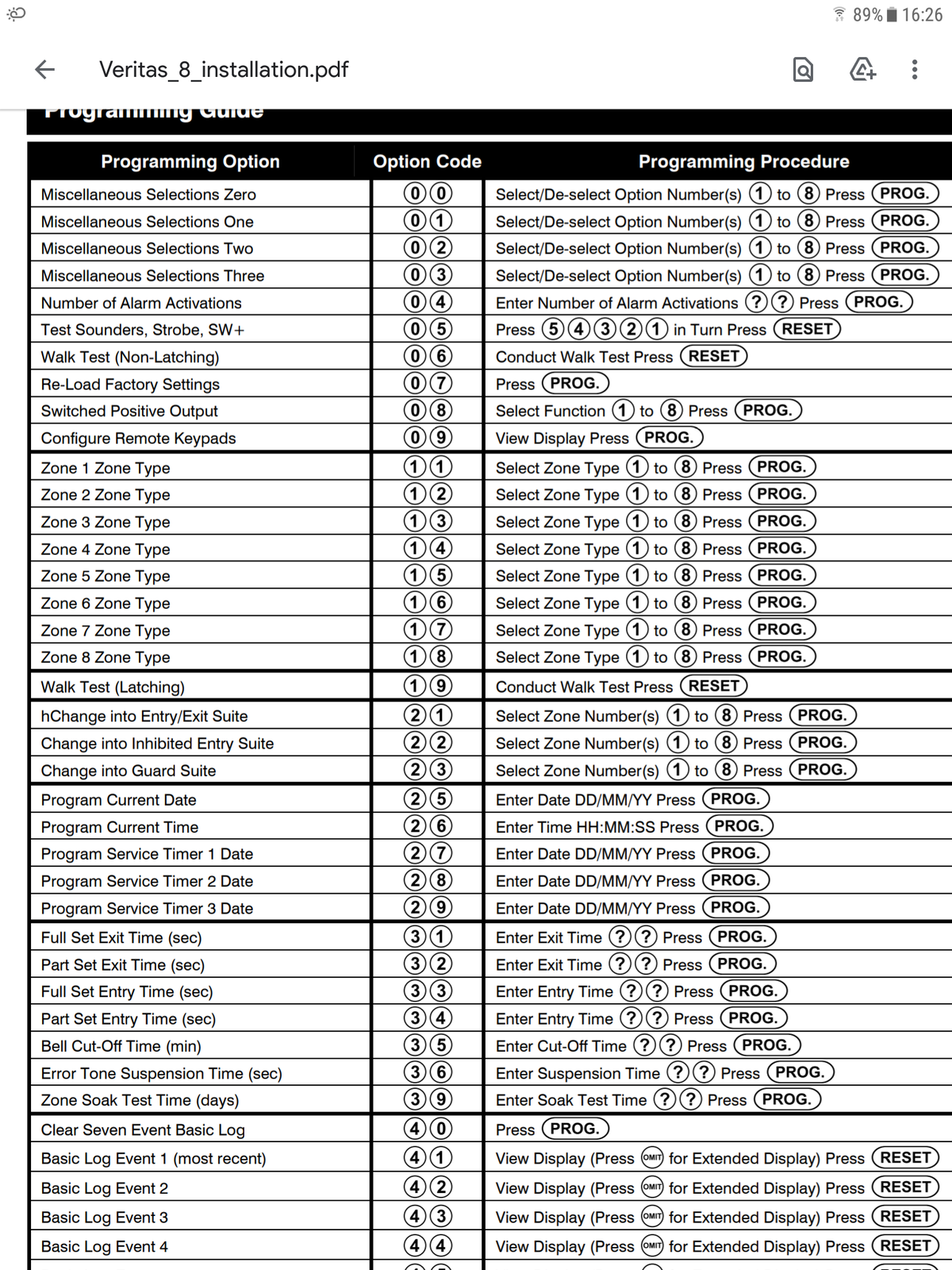

Veritas r8 two entry/exit?
If hallway is zone 1 then programming to make that zone an entry circuit will be 116 prog.
To make zone 7 (garage) entry exit will be 176 prog.
The quick start guide is self explanatory for each zone to be programmed.
