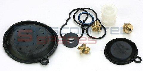

From service kit picture, looks like there are 5 parts to replace:
1xthin washer, 1xthick washer, 1xfigure 8 o-ring, 1xstuffing nut, 1xplastic diverter thingy

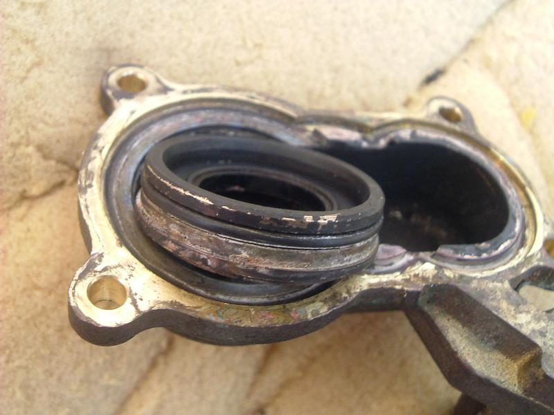

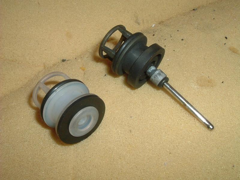

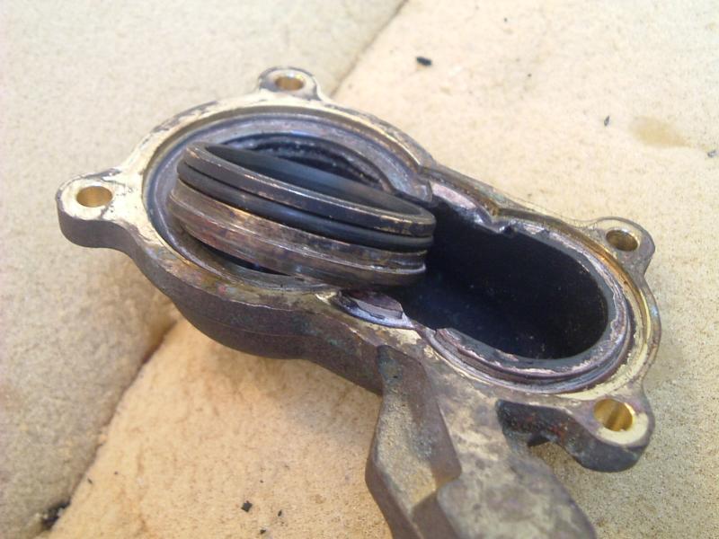

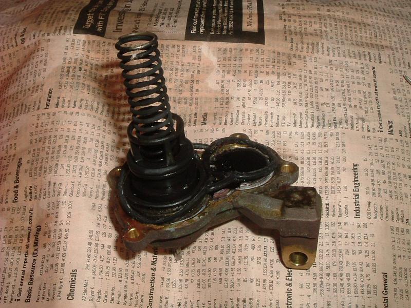

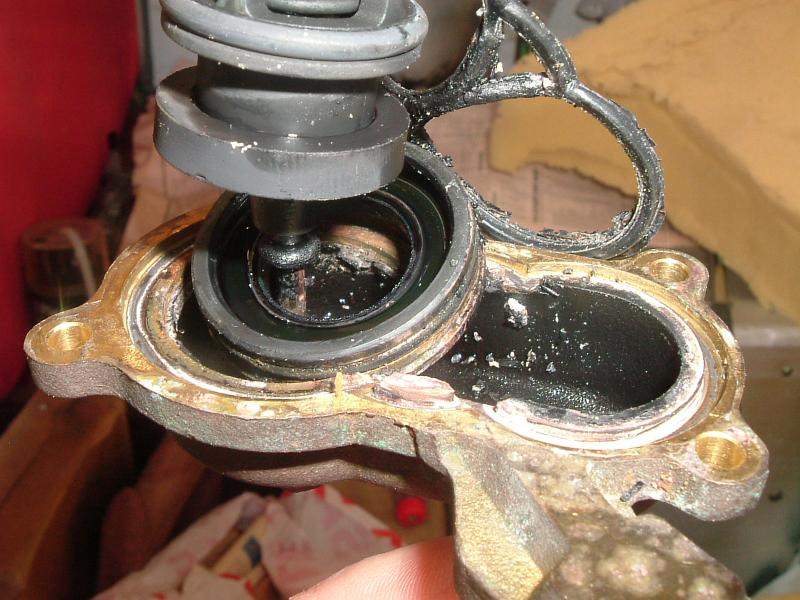

Took the Diverter Valve apart to replace parts from service kit.
Typical, that some things on mine (which uses old 4709416 -Excell 80SP (Old Hydraulics) )
looks slightly different to that in service kit.

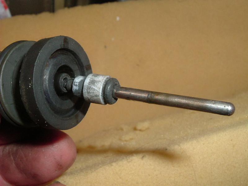

1) The pin doesn't seem to come away from my old plastic diverter.
Does it click into place ?
Do you need to force it out ?
How do I remove the pin, as it doesn't seem to come out easily ??
2) My old plastic diverter (black one in pictures) is slightly different to service kit replacement & uses different washer.
The old washer next to the pin is thicker, has internal groove which slips over the lip on plastic diverter.
Whereas new plastic diverter (white one in pictures) uses flat thin washer which pushes on & sits in front.
(see pictures)
3) There seems to be an O-ring on a metal insert, which the plastic diverter sits in.
(see pictures)
There isn't one of these O-rings in the service kit.
I assume I need to change this O-ring, as it seems to provide additional seal to the figure 8 O-ring.
The only seal which seems to have seriously deteriorated is the figure 8 O-ring, which was brittle & breaking up. The other o-rings are still flexible & not breaking up.
As this O-ring is missing from service kit, should I just buy similiar O-ring to replace it ??
Service kit parts:
Is this post for real ????????????????? how long has it been going on ?? how many qualified engineers have correctly told you what is wrong and how to repair the fault ????? rant over
