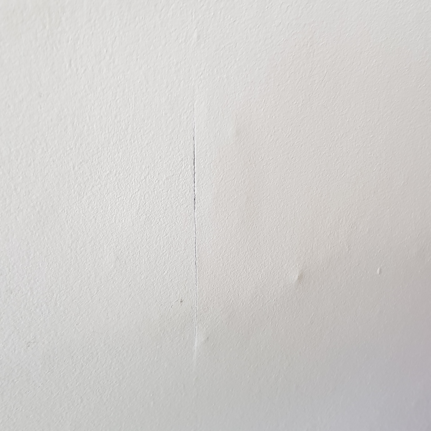

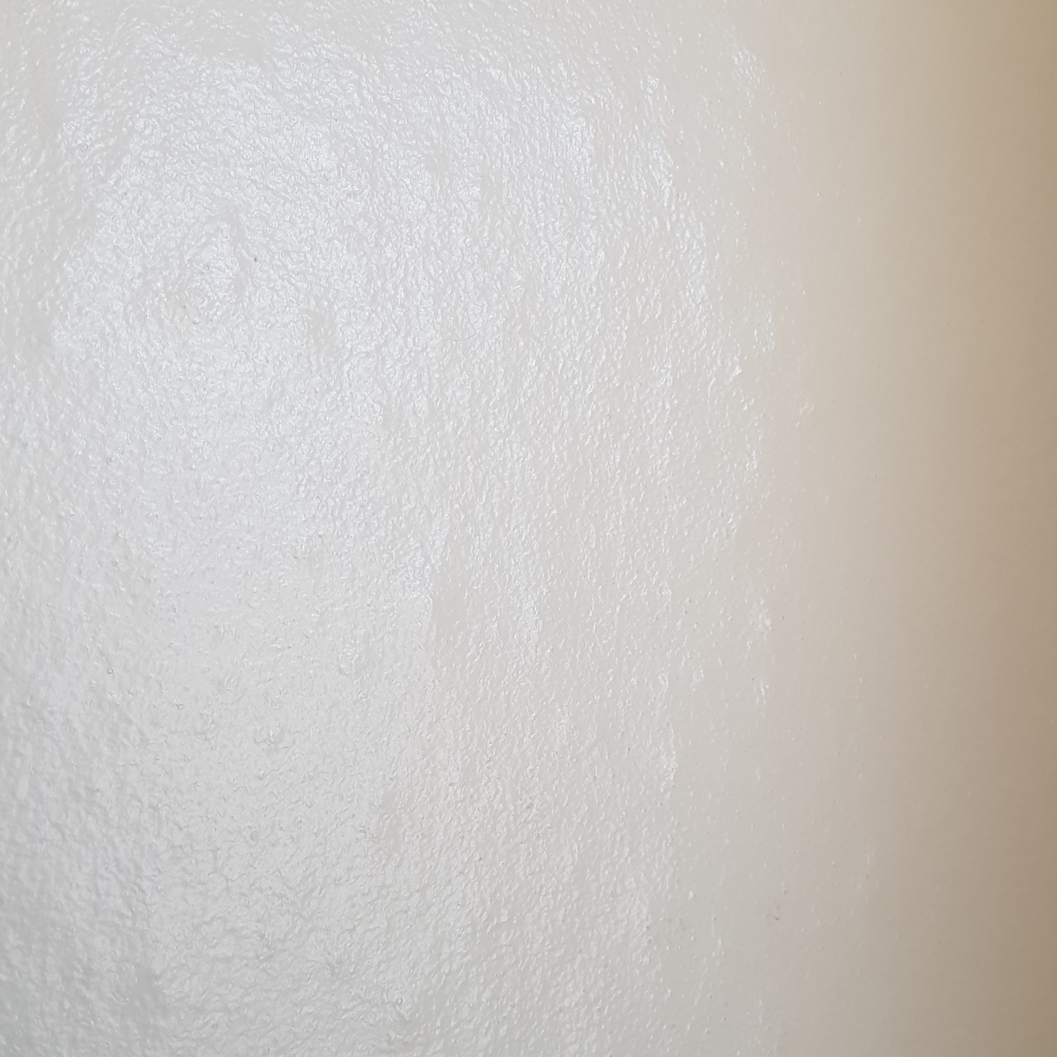

Hi All,
Newbie DIY and trying to keep busy during lockdown.
I am looking to refresh the paint on the wall and believe that the wall have some paper on the wall which have been painting on – maybe just some special paper as when you drill, it get very dusty / powder when I put on the wall picture frame in the past. Is that dry wall am I correct?
So when looking to refresh the paint – am I safe to paint over the existing paint?

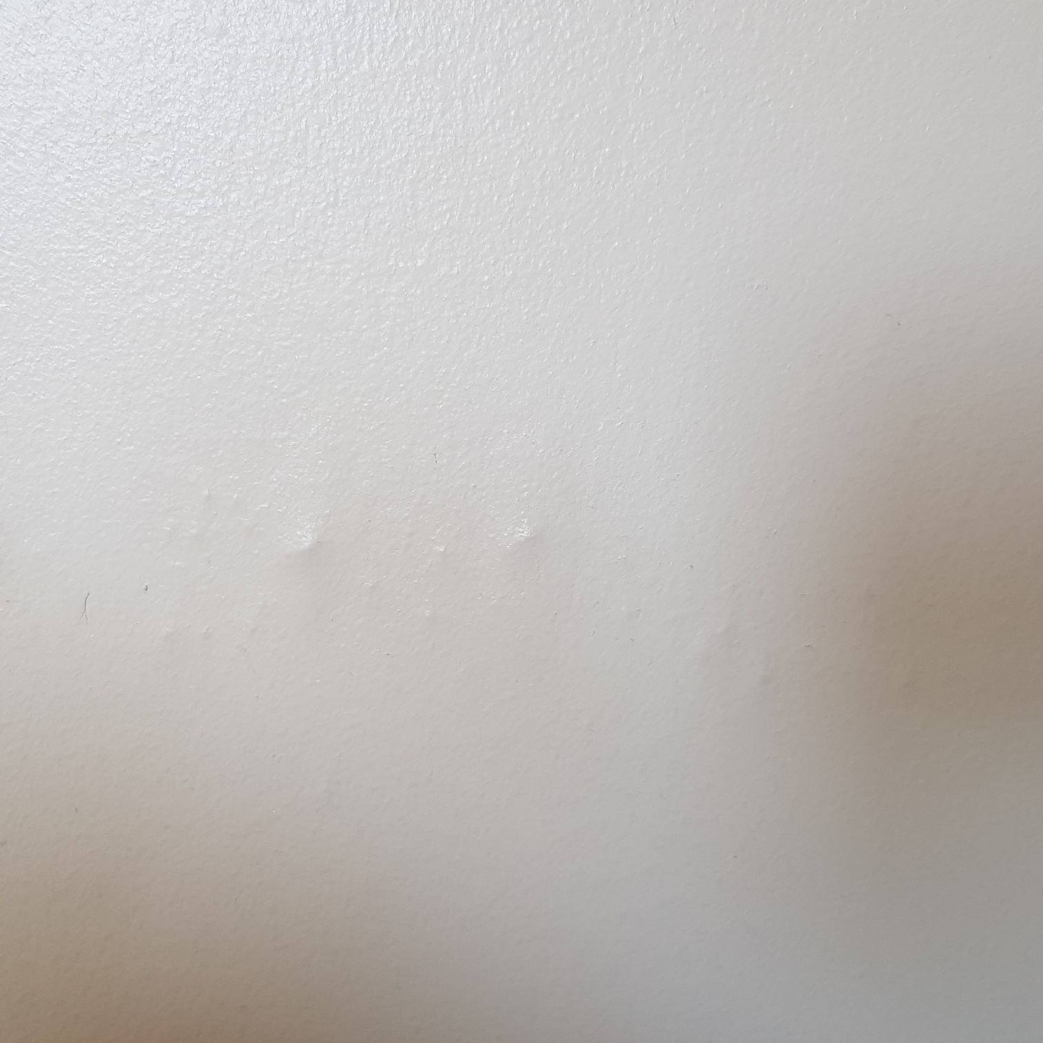

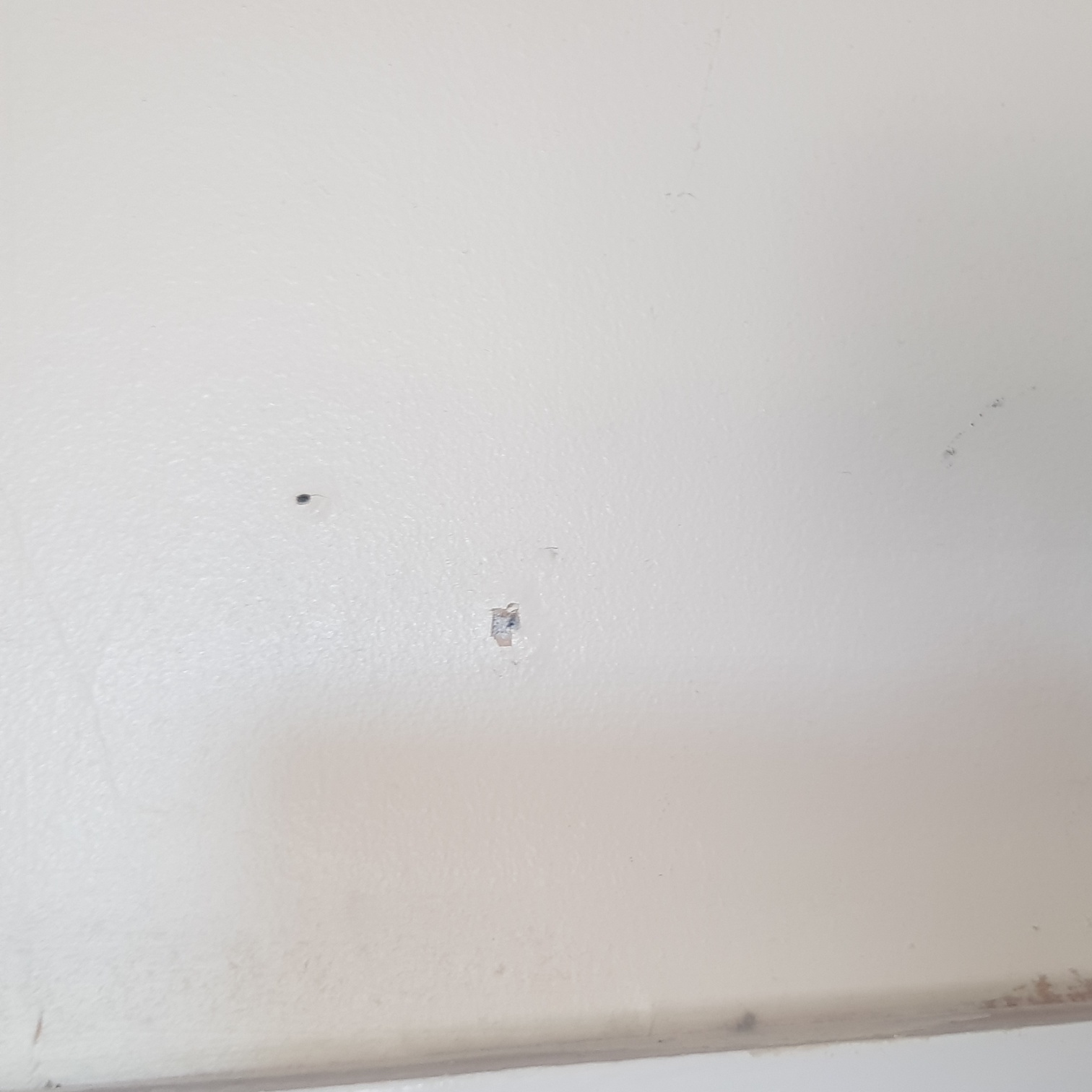

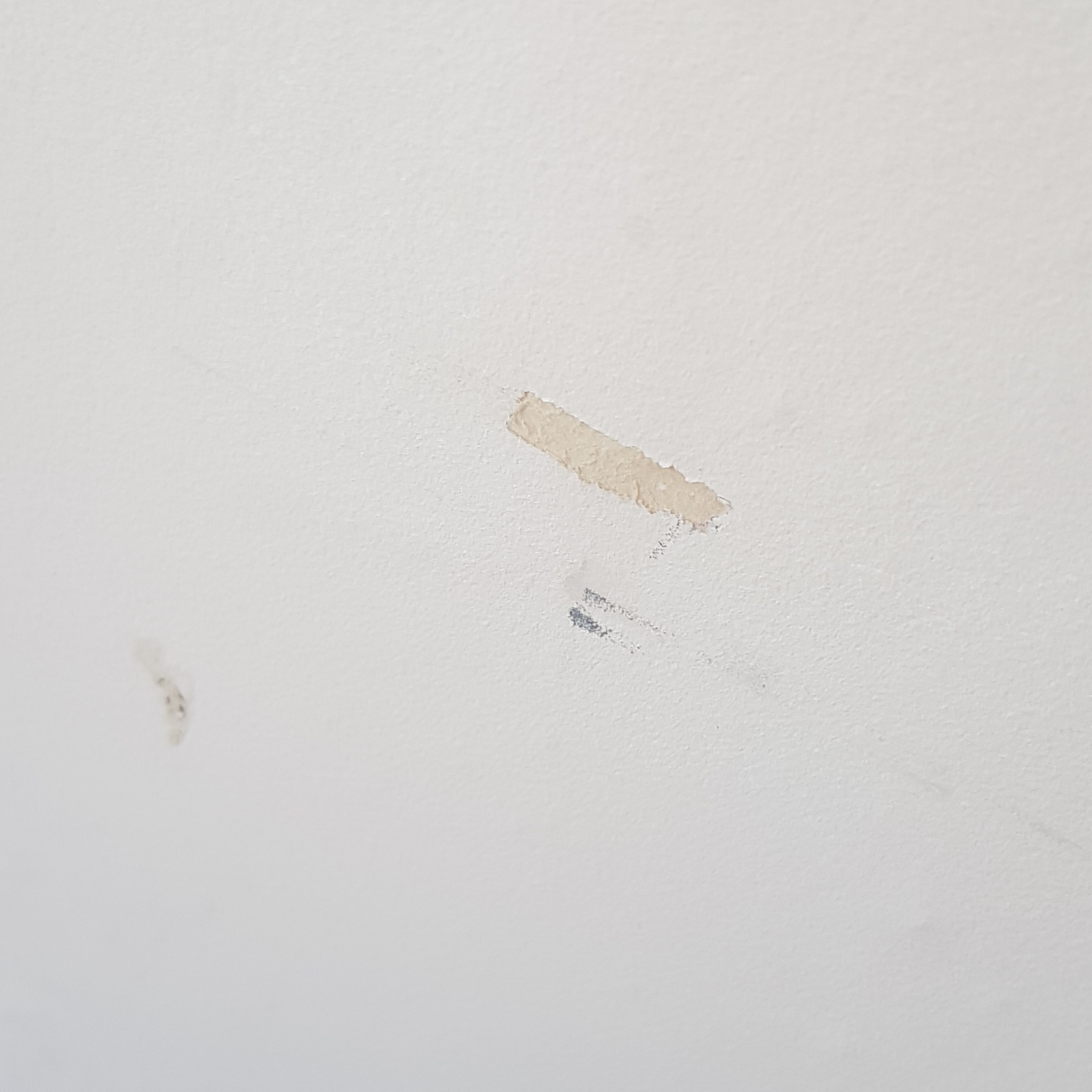

What should I do with the bump – can I sand them and add some filler?

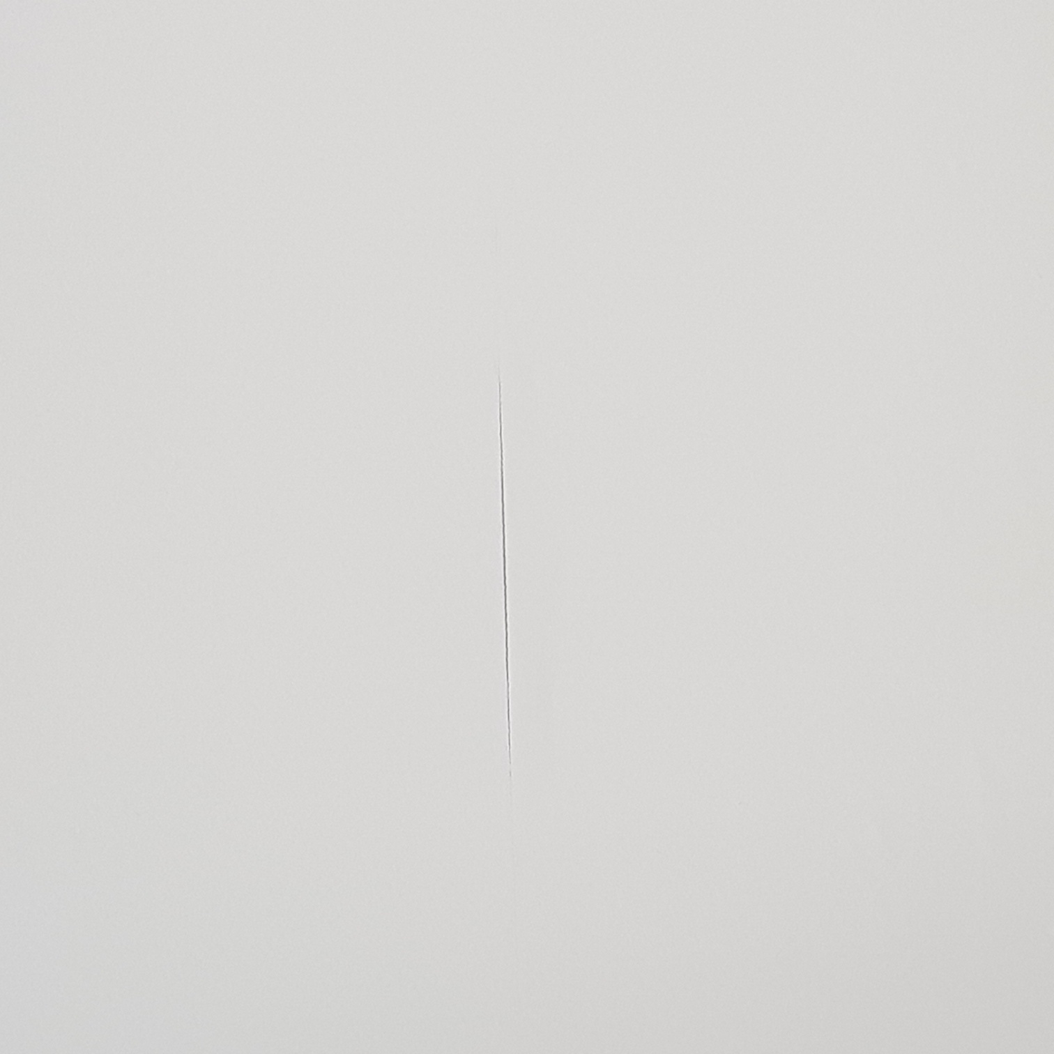

And what about when the paper between two sheet have started to undo itself? Can I just put some wallpaper glue to fix that?

It looks like lining paper.
Lining paper is used to hide dodgy walls and give you a nice smooth wall to paint on.
However in your case it has not been done well at all and you can still see the dodgy wall underneath and it looks like the paint has been applied far too thickly
I would recommend you strip it off and start again however if you don't fancy doing that , you can sand lining paper and powder filler can be used to fill in any holes and sanded back flush.
You are safe to paint over existing paint just give the walls a wash so the paint sticks and apply at least two coats , make sure your edges are neat and if you accidentally get paint where you don't want it wipe it off straightaway
Keeping things neat means you get a more professional finish rather than looking like you have just slapped it on without a care in the world
