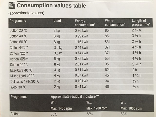

Recently bought a Neff washing machine.
Actually decided to read the manual for once... and this sheet fell out regarding energy/water usage.
Looking at the attachment, the first line is for cotton 20°C, energy consumption is stated as 0.26kWh. Length of programme is 2.75 hours.
Does this indicate that it’s .26kWh x 2.75 hours?
I. E. .715kWh total?

No. You are confusing kW (power) with kWh (energy, i.e power x time). Note that 1kWh = 1kW for 1 hour.

Watt, not watt per hour. Watt and kW are already units of power. So kW x hour (kWh) is a unit of energy. 0.26kWh is 260 watt for 1 hour (or 520 watt for 30 mins, etc)

my washer uses negligible power during churn and spin.
The only significant cost is from the heater.
60C Hot cotton wash 2.5kW for about 12 minutes
0.5kWh
costs me about 8p at current tariff
cooler washes use less heat, as do more modern low-water content washers. It looks like mine uses around 10 litres.
Your 20C "cotton wash" is almost cold.
I don't entirely understand your table but it looks like it also shows energy usage with hot water supply, which is much less and can be worthwhile if the machine has a short pipe run to the hot cylinder heated by a gas boiler or solar.
