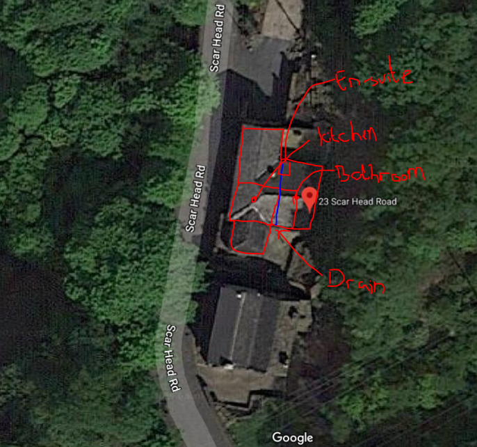

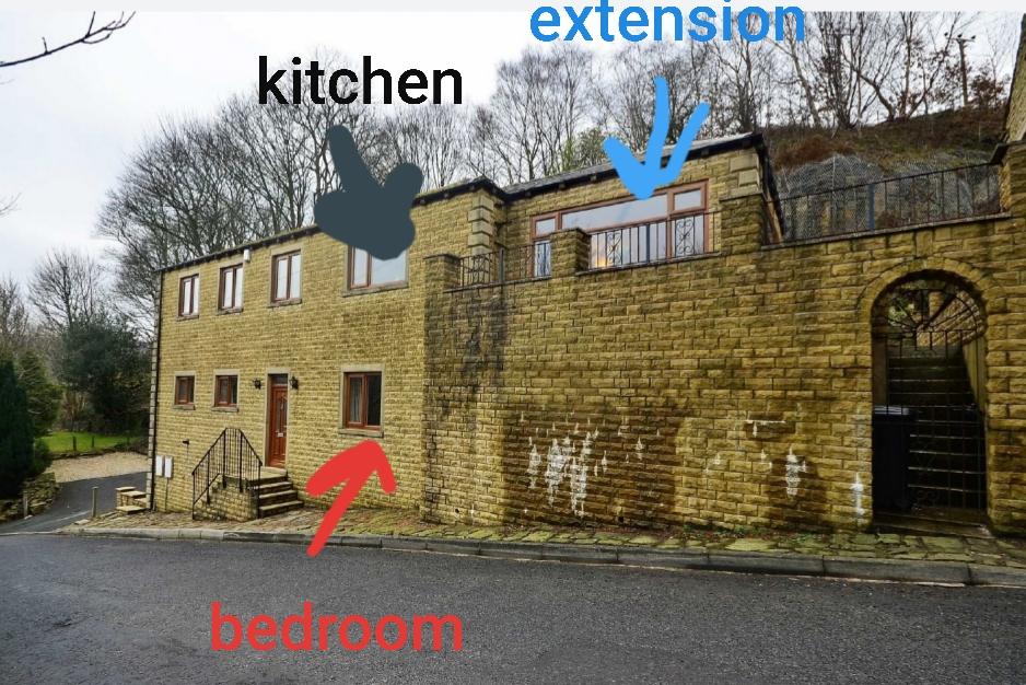

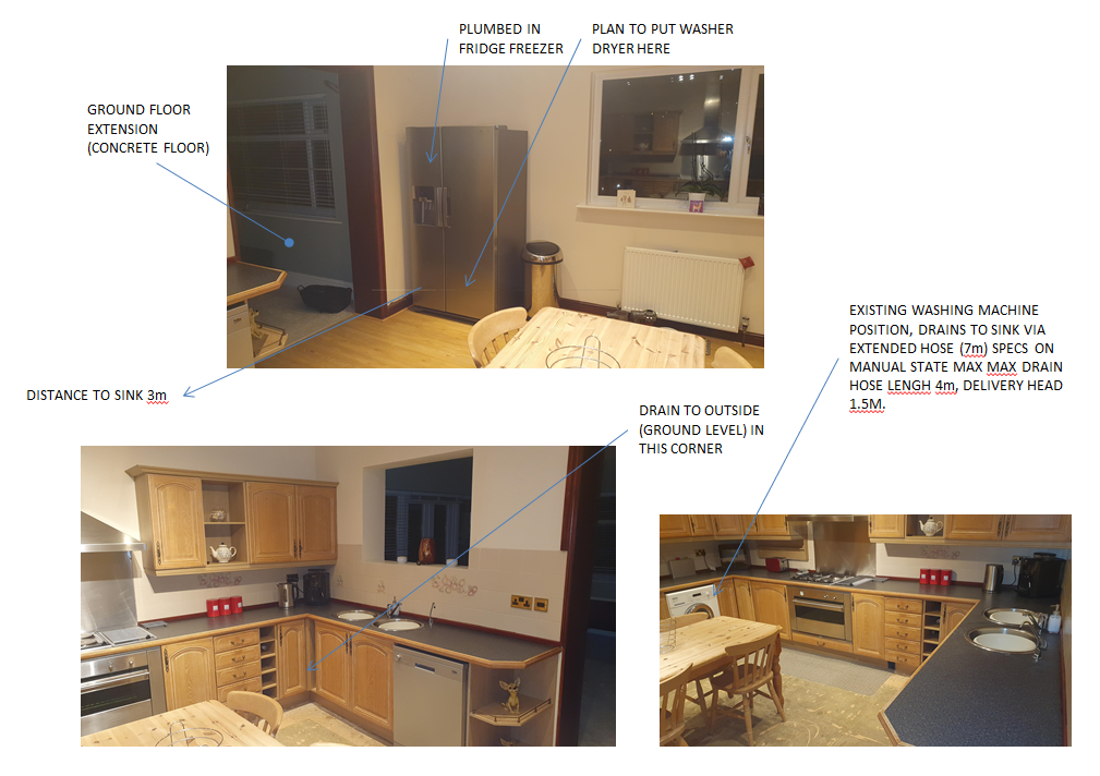

Going to do the kitchen out (upstairs kitchen, bedroom underneath) and it would really make sense to position the washer and dryer on the other side of a doorway (that can't be moved). However this would block off the path to the sink / external drain.
The joists run in the correct direction so that it would be very easy to lift the floor boards and drop the hose just underneath, then back to the sink (only 2 meters away), a much shorter path than it is currently is, and in reality only 2" lower.
I just can't help but think I'm going to regret it in the future. I was thinking of doing with solvent weld pipe, not a flexi hose, but a sealed path to the sink.
Just can't quite convince myself it's not a really bad idea so would love to hear peoples thoughts.
